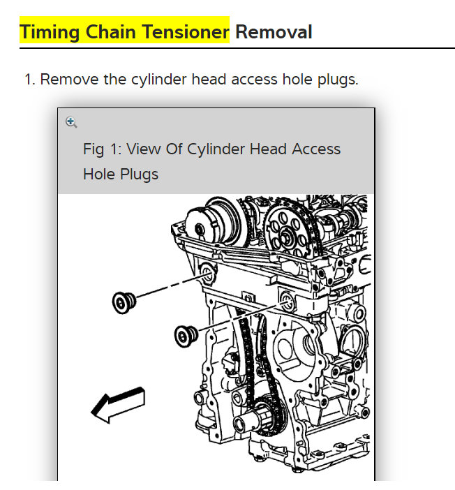

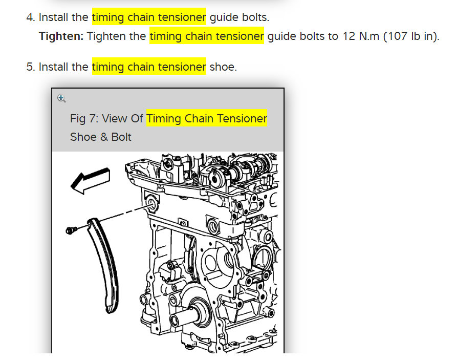

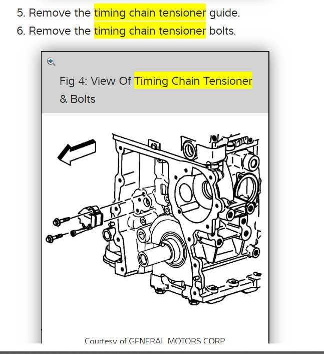

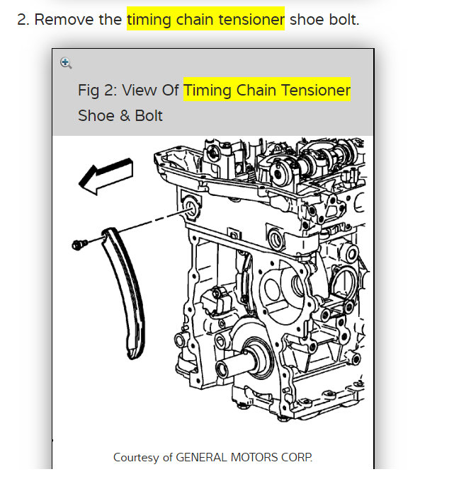

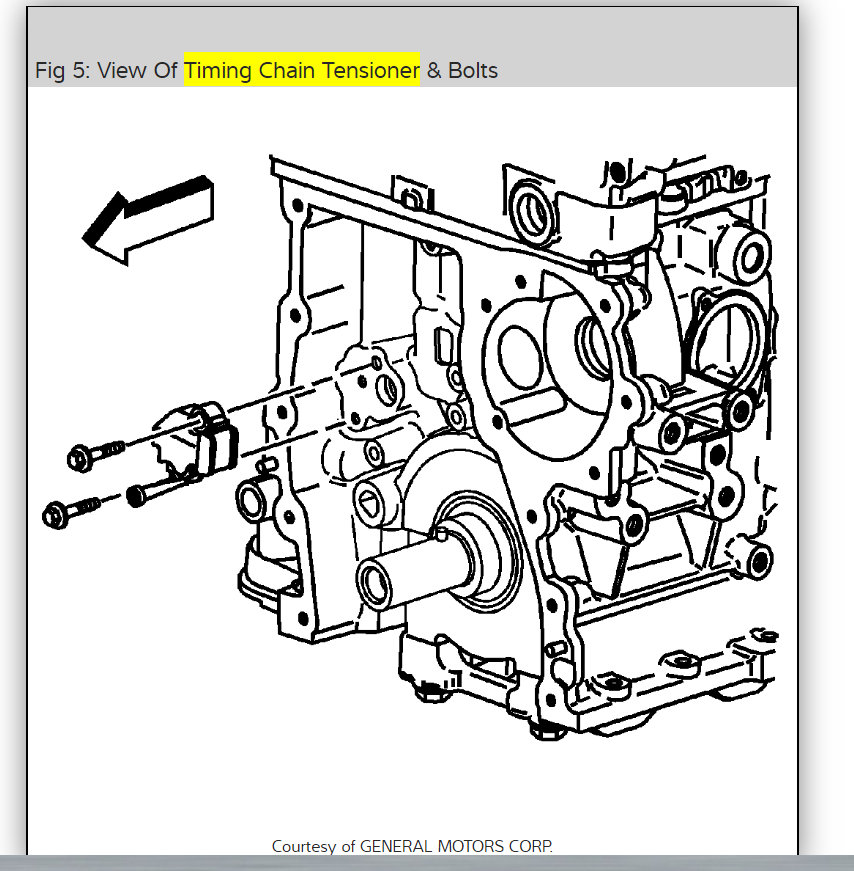

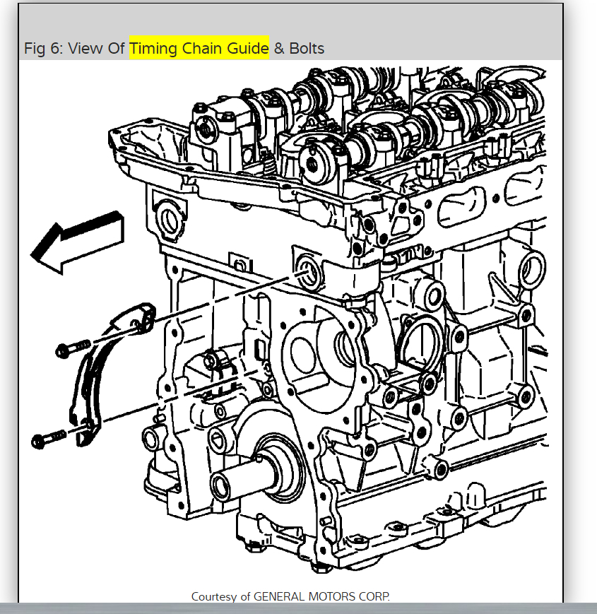

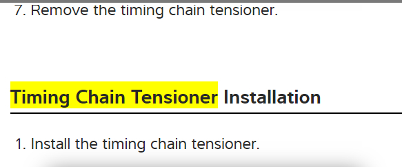

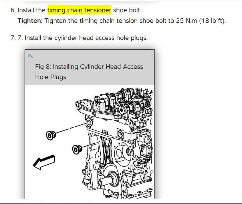

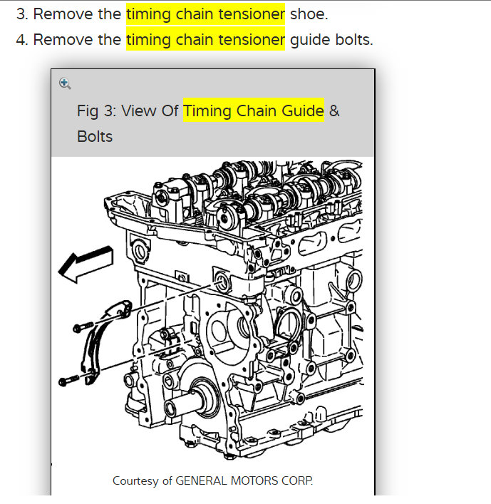

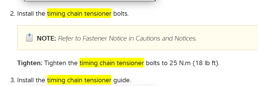

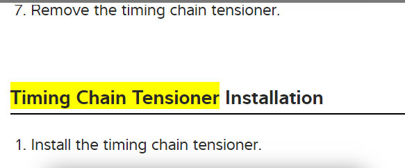

This could be a problem with your timing chain or the timing chain tensioners. In the diagrams down below i have included a guide on how to check and remove and install the timing chain tensioners. Please go through this guide and get back to us with what you are able to find out.
Thanks,
Alex
