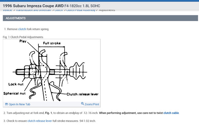

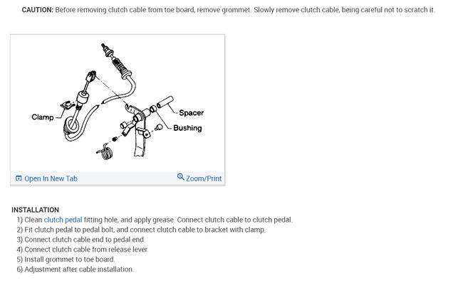

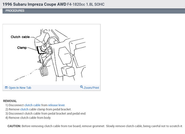

Is there free pedal at the top of the pedal travel? Can you shoot me a short video of the problem so I can see what's going on? You can upload it in your response. Here are the instructions on how to replace and adjust it in case we miss something. The only other thing I can think of is the clutch throw out bearing or clutch disc has come apart. Here is a video that can help as well, please check out the images below for more information.

Check out the images (below). Let us know what happens and please upload pictures or videos of the problem.
