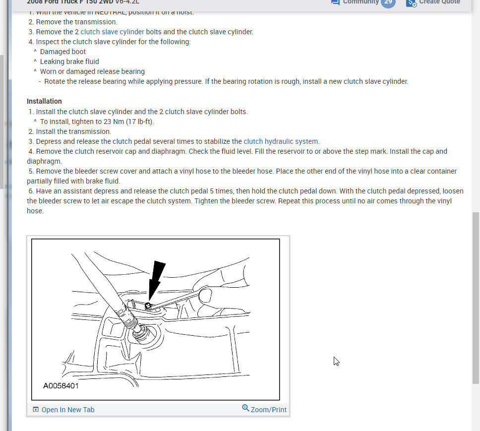

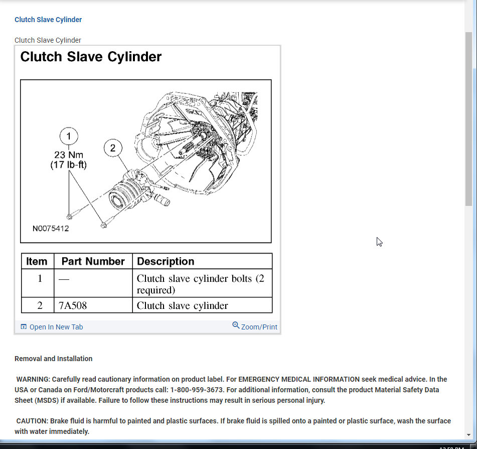

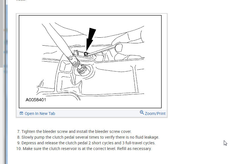

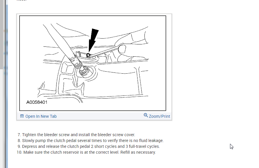

Run through this material and let us know if you have other questions. Also, I attached the info from the manual on the slave cylinder. I would recommend inspecting the friction disc and make sure that it is not contaminated with fluid. It will need to be replaced if it is.
Check out the diagrams (Below). Let us know what happens and please upload pictures or videos of the problem.
