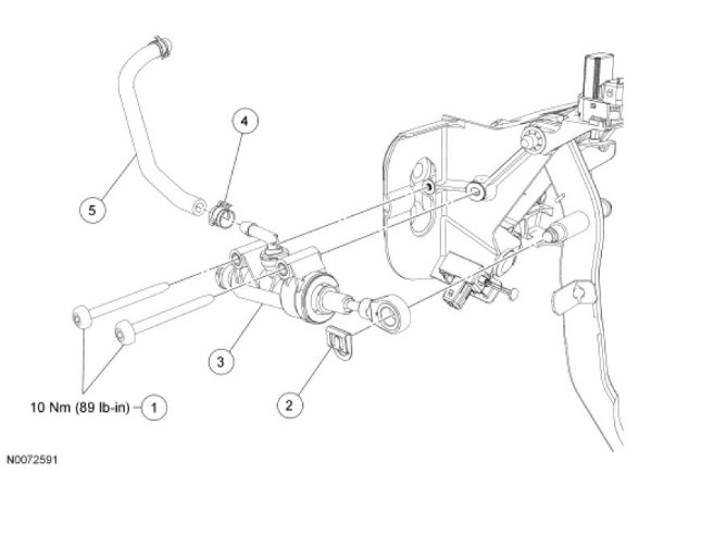

Clutch master replacement instructions:
Remove the brake pedal and bracket assembly. For additional information, refer to Hydraulic System, Brakes and/or Brake Pedal Assembly.
Remove the retaining clip from the clutch pedal pin.
Remove the two clutch master cylinder bolts, then disconnect the clutch master cylinder from the clutch pedal.
To install, tighten to 10 Nm (89 lb-in).
Remove the reservoir hose from the clutch master cylinder.
Best, Ken
