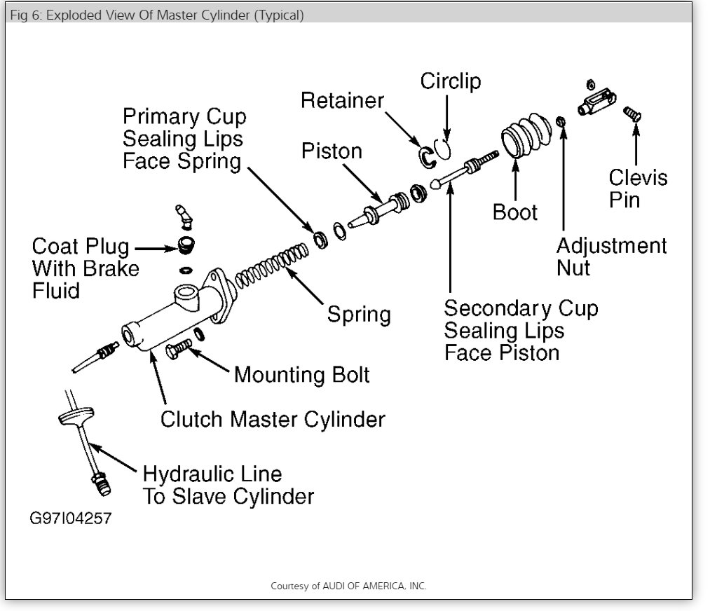

No problem. It sounds like you are missing something like a sealing washer or something. Can you upload pictures so I can see what you are talking about?

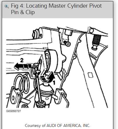

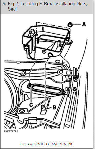

Here are some diagrams from the manual you can see there is an extra O ring it looks like (below)
