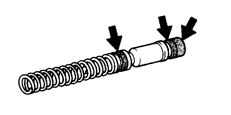

REMOVAL
pic 2

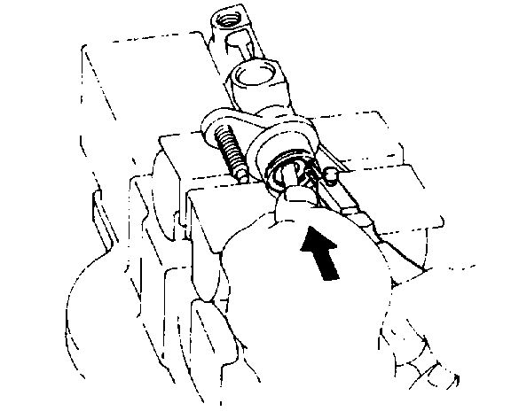

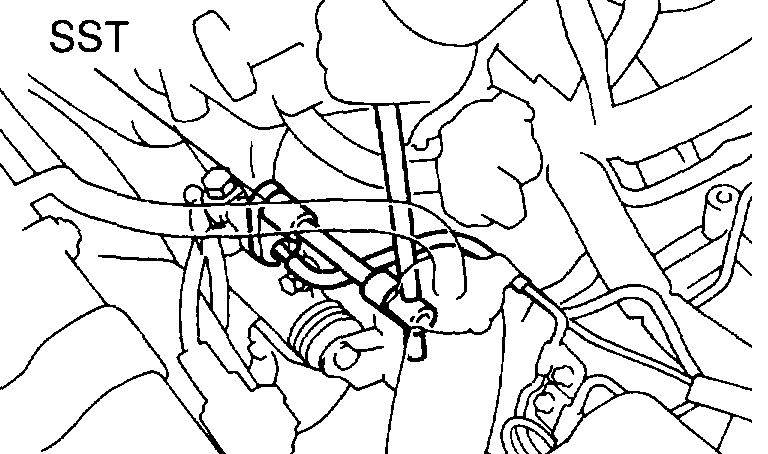

1. DISCONNECT CLUTCH LINE
a. Using SST, disconnect the clutch line.
SST 09023-00100
b. Use a container to catch the fluid.
2. REMOVE 2 BOLTS AND PULL OUT RELEASE CYLINDER

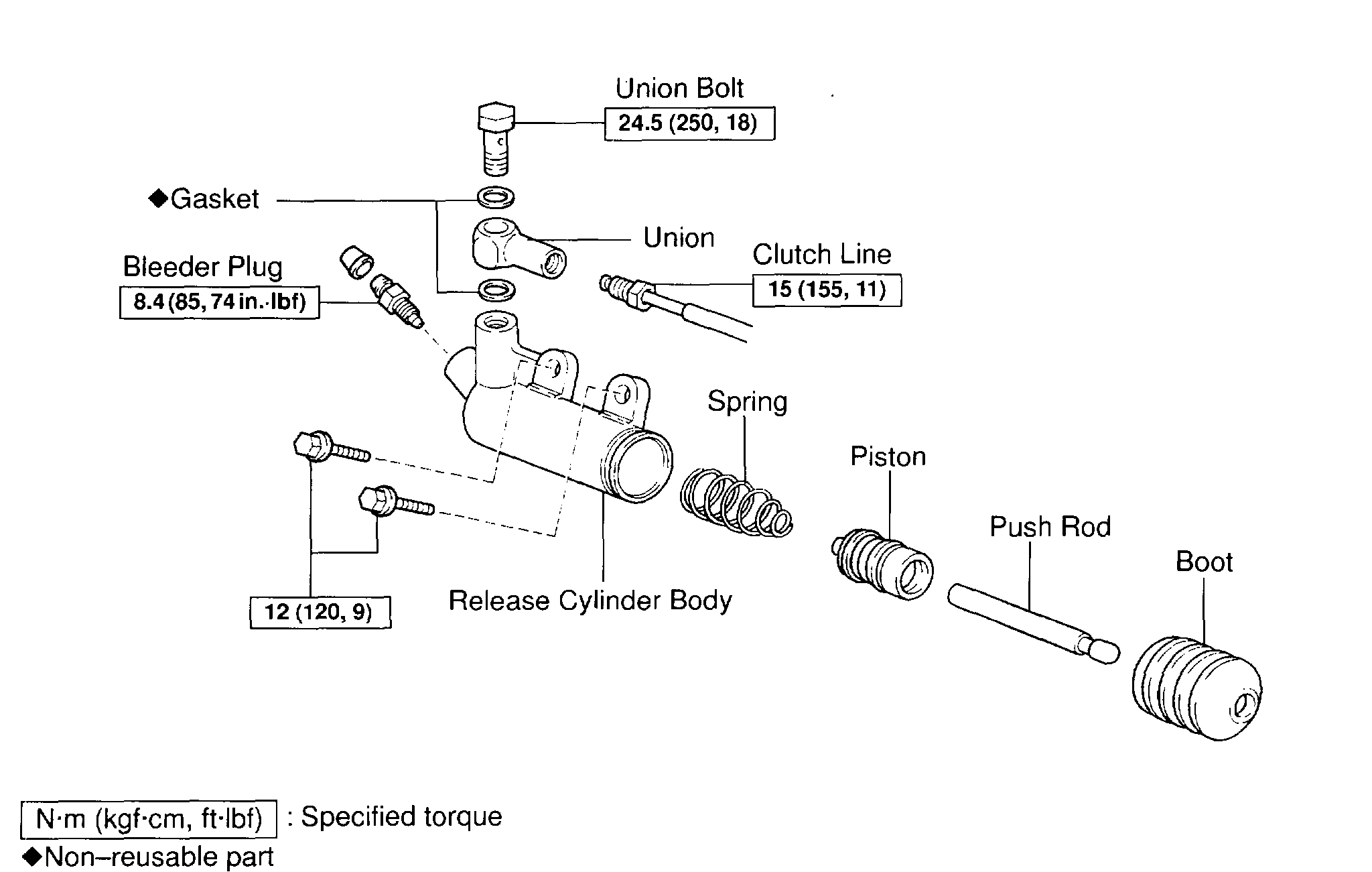

DISASSEMBLY
1. REMOVE BLEEDER PLUG
2. REMOVE UNION BOLT, 2 GASKETS AND UNION
3. PULL OUT BOOT WITH PUSH ROD
pic 3

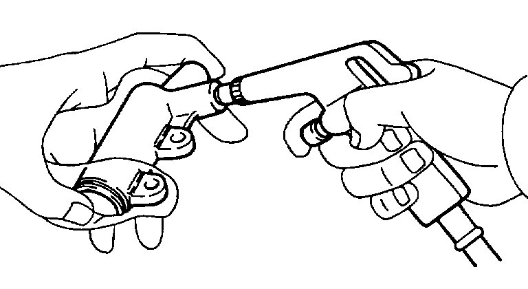

4. REMOVE PISTON
Using compressed air, remove the piston and the spring from the cylinder.

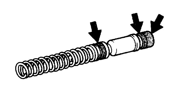

REASSEMBLY
pic 4
1. COAT PISTON WITH LITHIUM SOAP BASE GLYCOL GREASE, AS SHOWN
2. INSTALL PISTON WITH SPRING INTO CYLINDER
3. INSTALL BOOT WITH PUSH ROD TO CYLINDER
4. INSTALL UNION 2 GASKETS AND UNION BOLT
Torque: 24.5 Nm (250 kgf-cm, 18 ft. lbs.)
5. INSTALL BLEEDER PLUG
Torque: 8.4 Nm (85 kgf-cm, 74 inch lbs.)

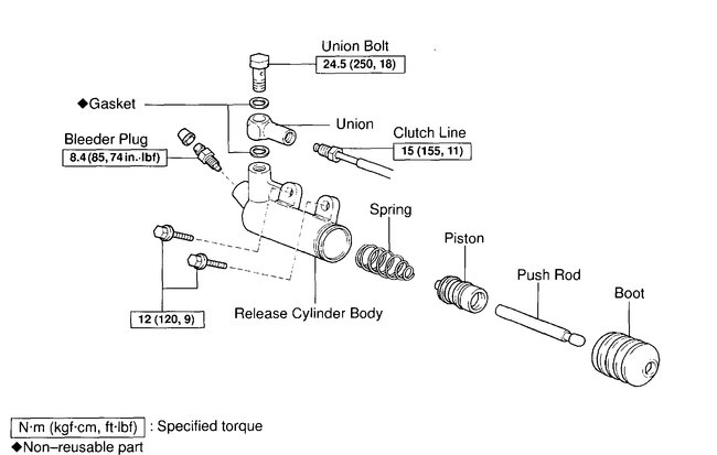

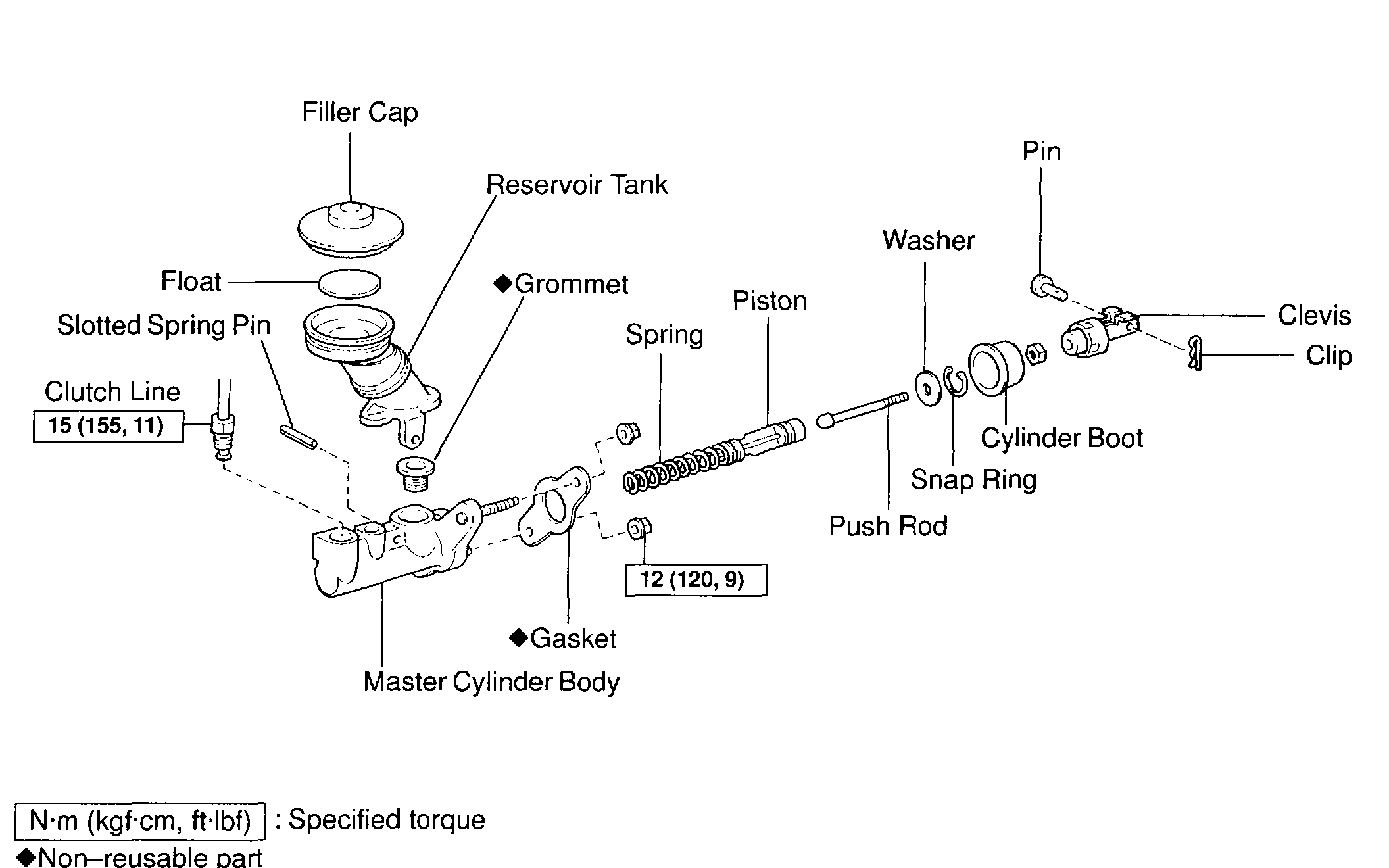

INSTALLATION
1. INSTALL RELEASE CYLINDER AND 2 BOLTS
Torque: 12 Nm (120 kgf-cm, 9 ft. lbs.)
pic 5
2. CONNECT CLUTCH LINE
Using SST, connect the clutch line.
SST 09023-00100
Torque: 15 Nm (155 kgf-cm, 11 ft. lbs.)
3. FILL CLUTCH RESERVOIR WITH BRAKE FLUID AND BLEED CLUTCH SYSTEM
4. CHECK FOR LEAKS

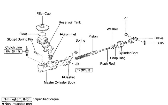

Here are the directions for the clutch master cylinder. When checking for leaks, also check under the dash where the clutch pedal attaches to the push rod.
___________________________________
1999 Toyota Corolla CE Sedan L4-1.8L (1ZZ-FE)
Procedures
Vehicle Transmission and Drivetrain Clutch Clutch Hydraulic System Clutch Master Cylinder Service and Repair Procedures
PROCEDURES
pic 5
REMOVAL
1. REMOVE BRAKE BOOSTER
2. DRAW OUT FLUID WITH SYRINGE

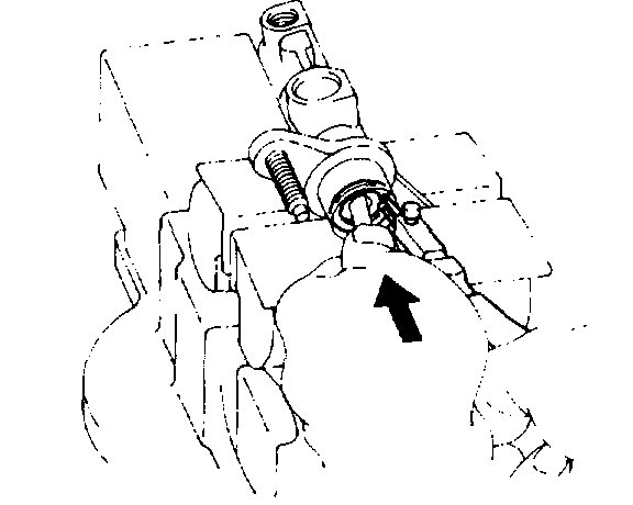

pic 6

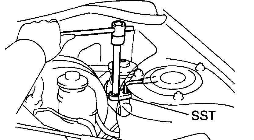

3. DISCONNECT CLUTCH LINE
SST 09023-00100
4. REMOVE LOWER FINISH PANEL AND LOWER INSERT
5. REMOVE NO. 2 HEATER TO REGISTER DUCT
6. REMOVE CLIP AND PIN
7. REMOVE 2 MOUNTING NUTS AND PULL OUT MASTER CYLINDER
8. REMOVE GASKET FROM MASTER CYLINDER
DISASSEMBLY
1. REMOVE CLEVIS AND BOOT
a. Loosen the lock nut to remove the clevis and remove the lock nut.
b. Remove the boot.
pic 7

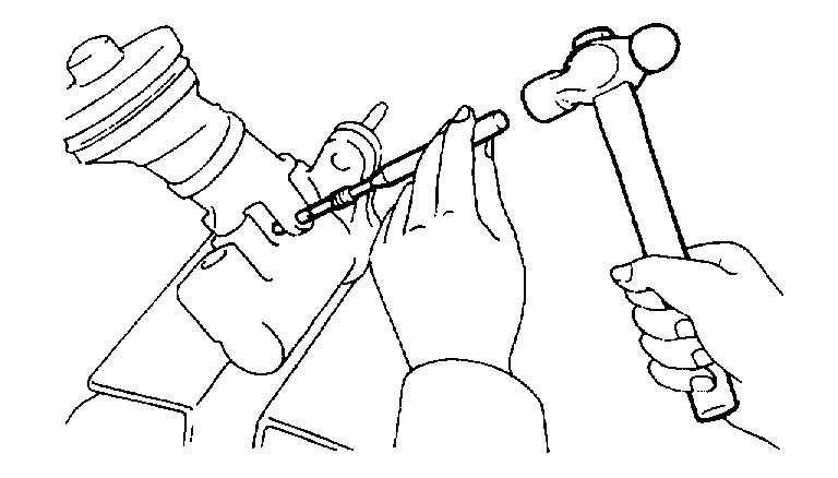

2. REMOVE RESERVOIR TANK
a. Using a pin punch and hammer, drive out the slotted spring pin.
b. Remove the reservoir tank and grommet.
pic 8
3. REMOVE PUSH ROD
a. While pushing the push rod, using snap ring pliers remove the snap ring.
b. Remove the push rod and washer.
4. REMOVE PISTON
REASSEMBLY
pic 9

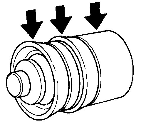

1. COAT PARTS WITH LITHIUM SOAP BASE GLYCOL GREASE, AS SHOWN
2. INSERT PISTON INTO CYLINDER
pic 10
3. INSTALL PUSH ROD ASSEMBLY WITH NEW GASKET AND NEW WASHER
a. Install the washer to the push rod
b. Push the push rod to the piston, using snap ring pliers, install the snap ring.
c. Install the boot.
4. INSTALL RESERVOIR TANK
a. Install the reservoir tank and a new grommet.
b. Using a pin punch and hammer, drive in the slotted spring pin.
INSTALLATION
1. INSTALL NEW GASKET TO MASTER CYLINDER
2. INSTALL MASTER CYLINDER AND 2 MOUNTING NUTS
3. INSTALL PIN AND CLIP
4. INSTALL NO. 2 NEATER TO REGISTER DUCT
5. INSTALL LOWER INSERT AND LOWER FINISH PANEL
pic 11
6. CONNECT CLUTCH LINE
SST 09023-00100
7. FILL CLUTCH RESERVOIR WITH BRAKE FLUID AND BLEED CLUTCH SYSTEM
8. INSTALL BRAKE BOOSTER
9. ADJUST CLUTCH PEDAL. Refer to Clutch Pedal Assembly; Service and Repair.
10. CHECK FOR LEAKS
