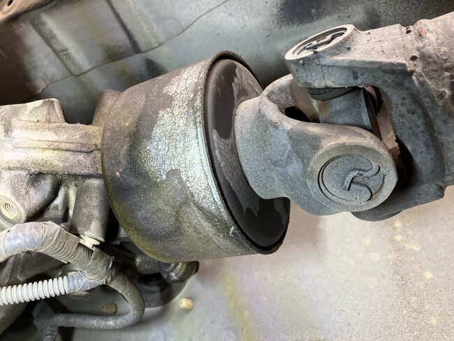

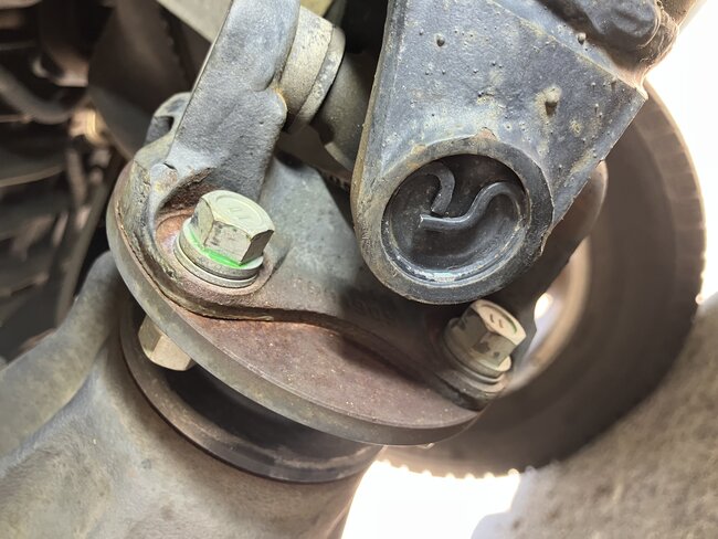

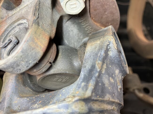

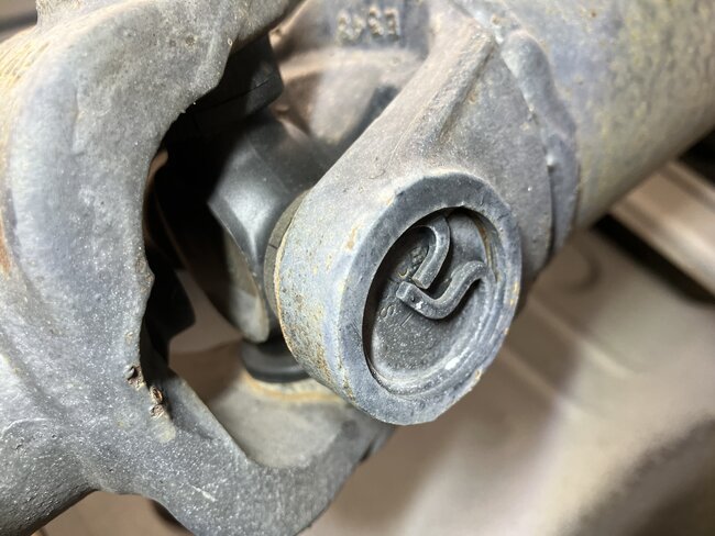

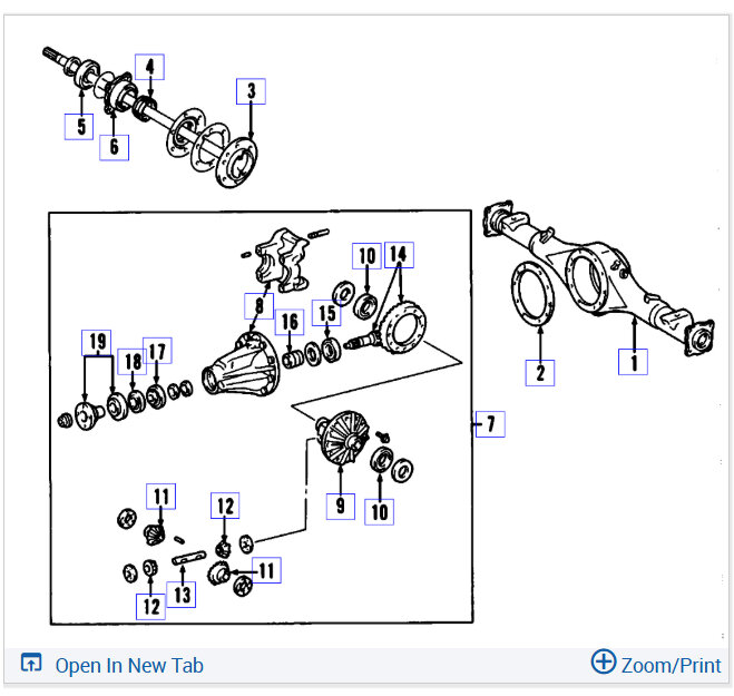

Sudden appearance of a loud screechy rubbing noise in the area of rear wheels both sides. No noise coasting engine off. No noise engine on coasting in neutral. Noise starts in gear and stops when clutch pushed in. Rear wheels on jacks the noise not present in any of these conditions. Pulled drums inspected and adjusted. No free play in the wheels detected. Walking beside vehicle sound doesn’t seem to come from transmission area but from the rear wheels. Stumped.
