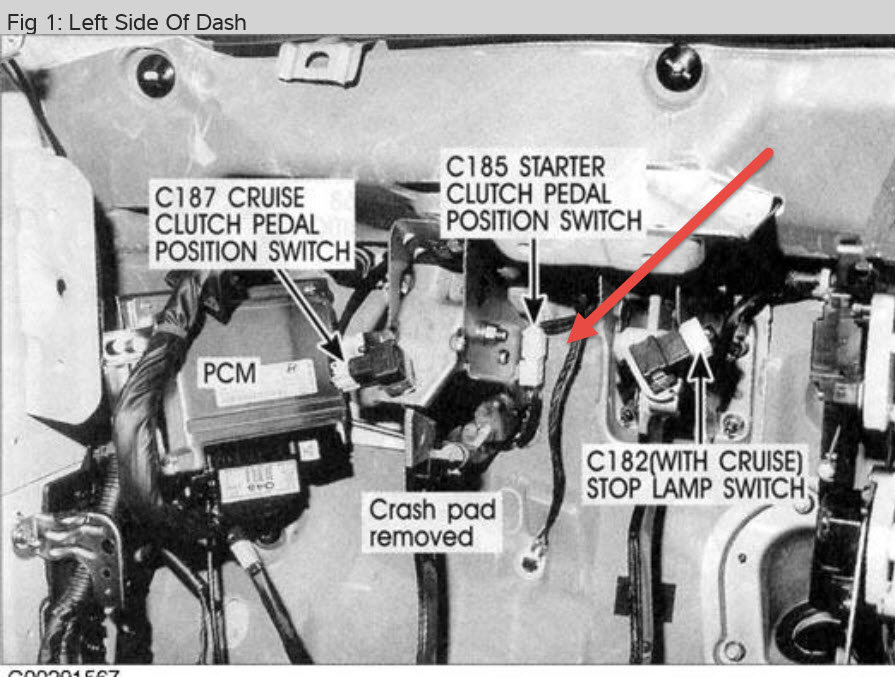

When I press the clutch it will not start. noticing that I would have to press the clutch all the way to the floor board until one day it would not start. how do I access the clutch ignition switch and where is it located so I will not have to take it to the shop?
Can I bypass the clutch ignition switch and go directly to the starter? Are there any illustrations on how to do it?

there are no illustrations to jump the switch and we cannot not tell you how to do it for safety reasons anyhow. See picture.
