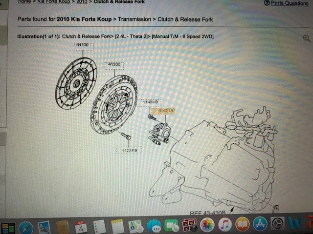

Hi Greg. Honestly, I would replace the check valve at the same time. That way there's no question. If you are going to replace everything, here are the directions for removing and replacing the transmission. There are a ton of pictures that correlate with these directions. I do not know if you need them, but figured I would add them just in case. Note: When you remove the transmission, you will need to support the engine. The procedure is in the directions. Also, the directions indicate the torque specs for all components. Let me know if you need help with anything or need more information.

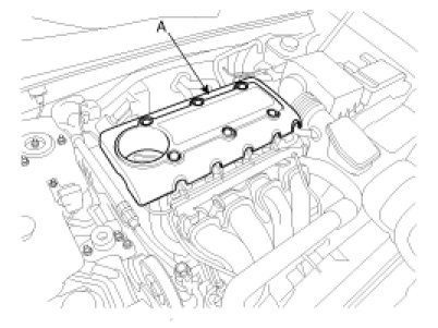

1. Remove the engine cover(A).

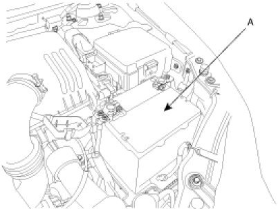

2. Remove the battery(A).

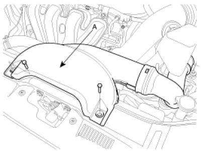

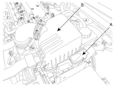

3. Disconnect the air duct (A).
4. After disconnecting ECU connector (A), remove the air cleaner assembly (B).

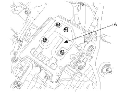

5. Remove the battery tray (A).

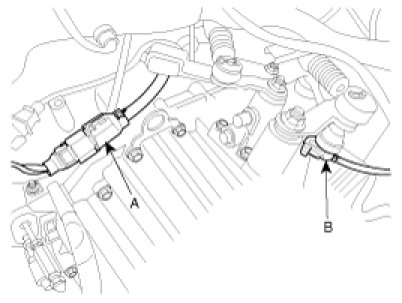

6. Disconnect the vehicle speed sensor connector (A), the back up lamp switch connector (B).

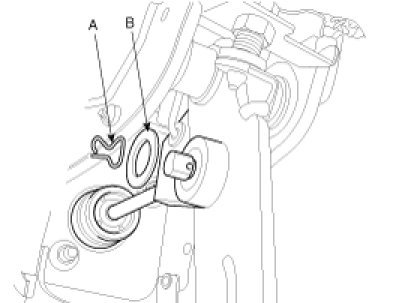

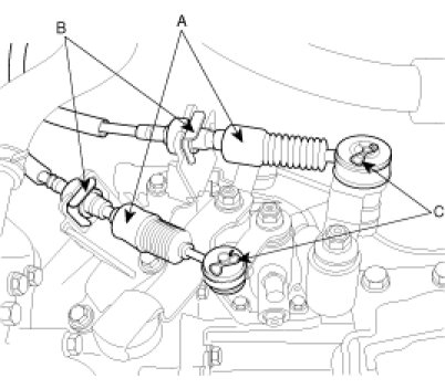

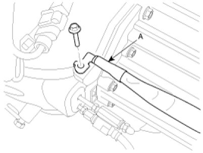

7. Disconnect the cable assemblies (A) after removing the clips (B) and pins (C).
8. Remove the ground (A).

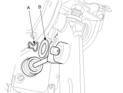

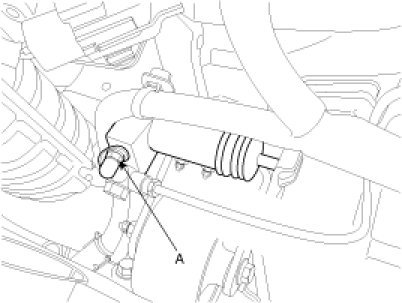

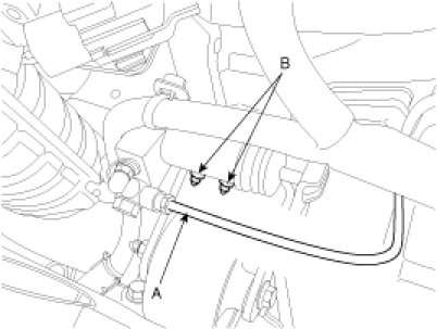

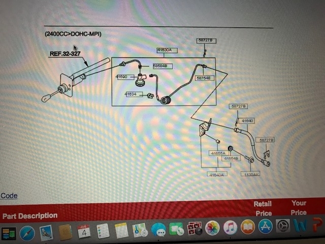

9. After removing the clip(B) with clamping the concentric slave cylinder tube, disconnect the tube(A).

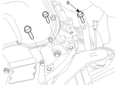

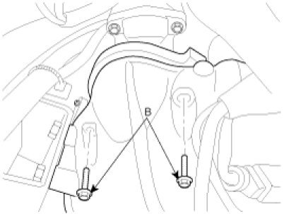

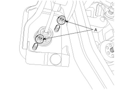

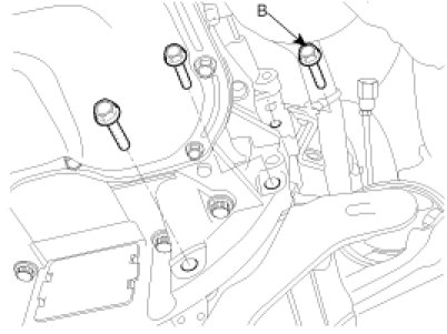

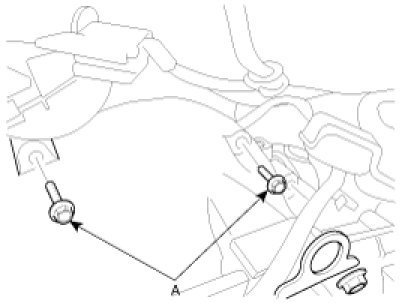

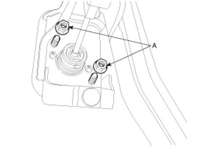

10. Remove the transaxle upper mounting bolts (A-2ea) and the starter motor mounting bolts (B-2ea).

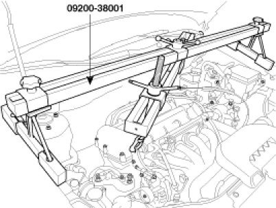

11. Using the special tool(09200-38001), support the engine transaxle assembly safely.

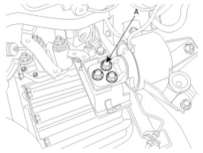

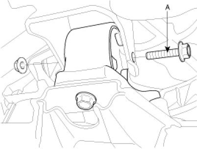

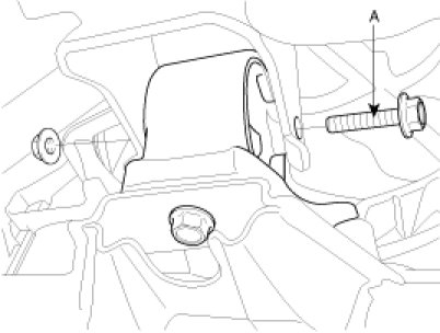

12. Remove the insulator bracket bolts (A).

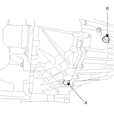

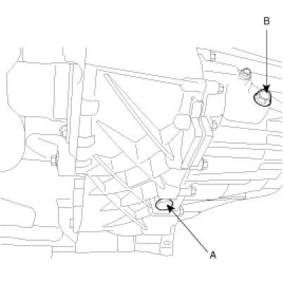

16. Drain the manual transaxle fluid after removing the transaxle drain plug(A). It can be easier when the oil filler plug(B) is removed.

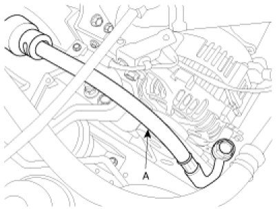

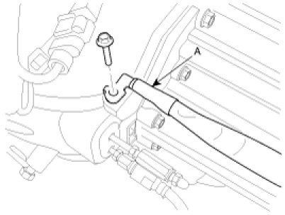

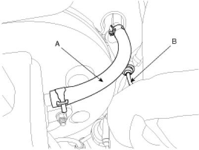

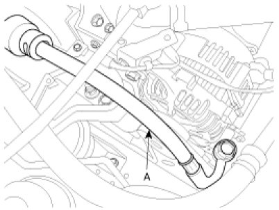

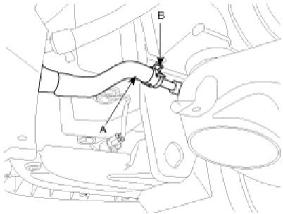

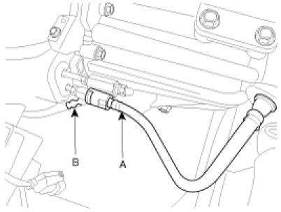

17. Loosening the clamp(B), disconnect the the power steering return hose(A) and drain the power steering fluid.
18. Disconnect the power steering pressure hose(A) bolt(B).

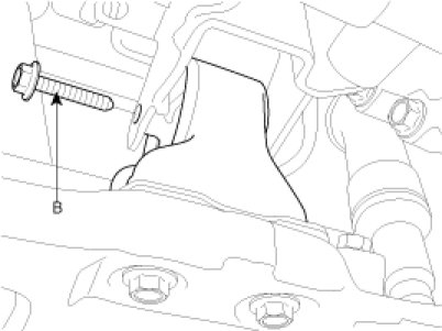

22. Disconnect the roll stopper bracket bolts(A,B).

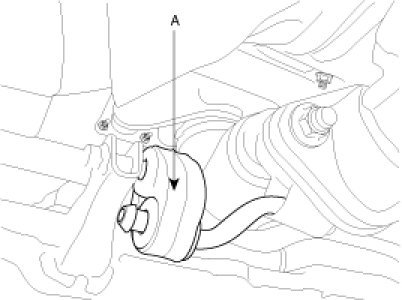

23. Disconnect the muffler hanger rubber (A).

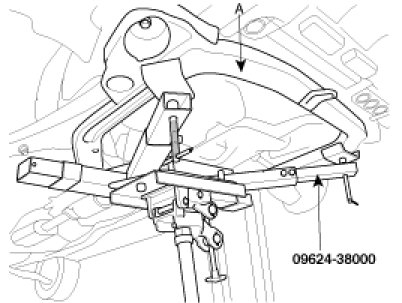

24. Supporting the sub frame with a jack and the Special tool(09624-38000), remove the mounting bolts.

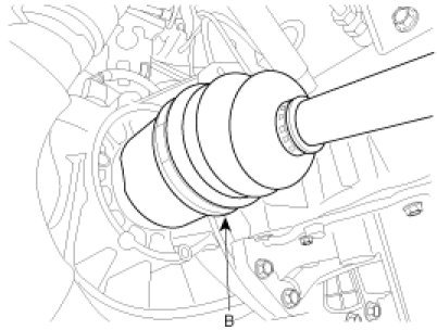

25. Disconnect the driveshafts(A,B) from the transaxle. .

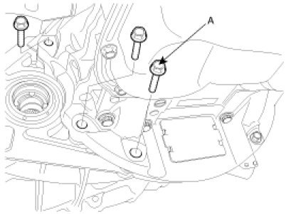

27. Remove the transaxle lower mounting bolts(A-4ea, B-2ea)
28. Lowering the jack slowly, remove the transaxle.

1. Install the transaxle lower mounting bolts(A-4ea, B-2ea)
Tightening torque :
43-55Nm (4.3-5.5kgf.m, 31.1-39.8lb-ft)

5. Install the muffler hanger rubber (A).

7. Connect the the power steering return hose(A) by tightening the clamp(B).

11. Refill the manual transaxle fluid through the oil filler hole by removing the oil filler plug after installing the transaxle drain plug.
Tightening torque :
30-35Nm(3.0-3.5kgf.m,21.7-25.3lb-ft)
Manual transaxle fluid :SAE 75W/85

15. Install the transaxle insulator mounting bracket bolts (A).
Tightening torque :
60-80Nm(6.0-8.0kgf.m,43.4-57.9lb-ft)

19. Connecting the concentric slave cylinder tube(A) install the clip(B).

23. Install the battery tray (A).
