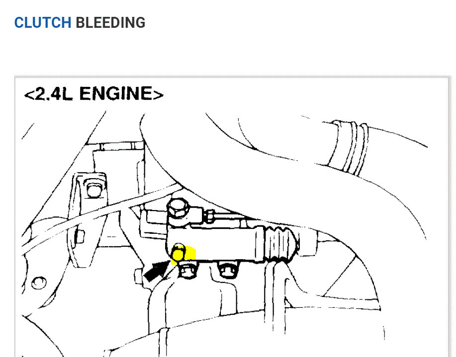

The bleeder is on the slave cylinder. See pic 1. Have a helper pump the clutch about 5 times. Then, while you hold the pedal at the floor, open the bleeder until no air comes out.

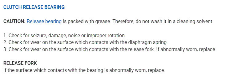

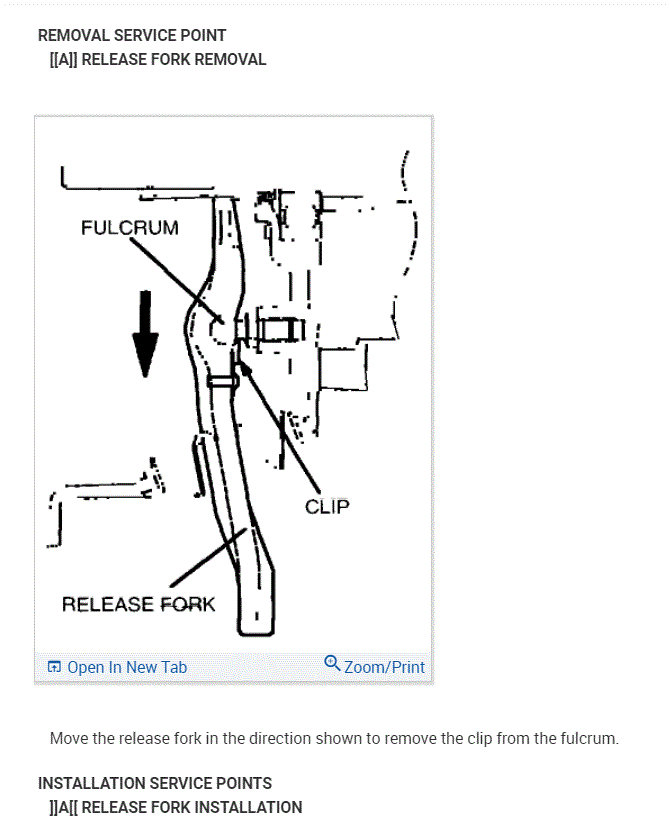

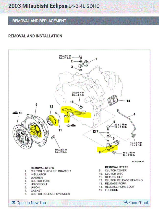

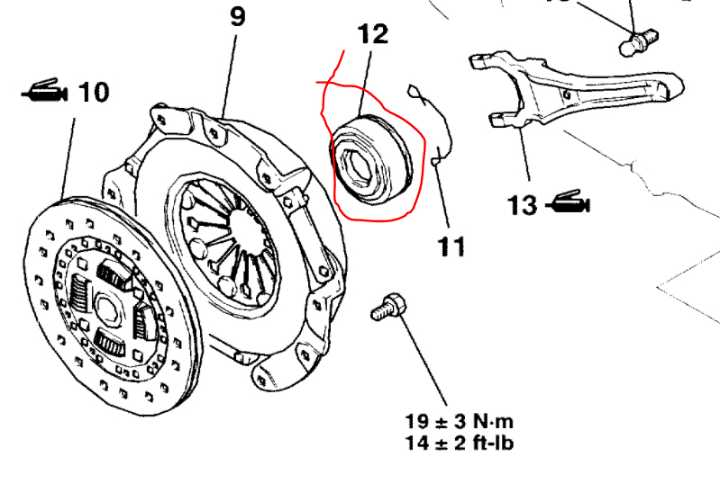

Also, check for leaks and make sure the new fork is properly attached at the fulcrum. See pic 2.
Let me know what you find.
See pics below.

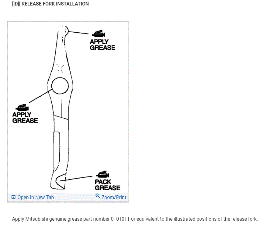

When the engine is off, there is nothing preventing it from shifting. Once it's started, then the clutch separating the transmission from a moving flywheel is needed. That is why it won't shift.

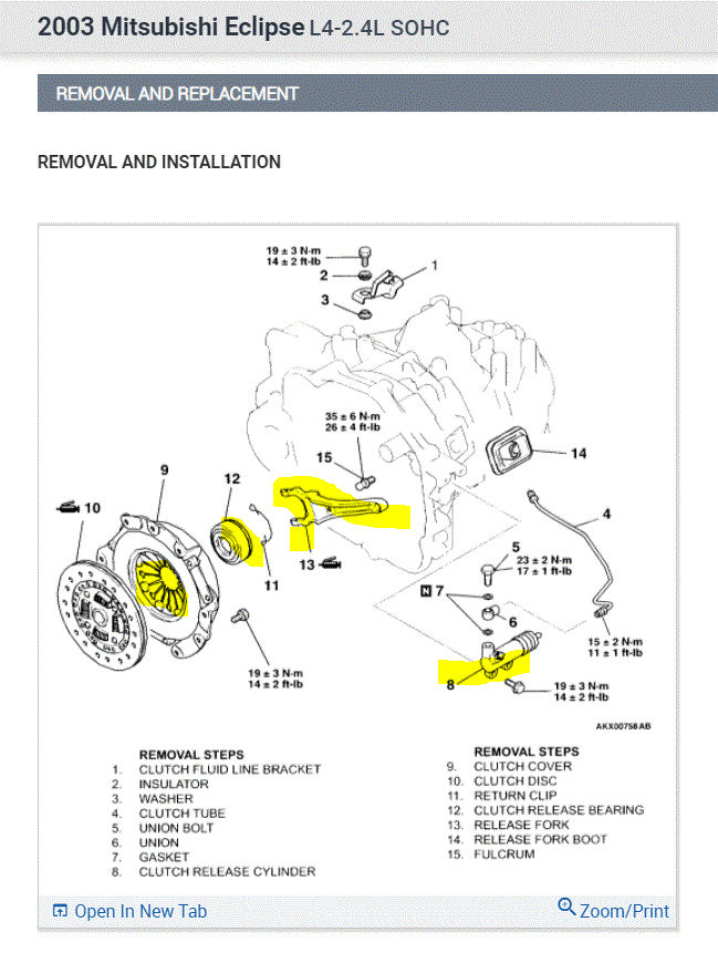

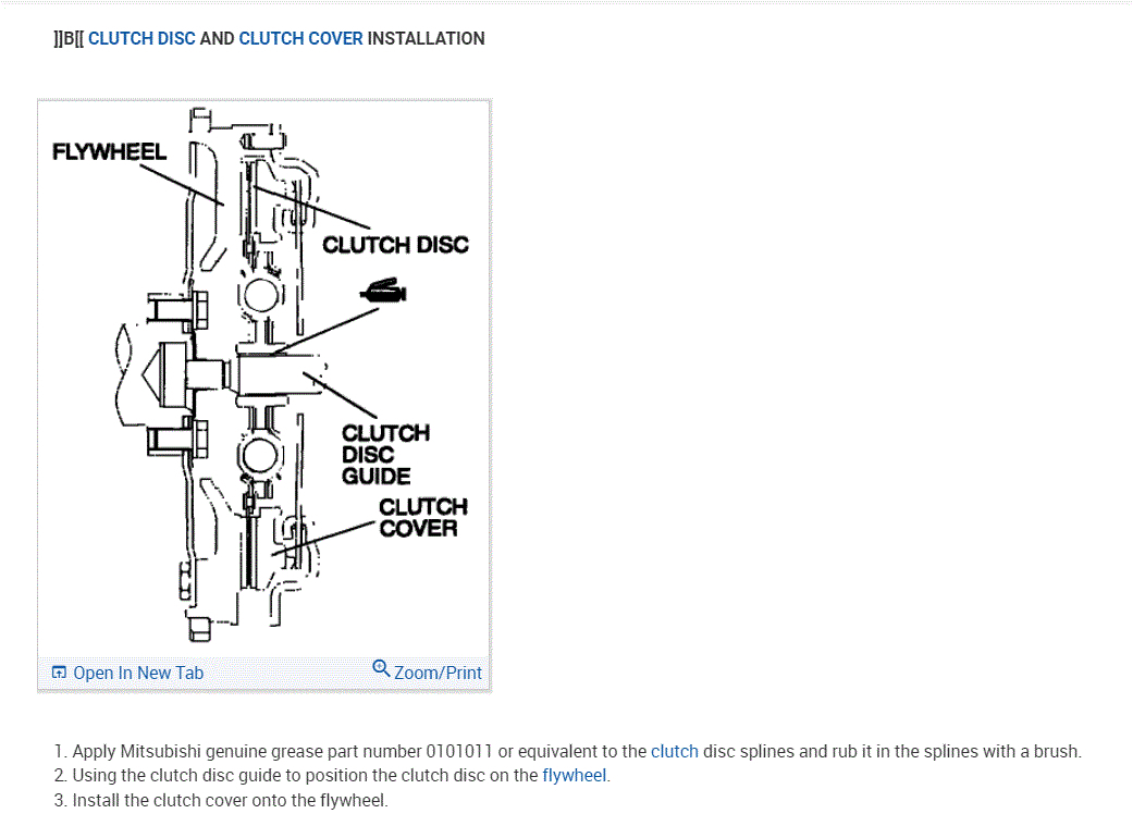

When you had the transmission out, did you replace the pressure plate, clutch disc, and release bearing? See pic 1 below. Also, did you use a clutch alignment tool to align the clutch disc, flywheel, and pressure plate cover before tightening the pressure plate?

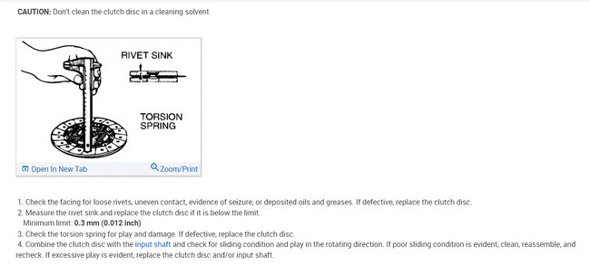

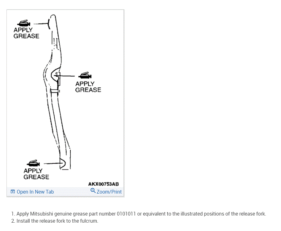

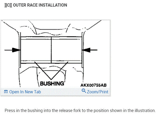

If everything was in good condition, then either something was reinstalled incorrectly (release bearing), the pressure plate release was damaged, or we are missing something really simple. If the slave is moving the clutch fork, it should be pressing the release bearing against the pressure plate and taking pressure off the clutch disc via the pressure plate. That disengages the engine and transmission allowing you to shift. Something is preventing a simple process from happening.

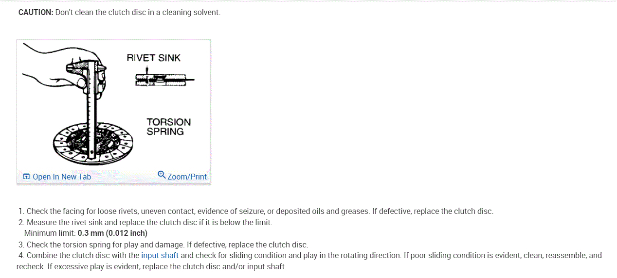

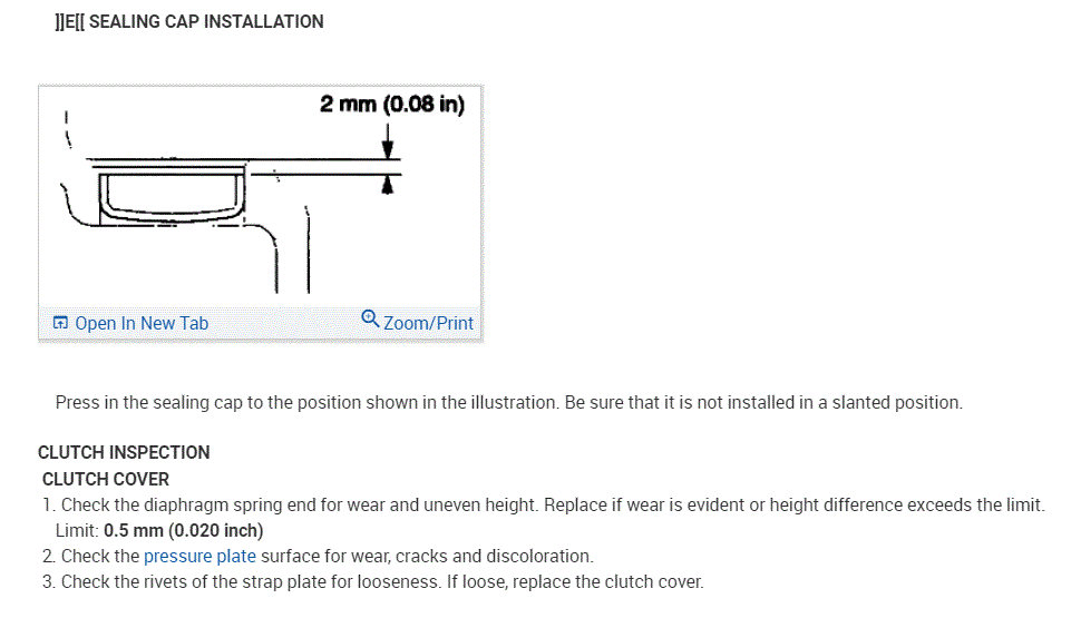

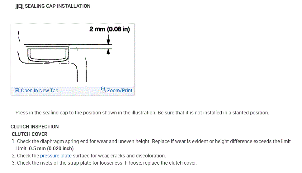

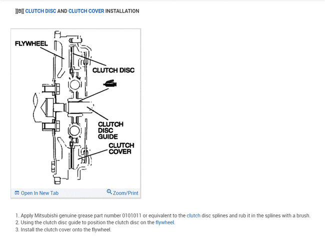

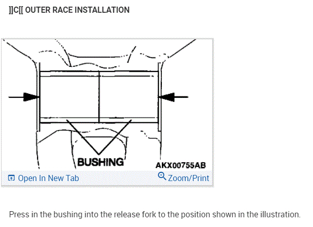

I attached the directions below for the replacement of the clutch disc. Read through them and see if there is anything you may have missed.
See pics below.
