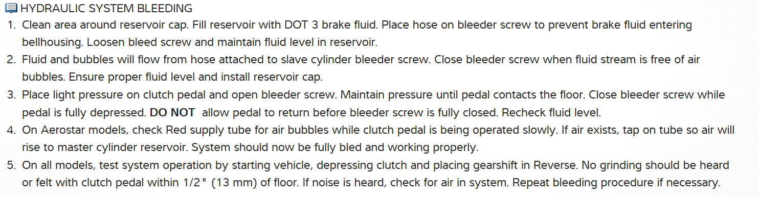

these can be a pain to bleed is what it sounds like. also, check for a bent fork and make sure it is in correctly. try gravity bleed first with out touching pedal like instructions in picture.
