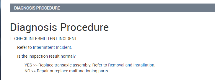

P285A.
Feb 20, 2021 at 3:39 PM

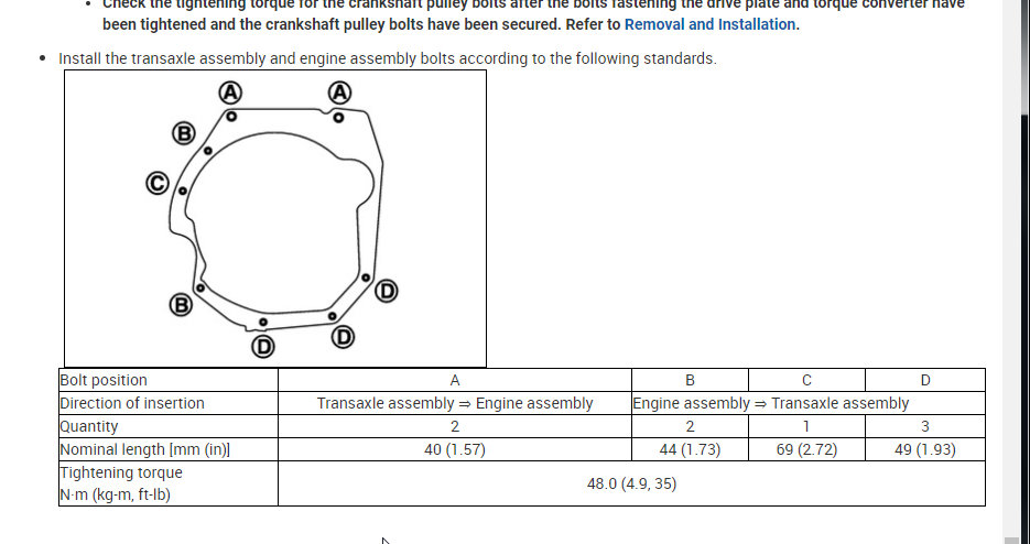

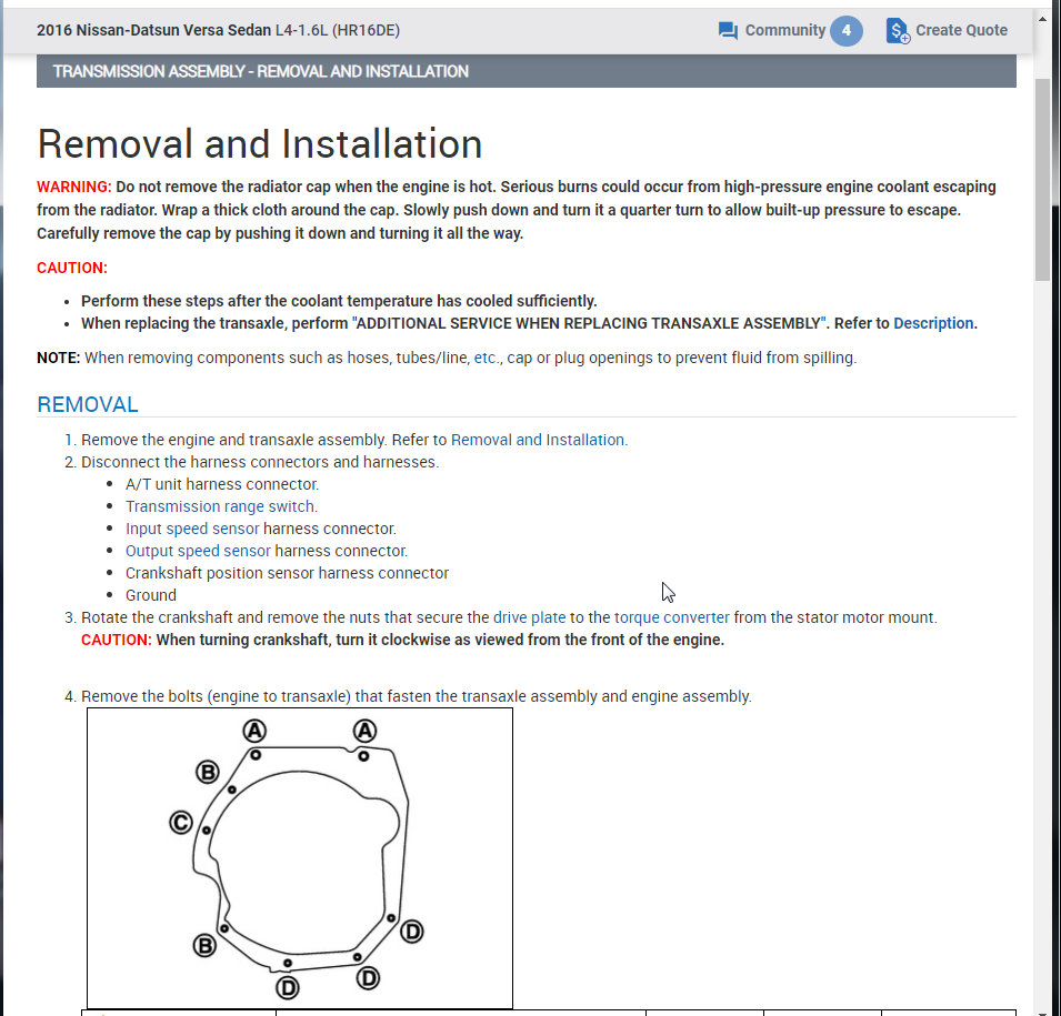

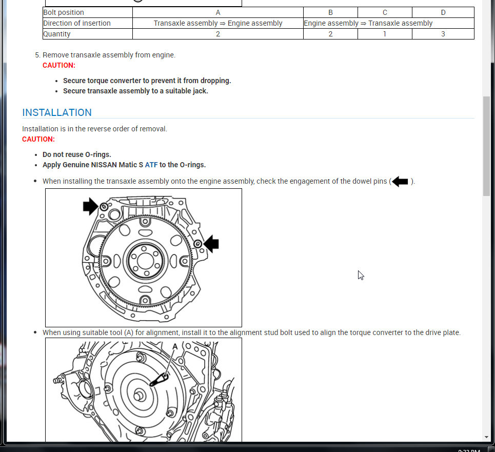

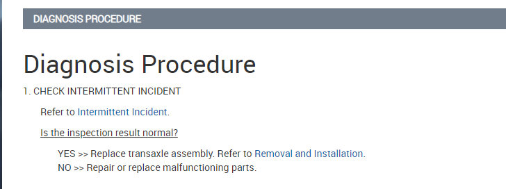

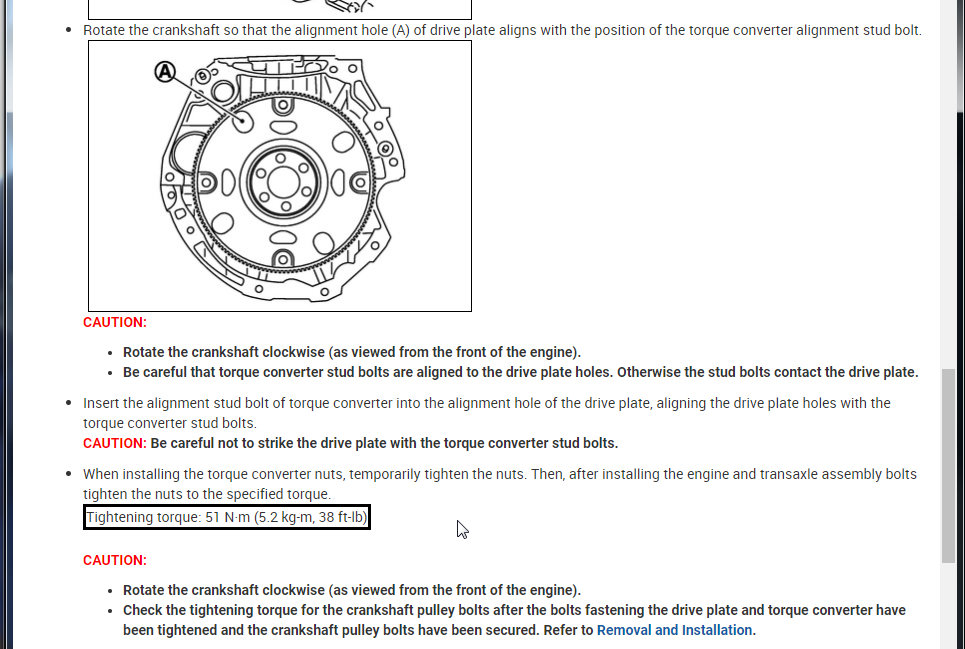

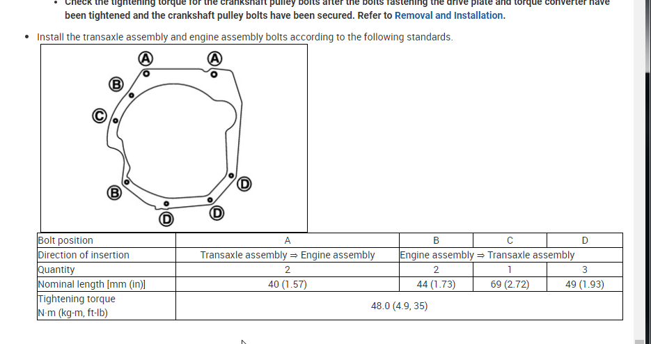

That is unfortunate because Nissan does not give any testing or repairs for this code. They literally tell you to replace the transmission. So I attached the process from the manual below.
Here is a guide that will help with this as well:
https://www.youtube.com/watch?v=3vJAojsrfuU
Let us know if you have questions. Thanks
