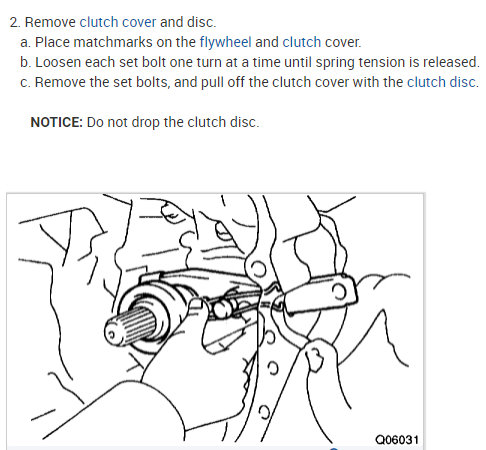

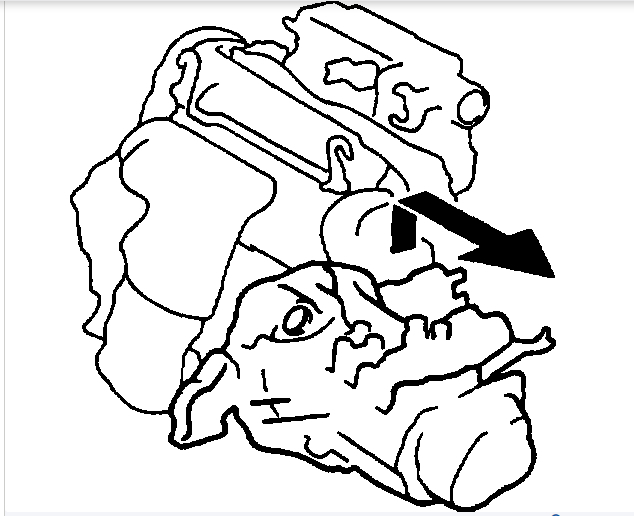

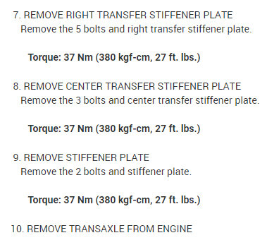

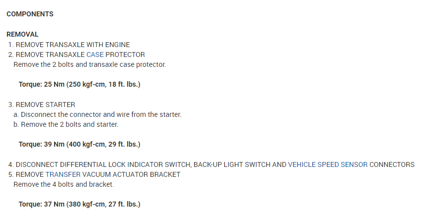

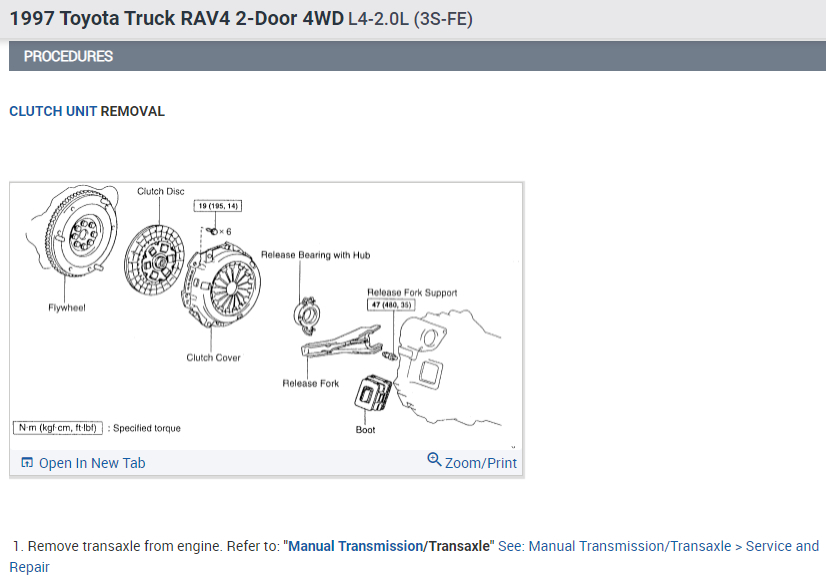

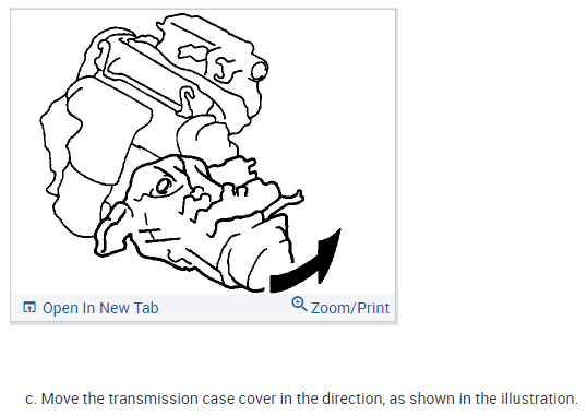

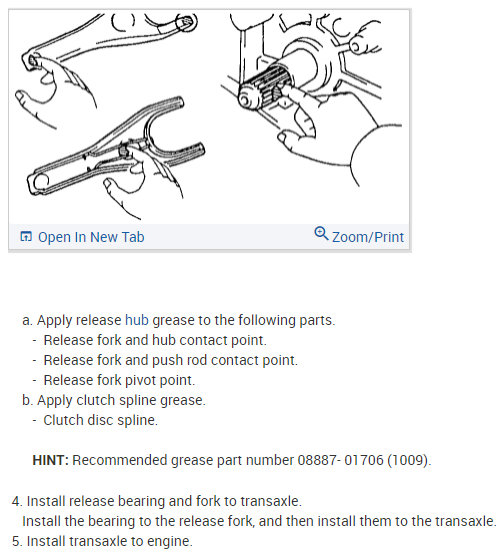

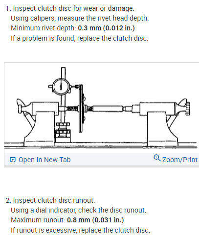

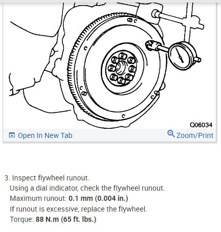

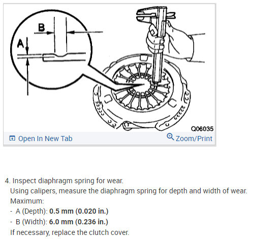

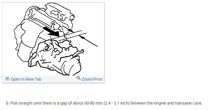

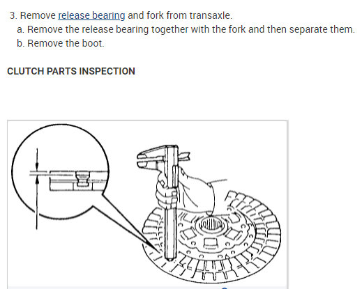

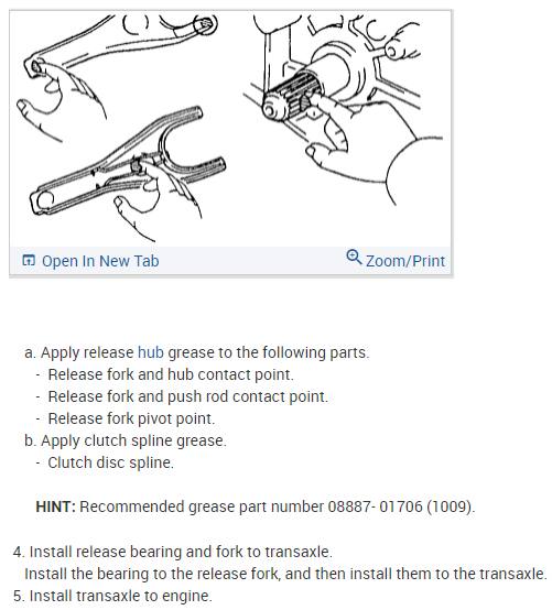

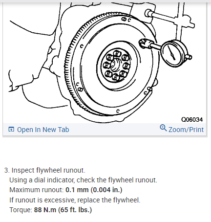

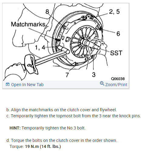

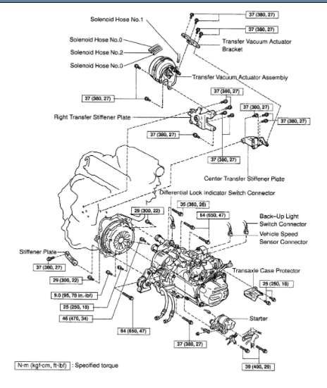

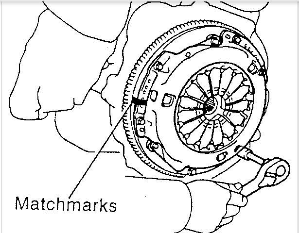

Unfortunately, we do not give out referrals for repairs or businesses we just provide repair guides and advice on how to fix your vehicle yourself. Here is a tutorial showing how to remove and install a manual transmission and another for clutch replacement:
https://www.2carpros.com/articles/how-to-replace-a-clutch
https://www.2carpros.com/articles/transmission-replacement-removal-manual

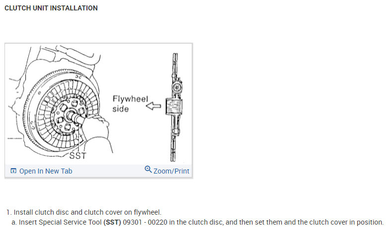

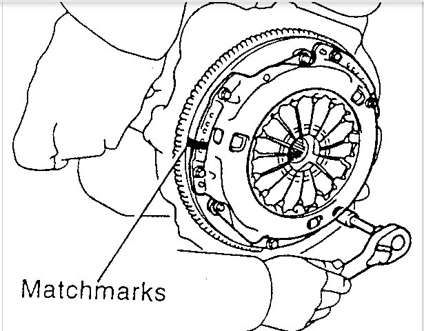

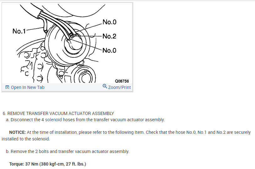

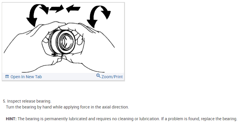

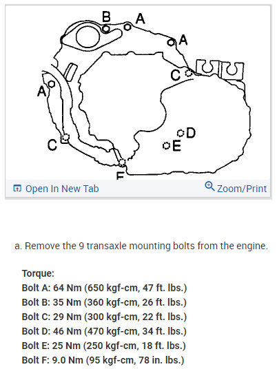

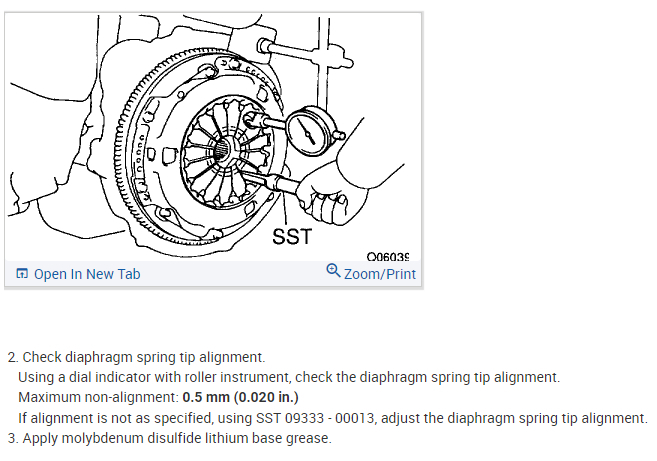

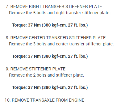

I've attached picture steps below showing how to remove and install the transmission and clutch on your vehicle. Hope this helps and thanks for using 2CarPros.
