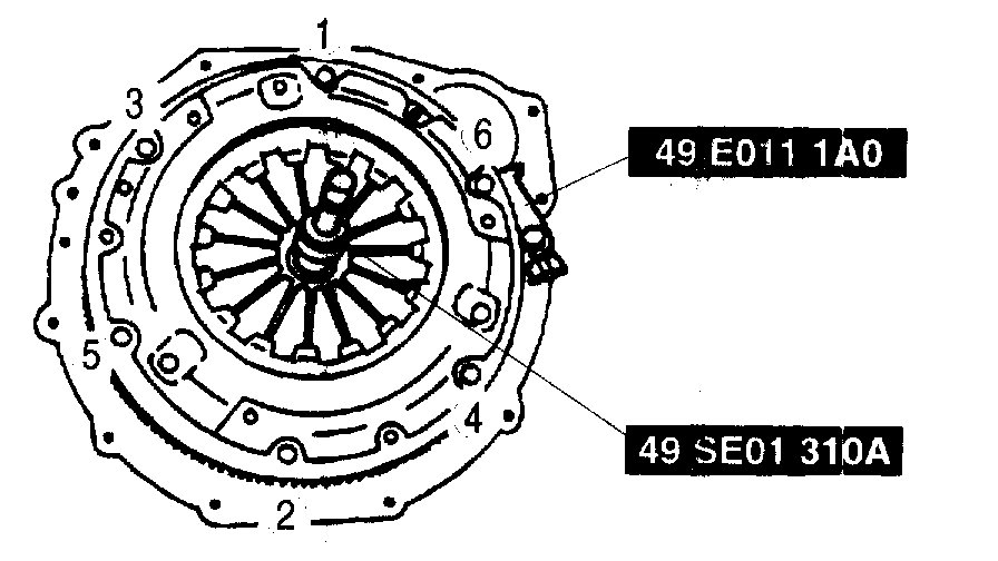

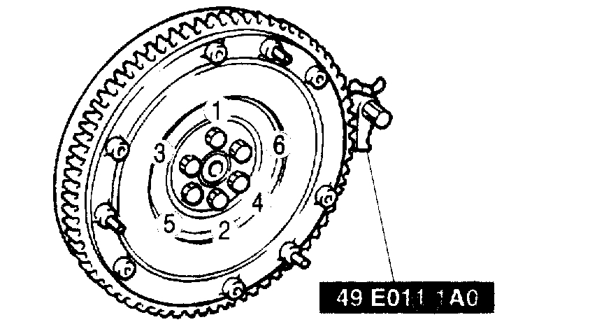

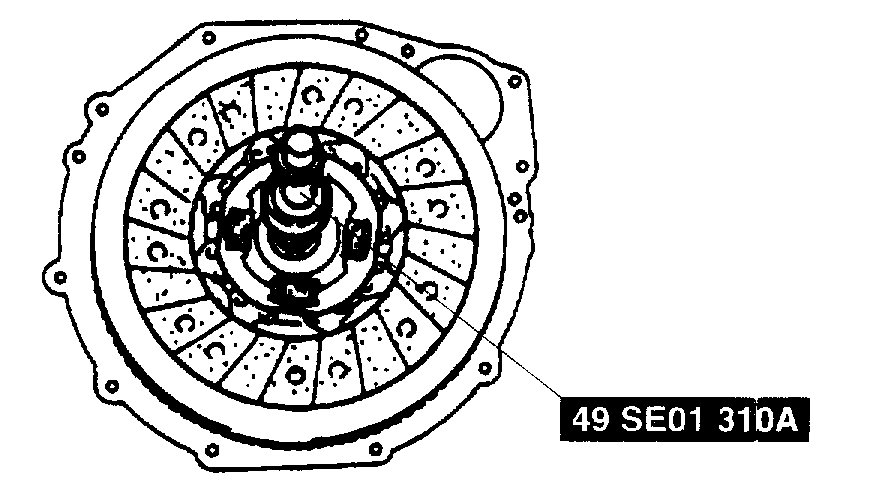

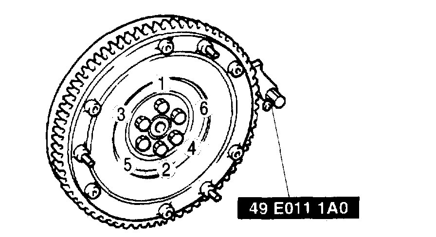

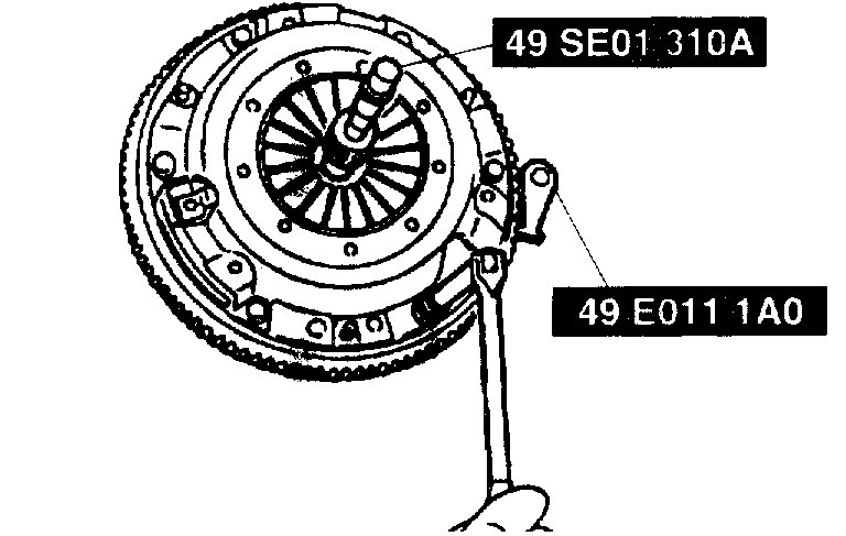

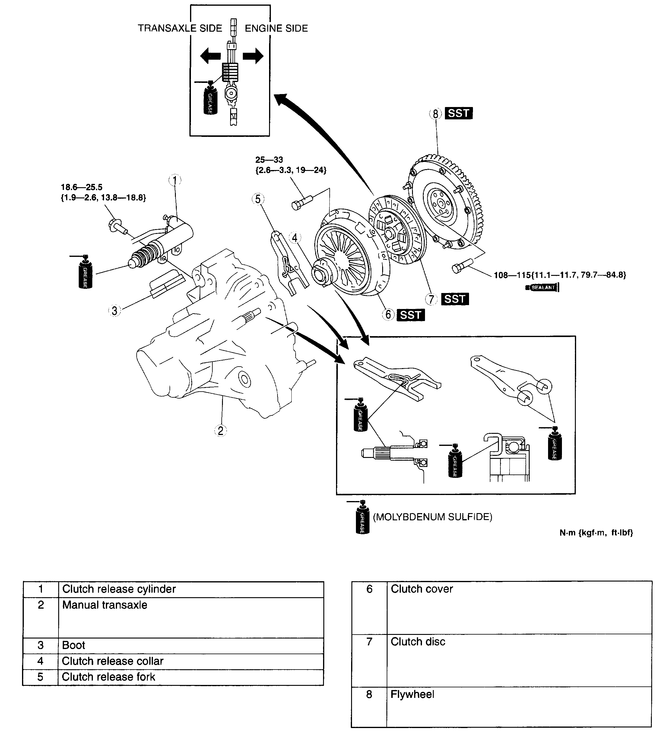

Here are the removal and install directions right from Alldata. All attached pictures correlate with these directions.
______________________________________
CLUTCH UNIT REMOVAL/INSTALLATION
1. Remove in the order indicated in the table.
2. Install in the reverse order removal.

Flywheel Removal Note
1. Hold the flywheel using the SST.
2. Remove the bolts evenly and gradually in a criss-cross pattern.
3. Remove the flywheel.
G35M-R manual transaxle models
Flywheel Installation Note
1. Install the flywheel to the crankshaft.
2. When reusing the bolts, clean threads and hole, then apply locking compound to the threads.
Note:
^ No locking compound is needed when using new bolts.
3. Hand-tighten the flywheel lock bolts.
4. Install the SST to the flywheel.
5. Gradually tighten the flywheel lock bolts in a crisscross pattern.
Tightening torque
G35M-R manual transaxle models 108 - 115 Nm (11.1 - 11.7 kgf-cm, 79.7 - 84.8 ft. lbs.)
Clutch Disc Installation Note
1. Hold the clutch disc position using the SST.
Clutch Cover Installation Note
1. Install the SSTs
2. Tighten the bolts evenly and gradually in a crisscross pattern.
Tightening torque 25 - 33 Nm (2.6 - 3.3 kgf-cm, 19 - 24 ft. lbs.)
