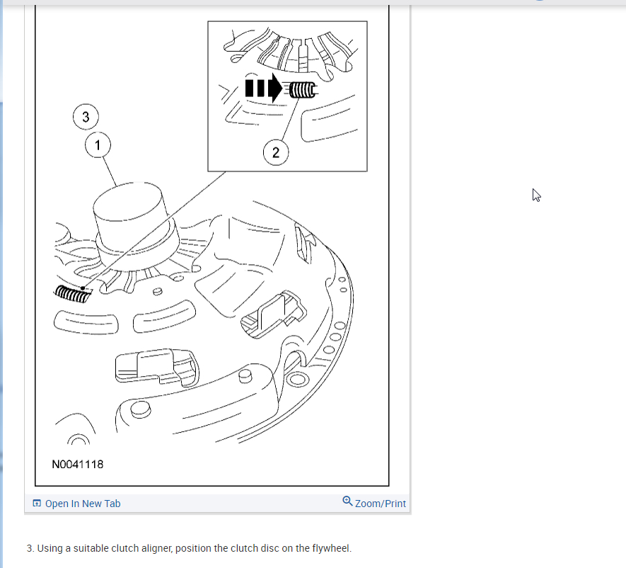

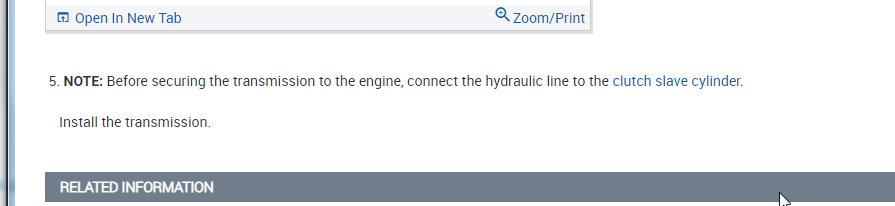

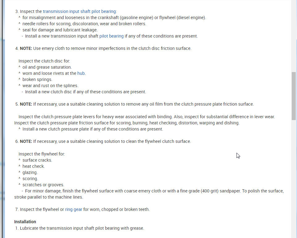

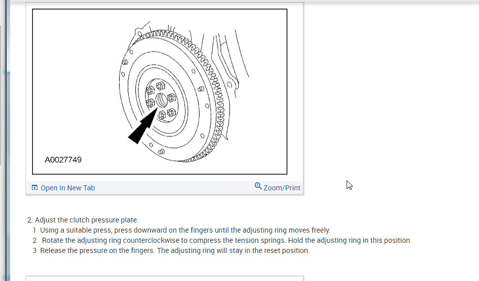

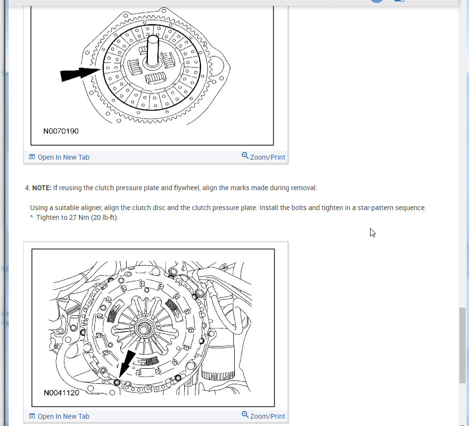

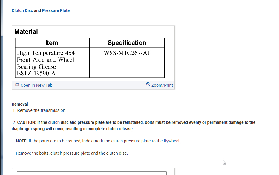

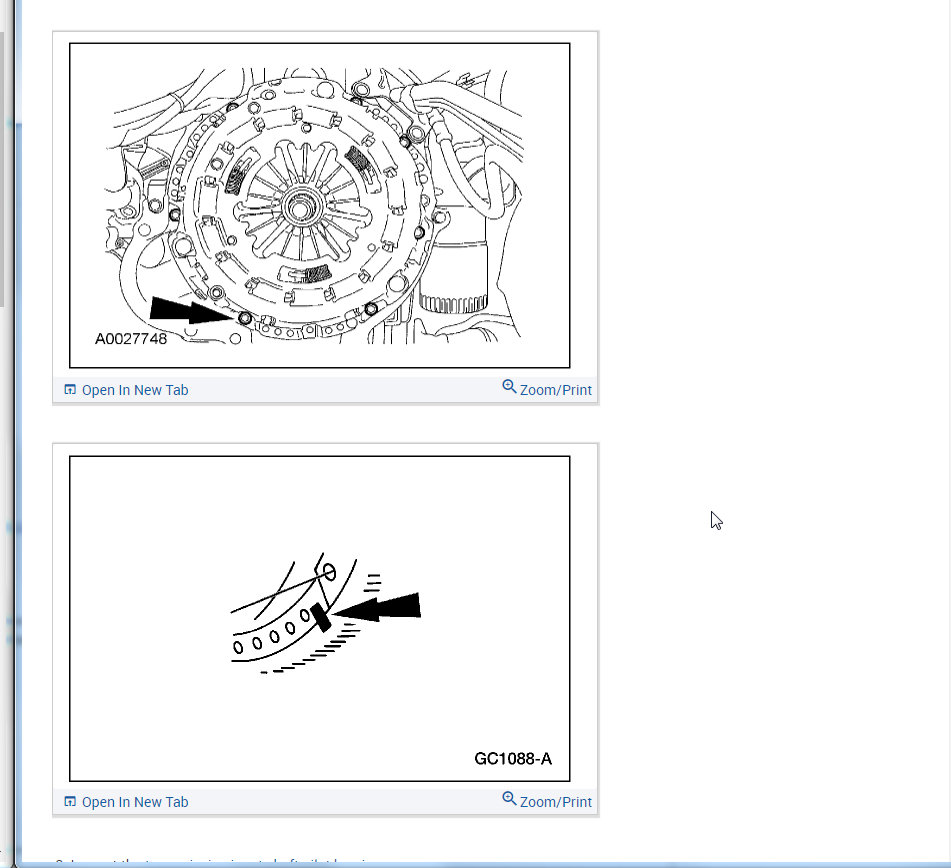

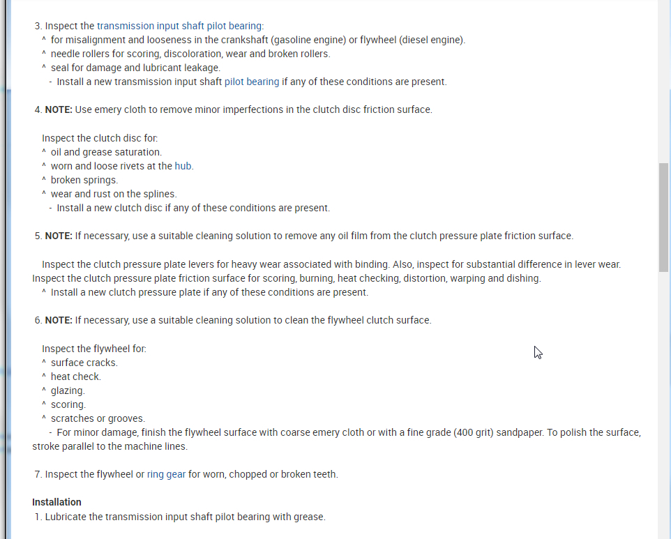

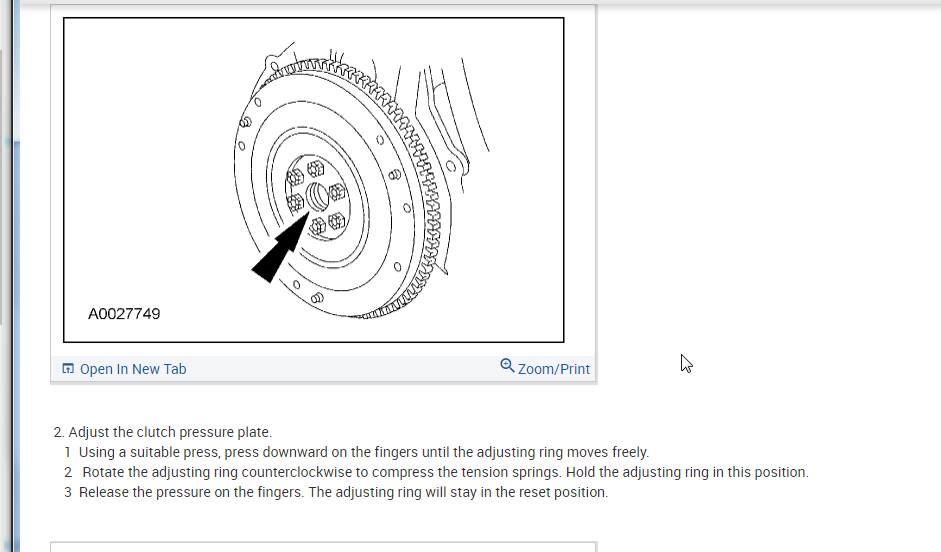

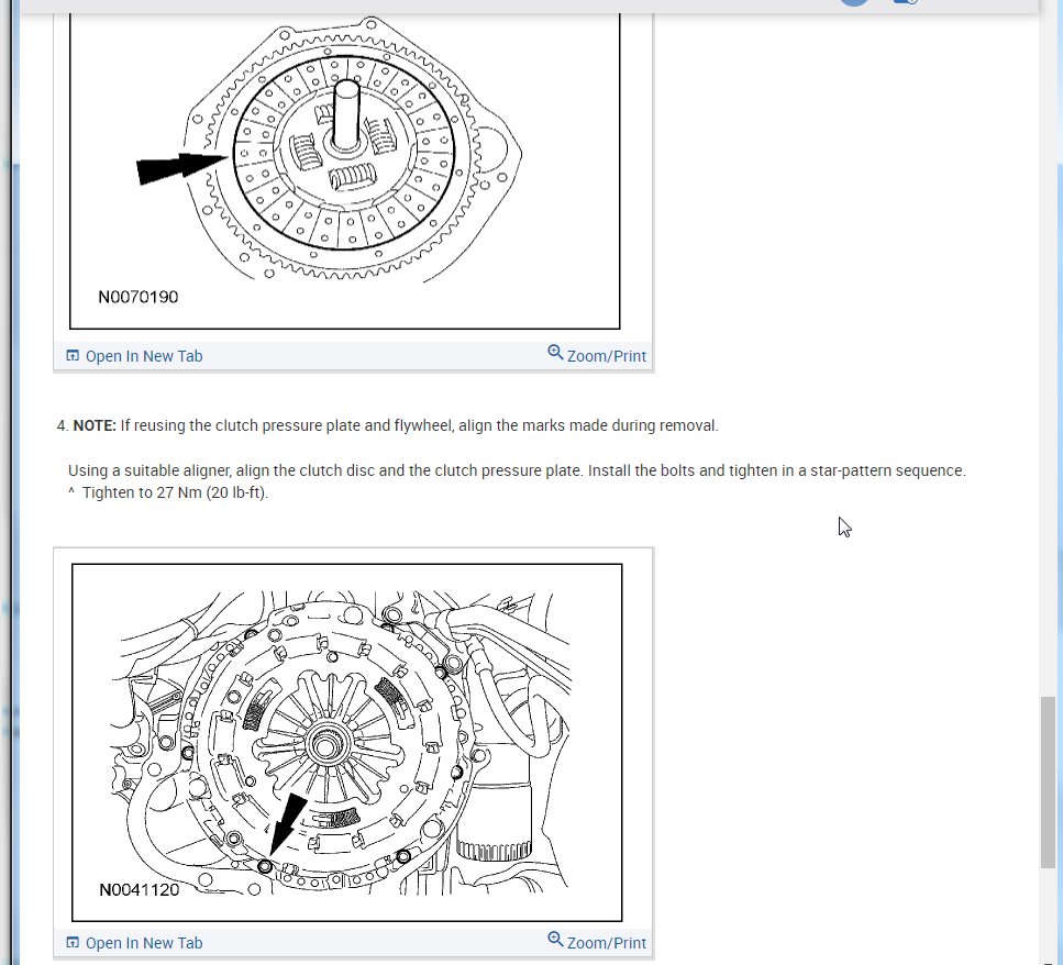

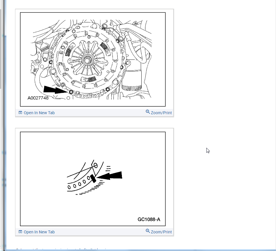

Plus below is the process on how to replace the disc from the manual.
I would replace the entire system including the slave cylinder, pressure plate, and disc.
