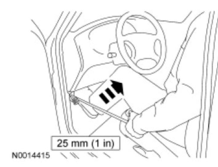

C4 CHECK THE CLUTCH PEDAL RESERVE
NOTE: The clutch reserve is the distance between the clutch pedal when fully depressed and the position when the vehicle starts to move forward.
Park the vehicle on a level surface.
Check for obstructions behind clutch pedal.
Attach a cable tie to the lower clutch pedal.
Attach a tape measure to the cable tie.
Depress the clutch fully and start the vehicle.
Shift the transmission into 1st gear.
While observing the tape measure, slowly engage the clutch, noting when the vehicle starts to move forward.
Is the clutch pedal reserve greater than or equal to 25 mm (1 in)?

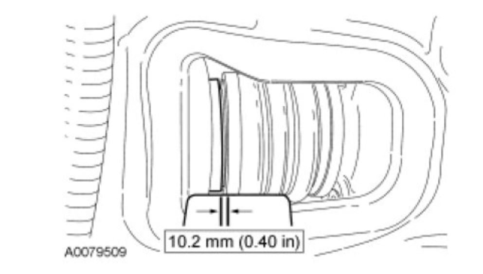

C5 CHECK THE CLUTCH SLAVE CYLINDER TRAVEL
NOTE: The clutch slave cylinder travel is the distance the bearing portion moves forward when the clutch is fully depressed.

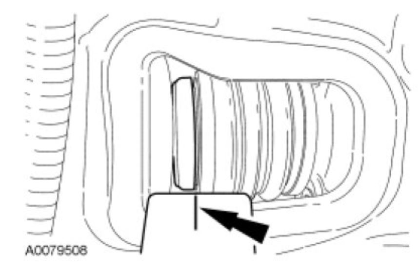

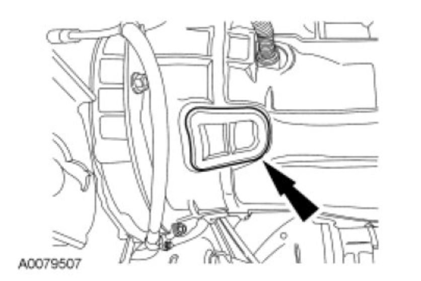

With the vehicle in NEUTRAL, position it on a hoist. Refer to Jacking and Lifting See: Vehicle Lifting > Procedures > Jacking and Lifting.
Remove the inspection plug.
Using a wooden ruler, index-mark the rear of the bearing onto the ruler. Have an assistant fully depress the clutch pedal. Index-mark the rear of the bearing. Measure the distance between the 2 index marks.
Is the clutch slave cylinder travel equal to 10.2 mm (0.4 in)?

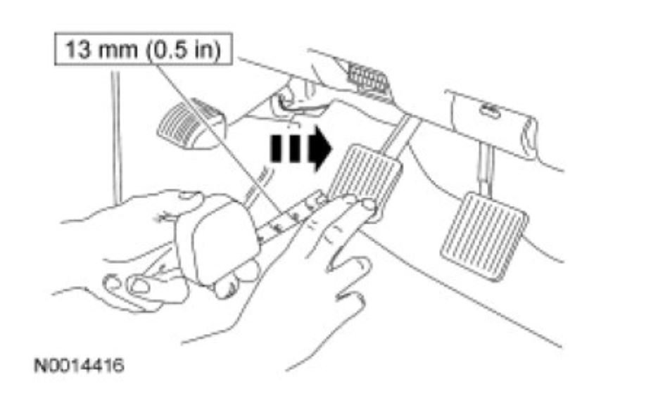

C8 CHECK CLUTCH PEDAL FREE PLAY
NOTE: The clutch pedal free play is the distance between the clutch pedal when fully released and the position when slight resistance is felt on downward motion.
Engine OFF.
While observing the tape measure, slowly push downward on the clutch pedal until a slight resistance is felt.
Is the clutch pedal free play less than 13 mm (0.5 in)?
