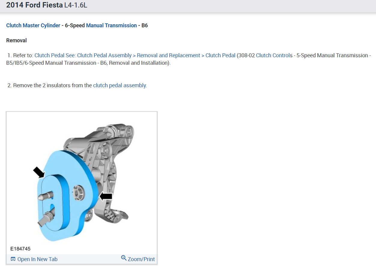

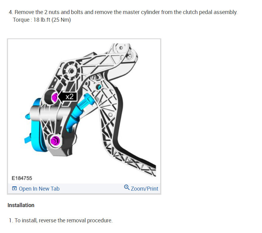

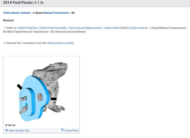

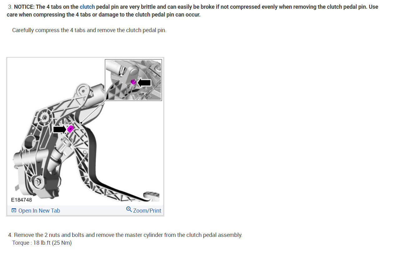

This sounds like you have a clutch disc that is falling apart or the clutch master is bad. To be sure this video will help us see what's going on. I have also included how to change out the clutch master.
https://youtu.be/EpBMj5ZY_bo
and
https://www.2carpros.com/articles/clutch-doesnt-work-sometimes-or-not-at-all
