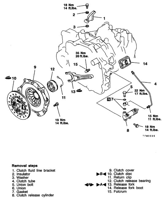

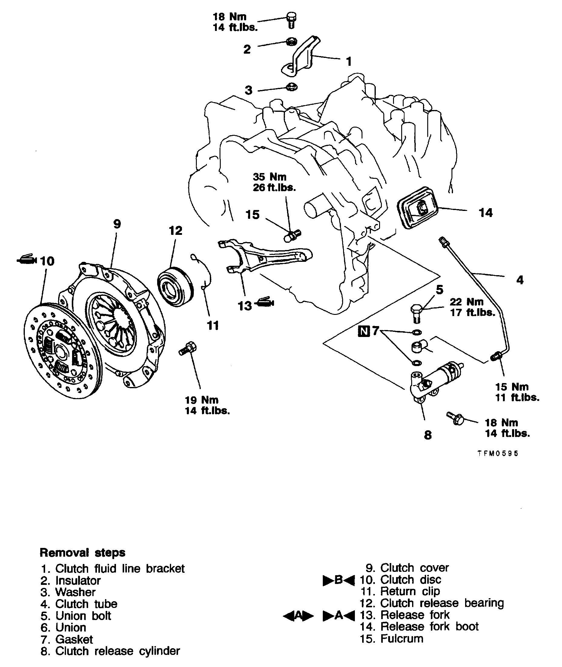

REMOVAL AND INSTALLATION
REMOVAL SERVICE POINT

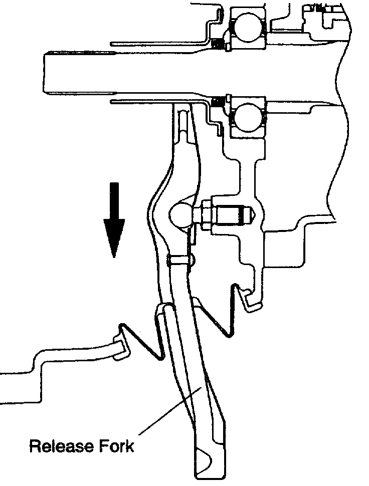

[A] RELEASE FORK REMOVAL
1. Move the release fork in the direction shown to remove the clip from the fulcrum.
INSTALLATION SERVICE POINTS

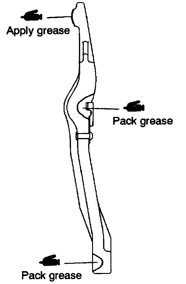

]A[ GREASE APPLICATION TO RELEASE FORK
Specified grease: MITSUBISHI genuine grease part No. 0101011 or equivalent

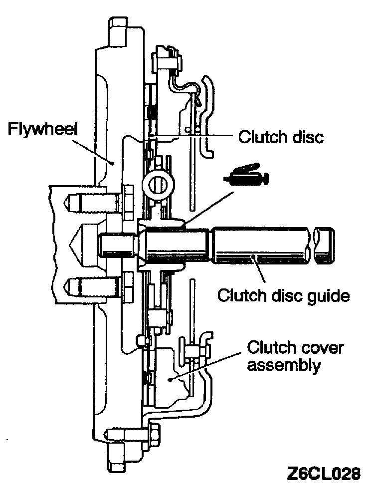

]B[ CLUTCH DISC INSTALLATION
1. Apply the specified grease to the clutch disc splines and rub it in the splines with a brush.
2. Using the clutch disc guide to position the clutch disc on the flywheel.

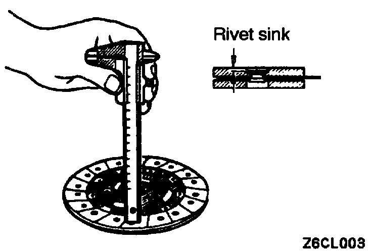

1. Check the facing for loose rivets, uneven contact, evidence of seizure, or deposited oils and greases. If defective, replace the clutch disc.
2. Measure the rivet sink and replace the clutch disc if it is out of specification.
Limit: 0.3 mm (0.012 inch)
