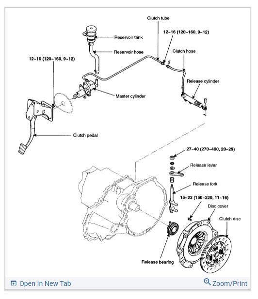

Wondering if the make and model car has a clutch that's adjustable or not? If so how do you adjust it?

Your vehicle has a Hydraulic clutch using fluid to work the system and there is no adjustment possible I'm afraid to say. please see diagram below for operation and parts.
