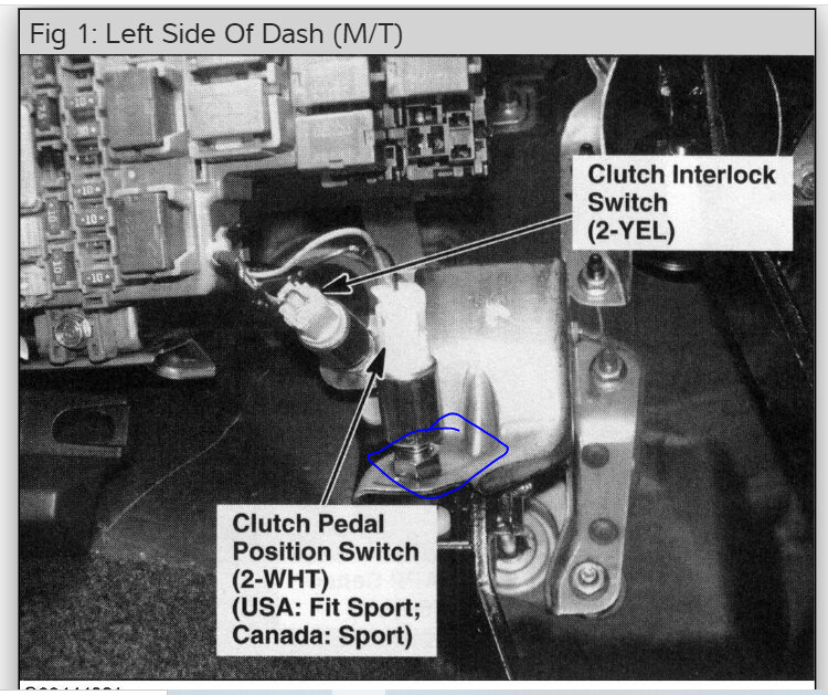

I was wondering if I need to remove my clutch pedal to make it to where I can replace my neutral safety switch.
Nov 24, 2023 at 12:25 PM
You shouldn't need to remove it. I attached a pic below. It appears there is a retainer nut behind the mount. Remove that, disconnect the electrical connector, and it should come right off. Make sure when you install the new one that it is adjusted properly so that it functions properly.
Take care and let me know if this helps.
See pic below.
