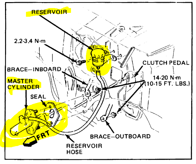

If the clutch pedal went to the floor, chances are either the clutch master cylinder is faulty or the slave cylinder.
I attached pictures showing both. Do me a favor. First check the clutch master cylinder reservoir and make sure it is full. If it isn't, add Dot 3 brake fluid to fill it. See if that changes things. See pic 1
If the reservoir is low, check the clutch master cylinder and lines to see if there is a leak.

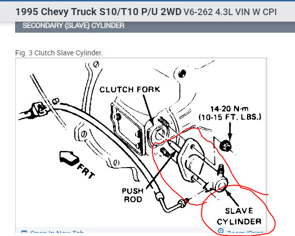

If there are leaks but the reservoir was low or empty, go to the transmission bell housing and locate the slave cylinder. See pic 2. Check for evidence of a leak there.
