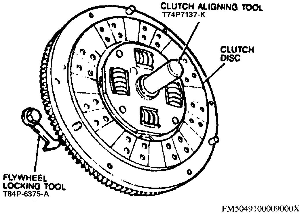

d. Finger tighten cover attaching bolts, then align clutch disc using tool No. T74P-7137-K or equivalent.

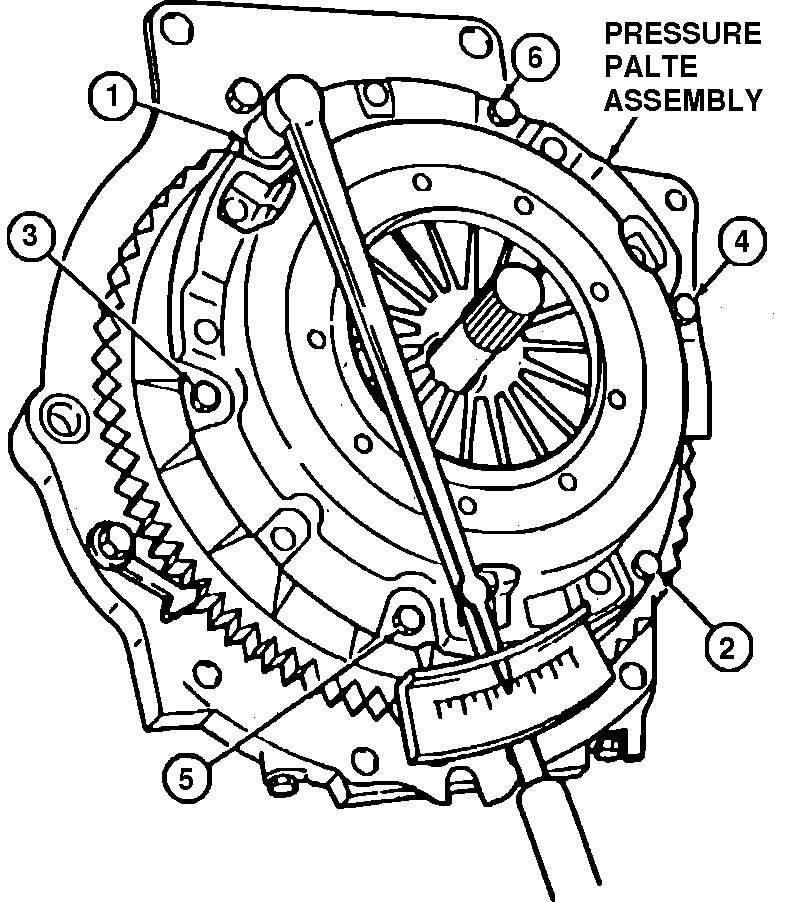

e. Evenly torque bolts to 13-20 ft lbs in sequence shown.

The first 2 pictures correlate with the removal and replacement directions.

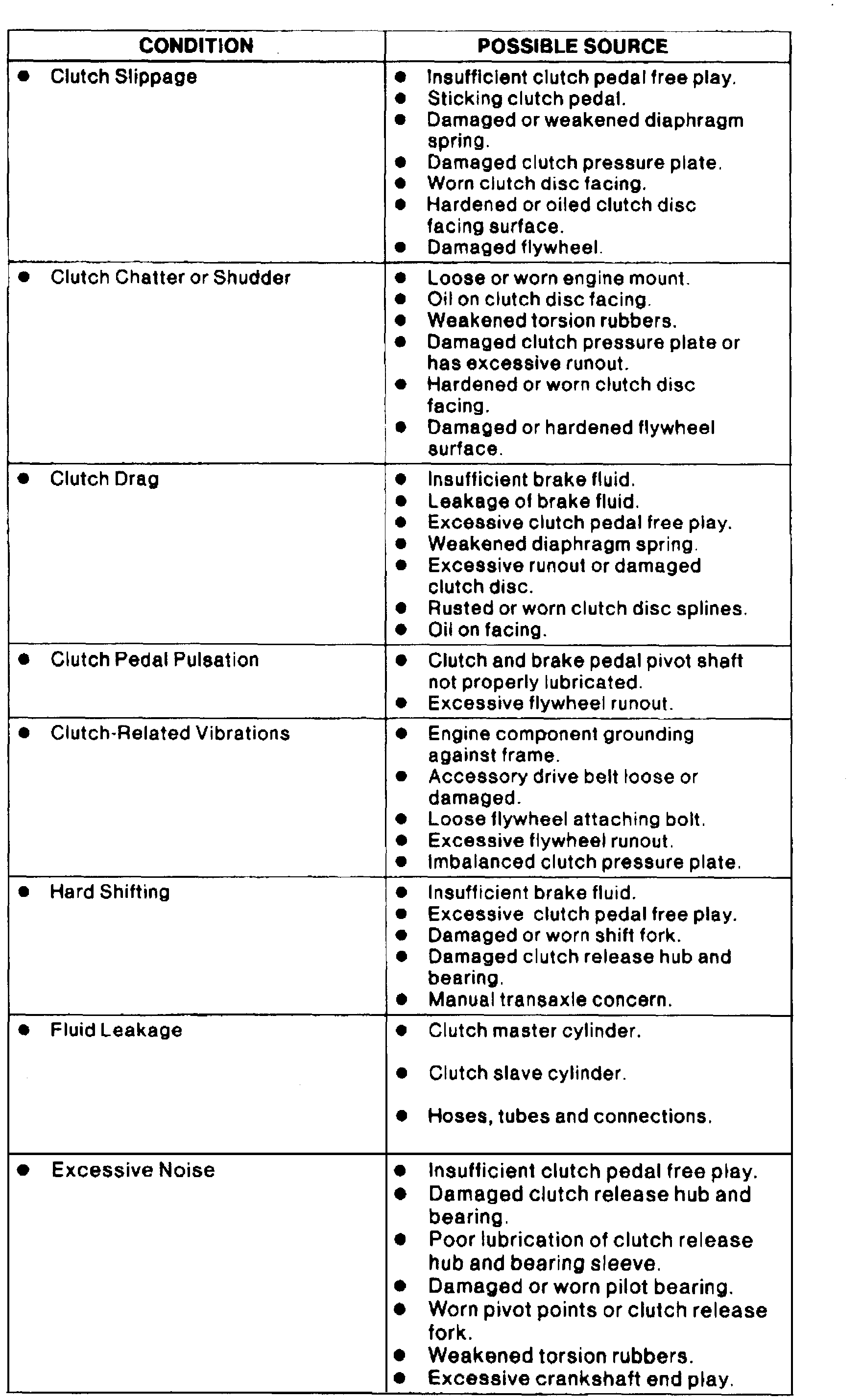

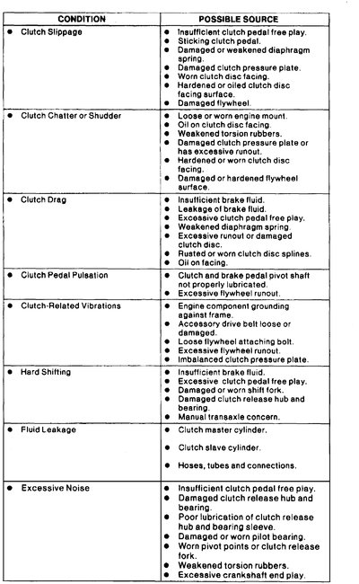

Picture 3 is a list of possible issues. When looking through it, focus on the hard shift issues. However, if that was not an issue prior, I do not think it is relevant.
Let me know what you find when looking through the directions or if you have other questions.
