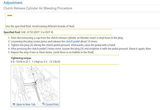

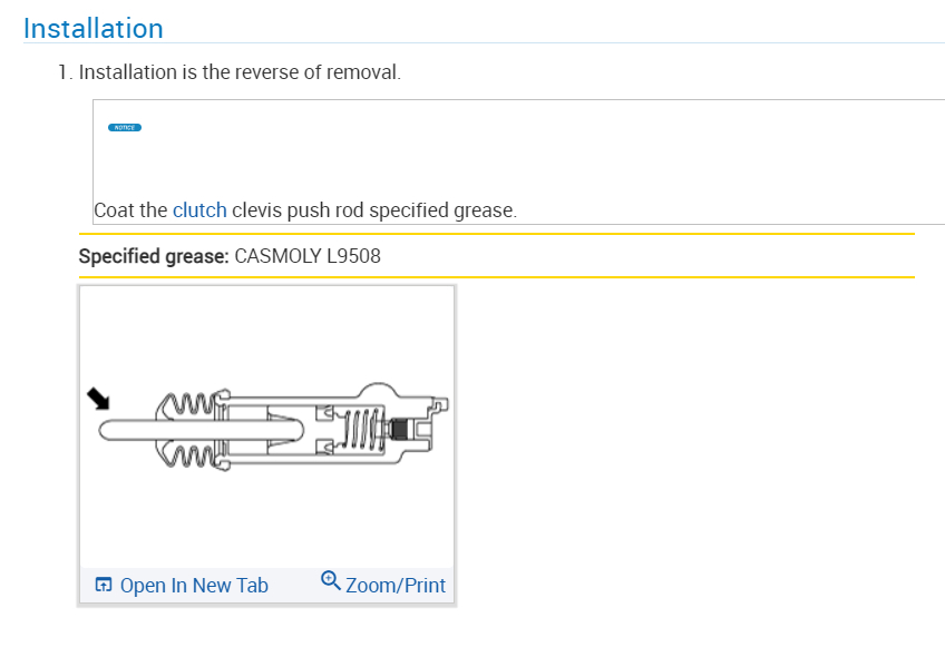

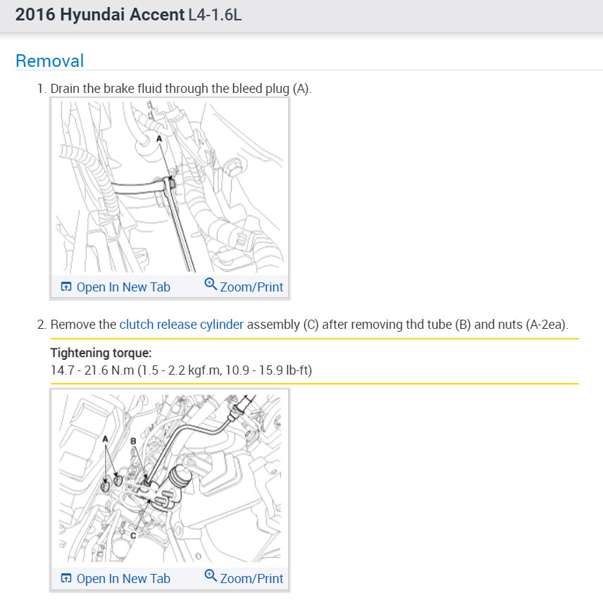

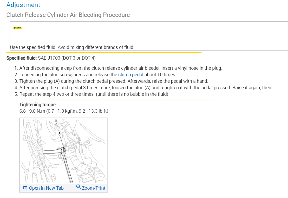

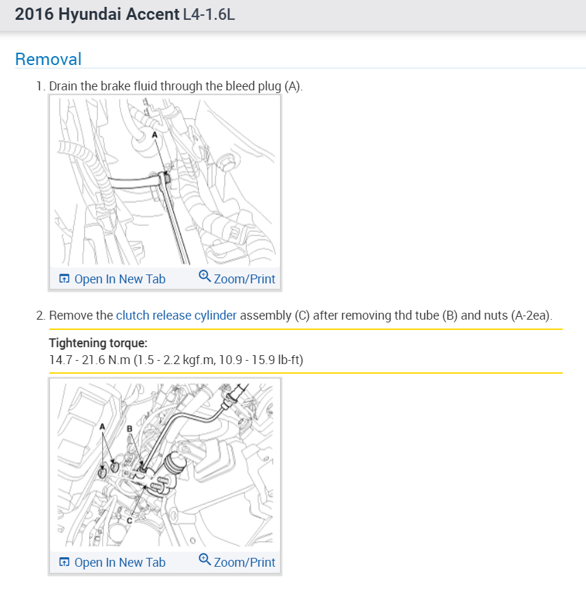

It sounds like the secondary cylinder is bad. Here is how the job is done on your car. Check out the images (below). Let us know what happens and please upload pictures or videos of the problem so we can see what's going on.
