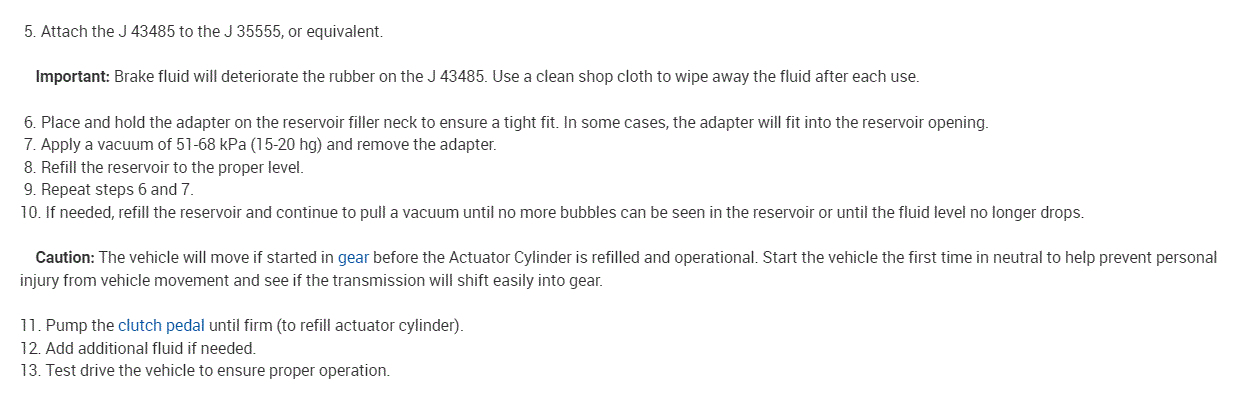

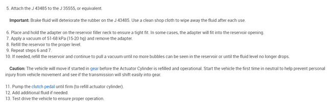

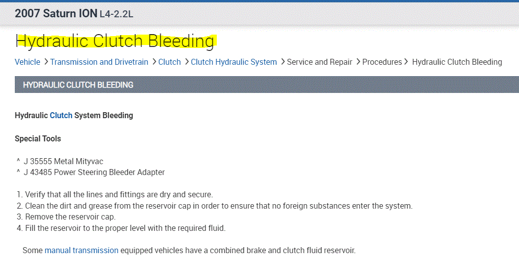

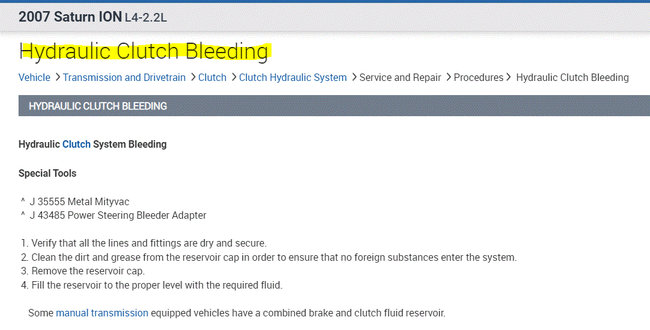

Was everything working properly before the clutch pedal failed? Also, I attached the manufacturer's directions below for bleeding. Take a look through them and see if you missed anything.
See pics below.
