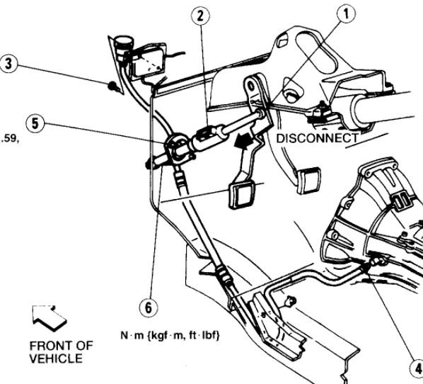

Unfortunately the only thing I can think of that could possibly cause your clutch to slip that wouldn't involve removing the transmission would be the clutch pedal itself not allowing the throw-out bearing to fully disengage from the pressure plate. if you have some play when the clutch pedal it at the top of it's travel then you are left with the only option being to remove the transmission to repair the problem since you have to remove it to even to replace the slave cylinder. I have attached a diagram on the clutch pedal system, if your pedal is holding the slave cylinder from releasing when you when you remove the linkage from your pedal (1) it will not line back up without pushing it in.
