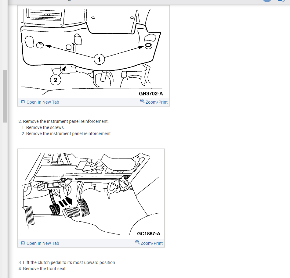

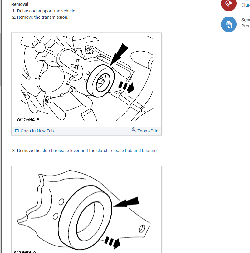

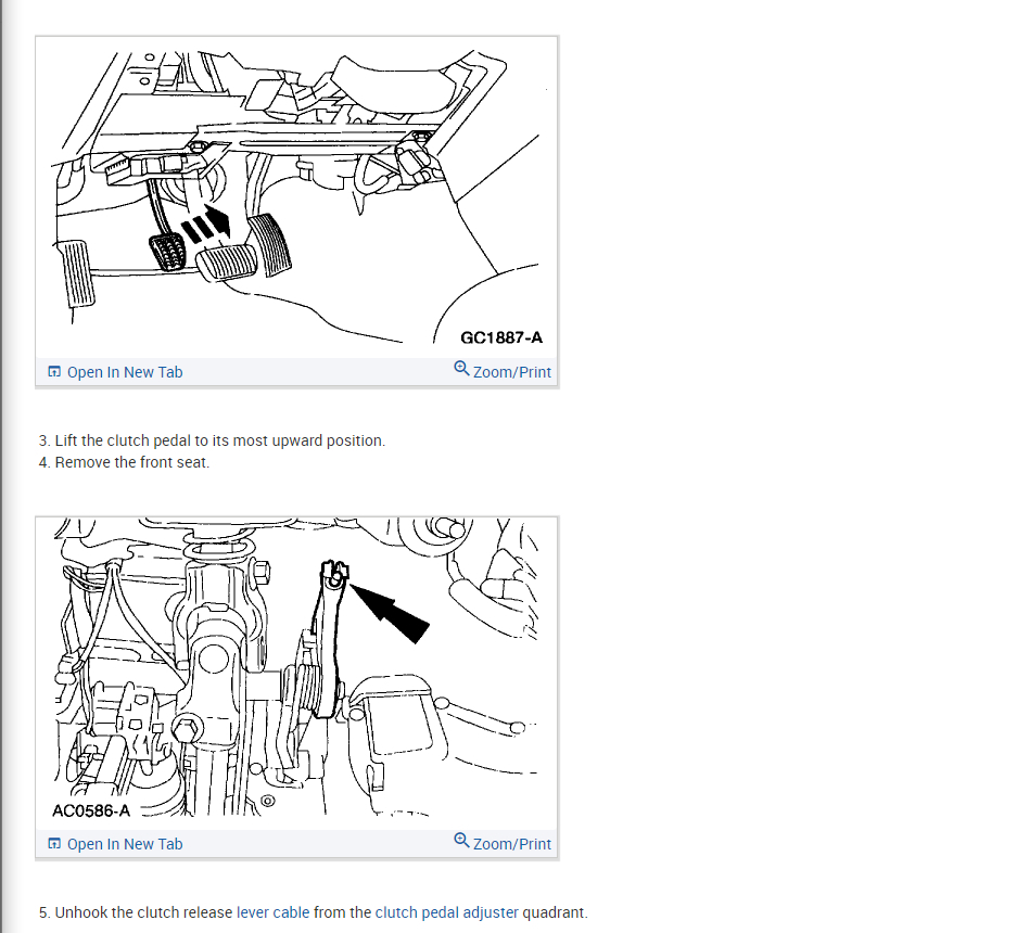

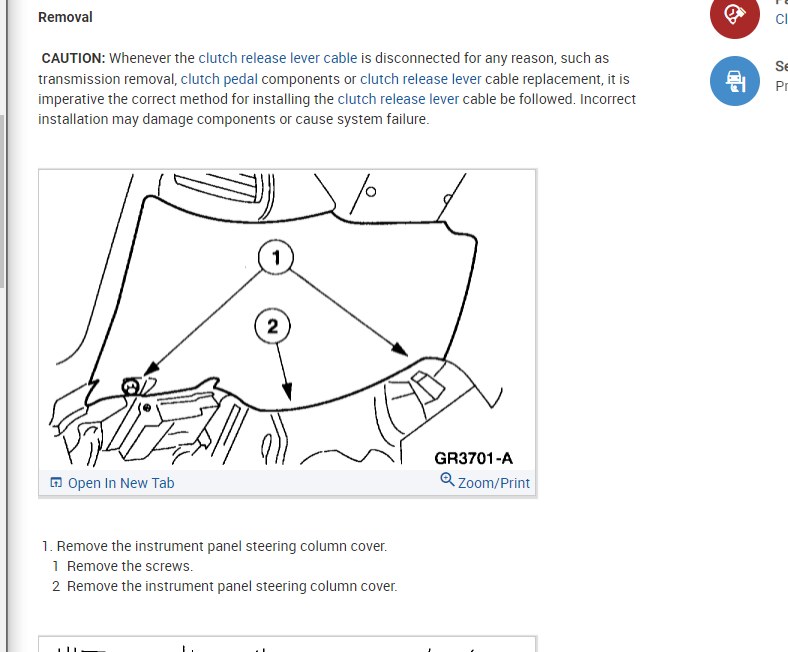

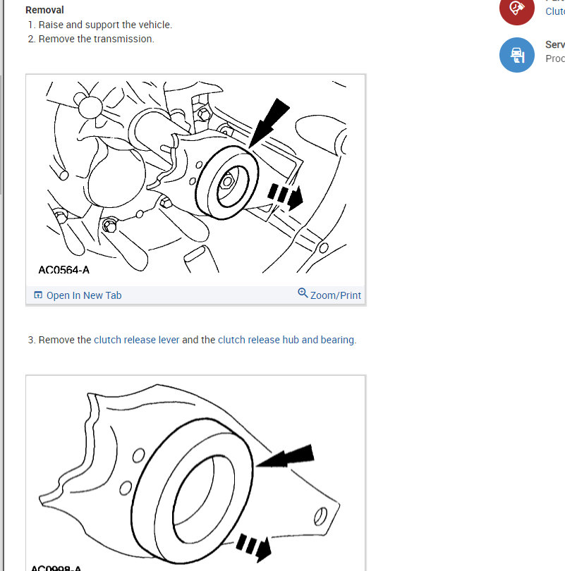

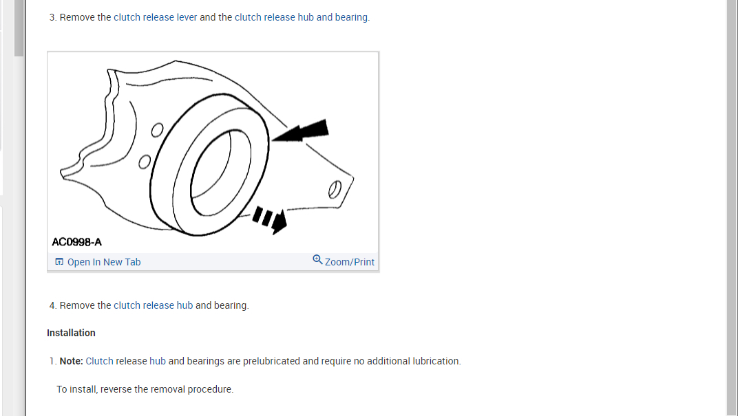

I attached the process below from the manual on this so let's run through this and see what turns up.
