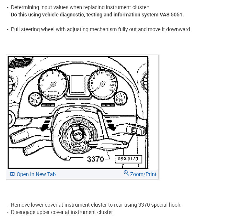

I have never been able to set clocks from purchase. Intermittent problems with temperature gauge, fuel gauge, ABS, and traction control. It was put on a diagnostic machine indicated possible clock problem. Replaced clocks but they needed coded so put old ones back on since put back diagnostic machine it doesn't communicate. so, can someone help, please?
Jul 23, 2022 at 4:11 AM
If the instrument cluster is bad, it can cause all of these issues but to be sure we need to do a CAN scan which is easy to do. You can get a CAN scanner from Amazon for about $30.00. Here is a video to show you how:
https://youtu.be/u-4syLc-ifQ
Here is a scanner link:
https://amzn.to/3o41KcZ

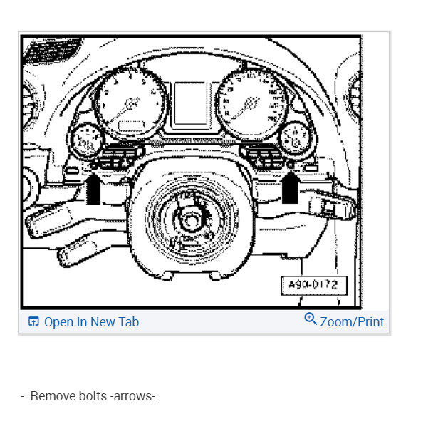

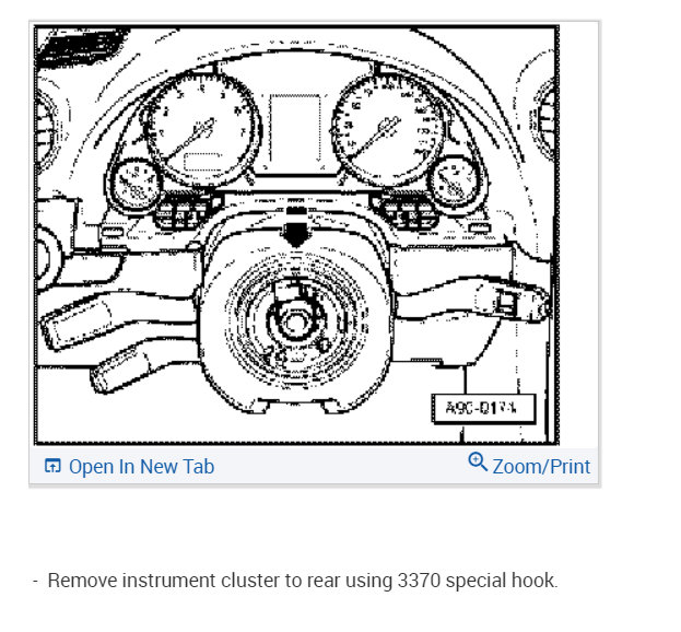

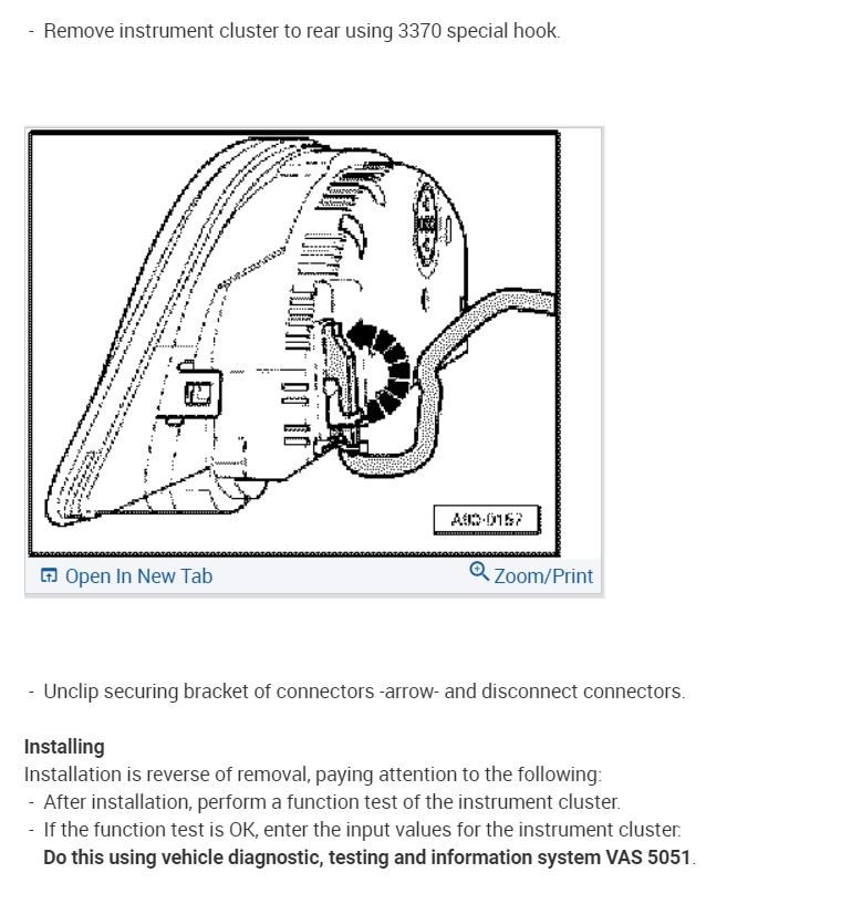

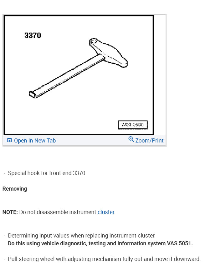

If the cluster does come back as bad, here are the instructions in the diagrams below to change it out. You can get a rebuilt unit online like ebay, etc.
