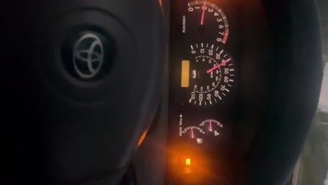

Replacing the entire cluster can be expensive. Therefore, we need to confirm that it is the problem. What I recommend is to scan the can-bus system to determine if there are any codes stored that are related to the cluster.
The different control modules are tied together via a few wires. CAN stands for Controller Area Network. This type of scan will retrieve codes regardless of which module has codes set.
Based on how it is acting, my first thought is a wiring issue or a connector. It won't be a fuse or fusible link because if they fail, they won't work again. Also, metal expands when it gets warm. It will likely be warmer at the end of the work day, and it may be enough to make a better connection. So, check to make sure the connector at the rear of the cluster is tight and in good condition. Disconnect it and see if there is any corrosion or damaged connector pins.
