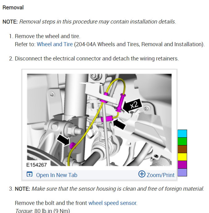

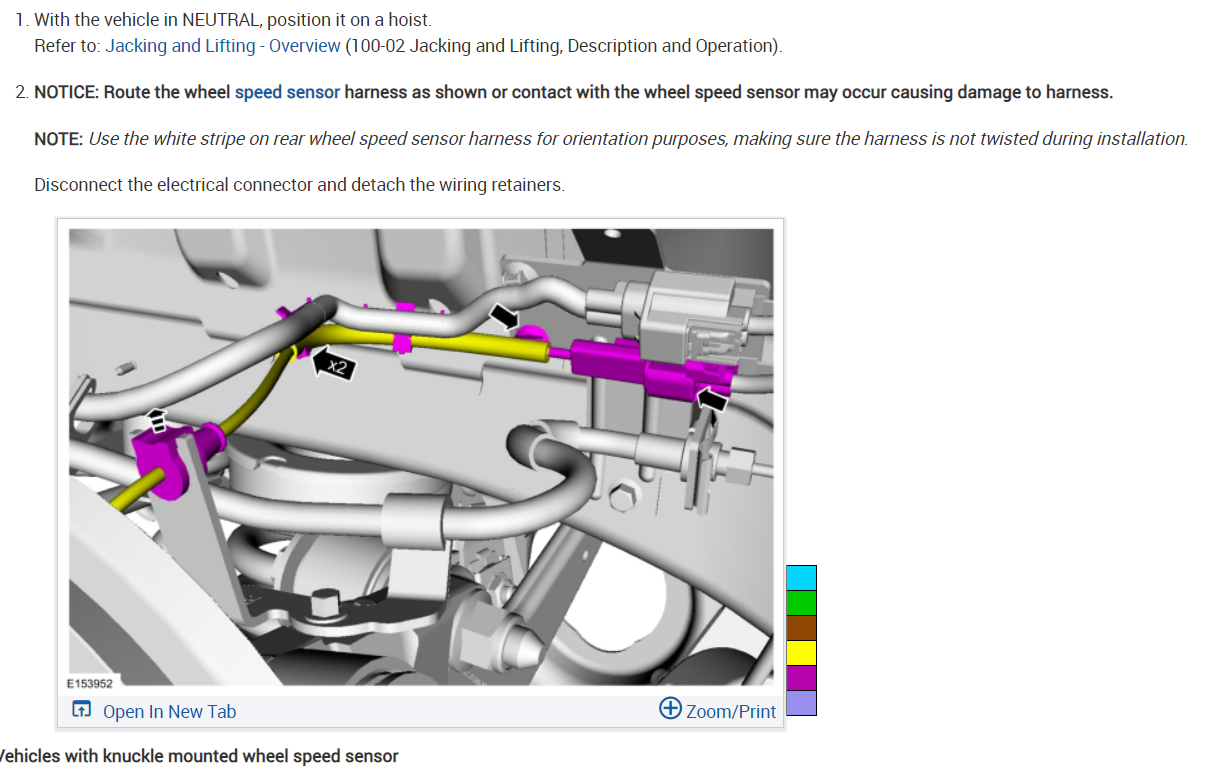

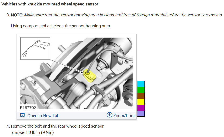

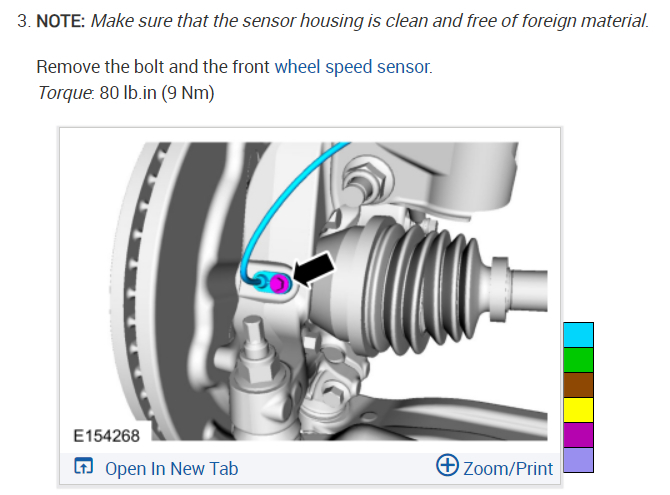

It sounds like you pulled out the wiring or disconnected an ABS wheel speed sensor. I would raise the front of the car up and look at the leads for the ABS wheel speed sensors to make sure they are connected here are the locations.
This guide can help:
Also, if the sensors are in good shape let's run the ABS codes by following this guide:
https://www.2carpros.com/articles/anti-lock-system-testing-and-repair-abs
Here are the locations for the sensors, front and rear, check out the images (below). Please upload pictures or videos in your response to any problems so we can see what to help you with.
