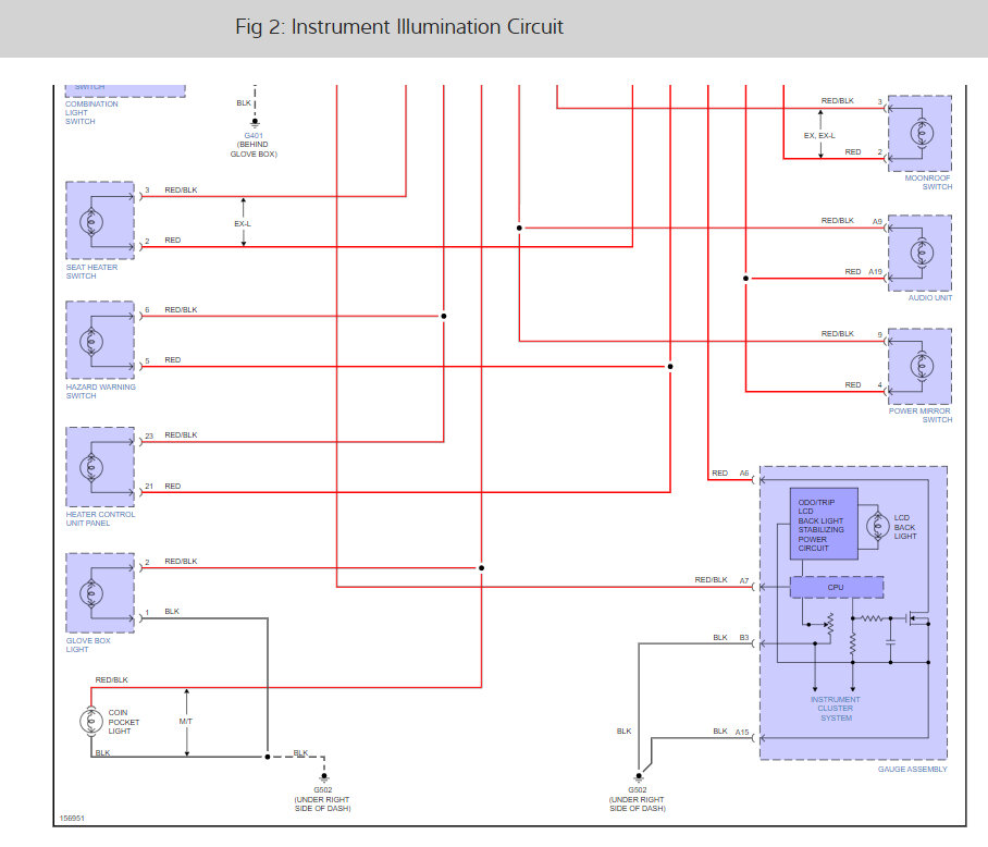

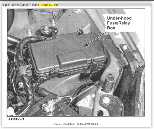

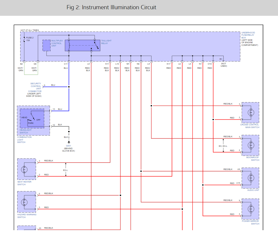

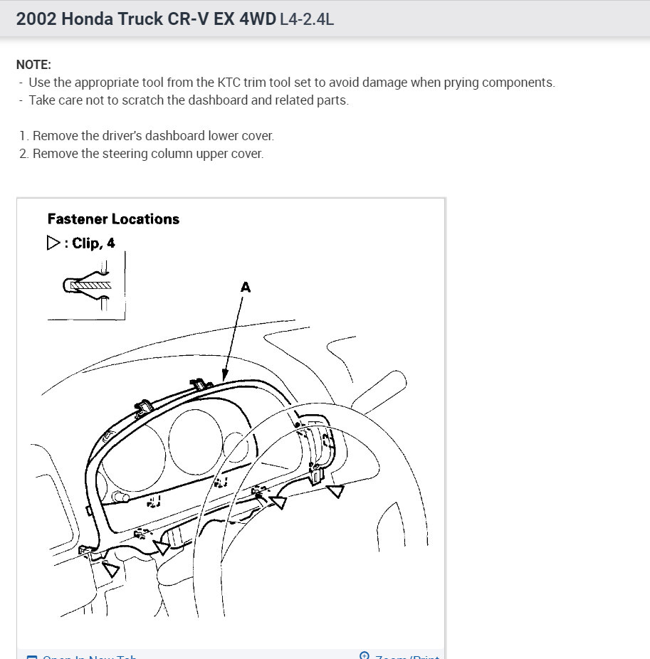

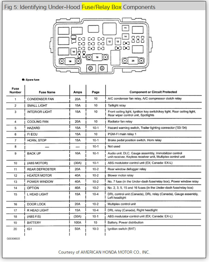

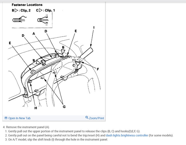

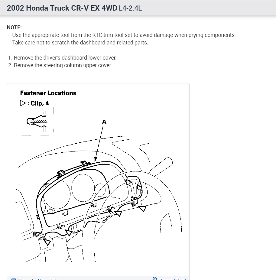

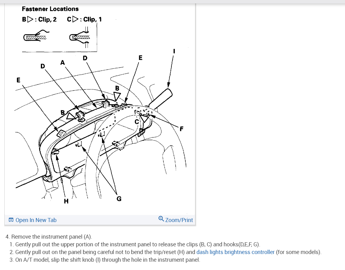

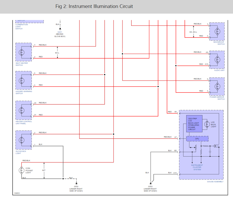

There is a CPU inside the instrument cluster that sounds like it is out, you can get a rebuilt cluster by searching google or eBay but I would check the fuse # 2 in the under hood fuse panel, here is a wiring diagram for the lighting system for the cluster in the images below and how to change out the cluster. Please let us know what you find.
