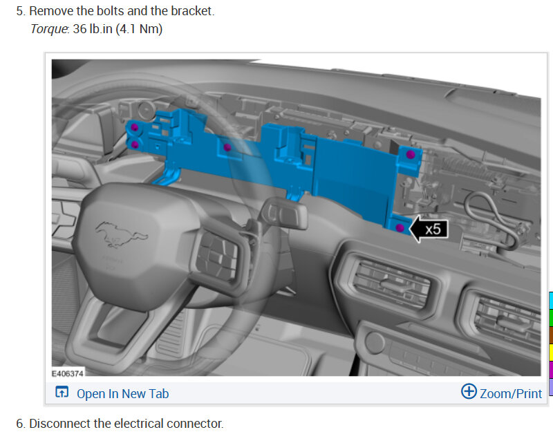

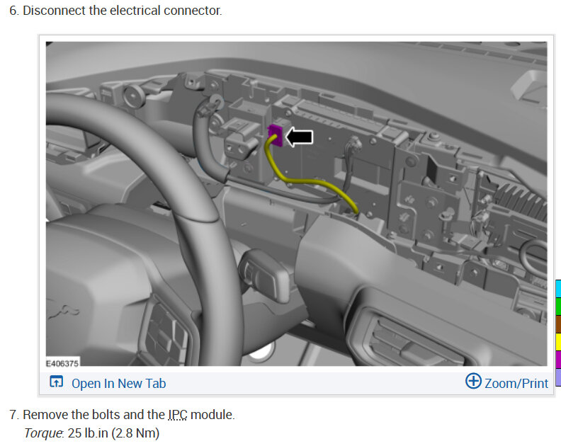

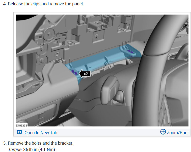

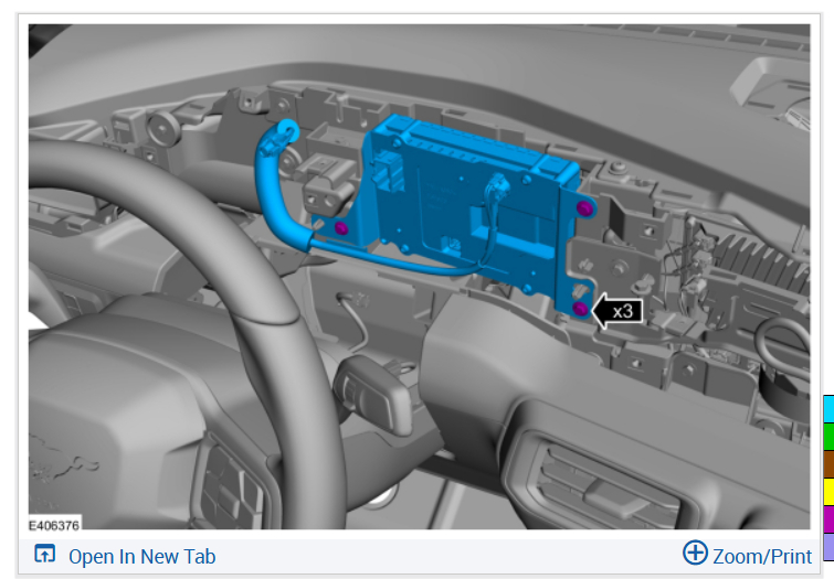

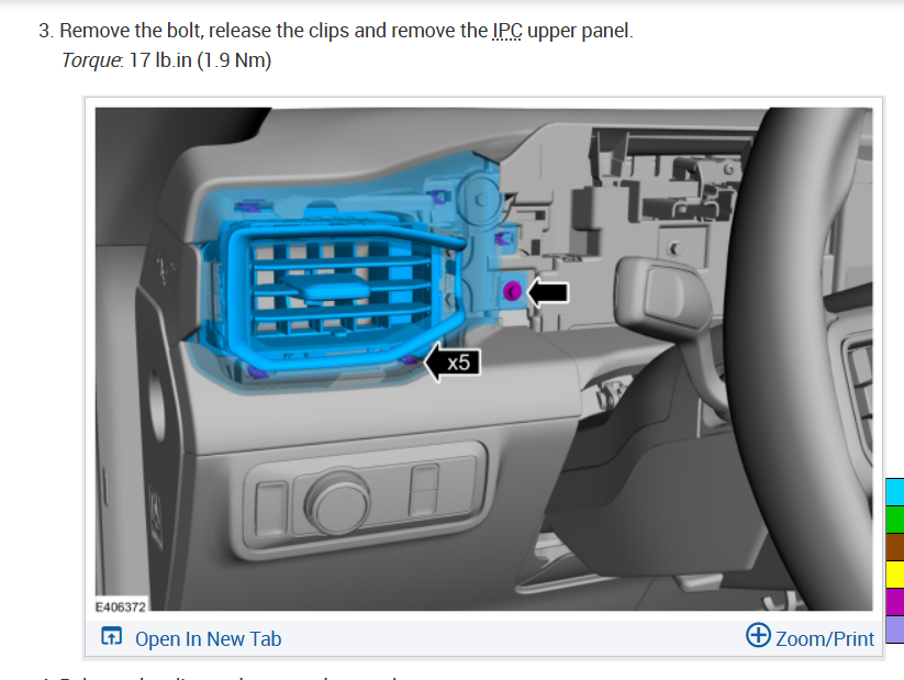

Here are the instructions on how to remove the instrument cluster, you will need to disconnect the 12 volts battery before you begin. Please check out the images below and I will email them to you as well.
To install, reverse the removal procedure.
NOTE: This step is only required if installing a new module.
Using a diagnostic scan tool, complete the PMI process for the IPC module following the on-screen instructions.
Using a diagnostic scan tool, complete the FDRS Module Configuration process for the new IPC module following the on-screen instructions. Check out the images (below). Let us know if you need anything else.
