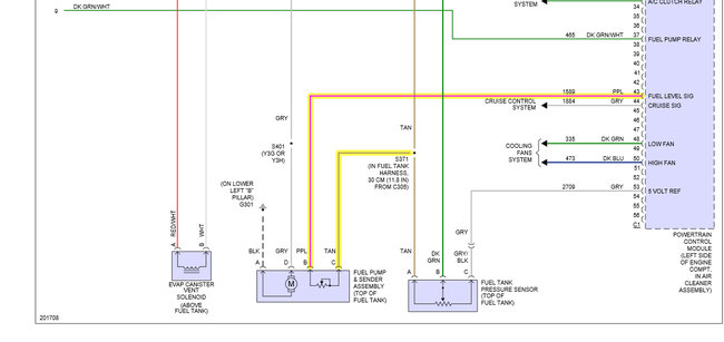

when fuel is empty gauge still shows there is fuel in the tank.
Oct 10, 2016 at 3:28 AM
AL514
  • 5,464 POSTS

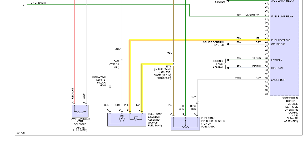

the diagnostic start on this would be to check for DTCodes, there is a code for the sending unit, is the check engine light on? The gauge is controlled by the float in the gas tank. I would start at the tank with the float/sending unit. With a multi-meter check the resistance of the unit while moving the float up and down. Considering all the information for the dash gauges is send on a data wire from the ECM and its only the fuel gauge acting up. Start at the tank, make sure the ground wire has low resistance also. Here is a wiring diagram to help (wires are highlighted in yellow). I have seen many sending units in the tank go bad. Hope this helps.
