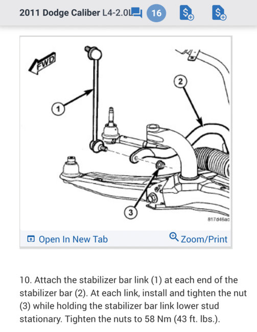

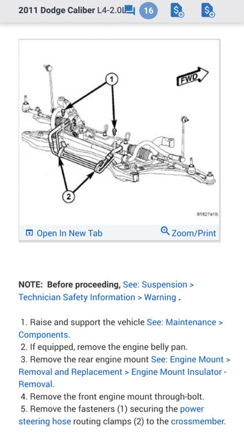

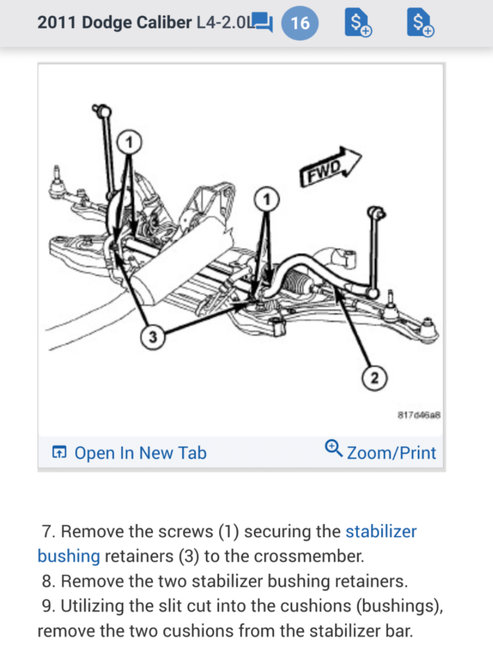

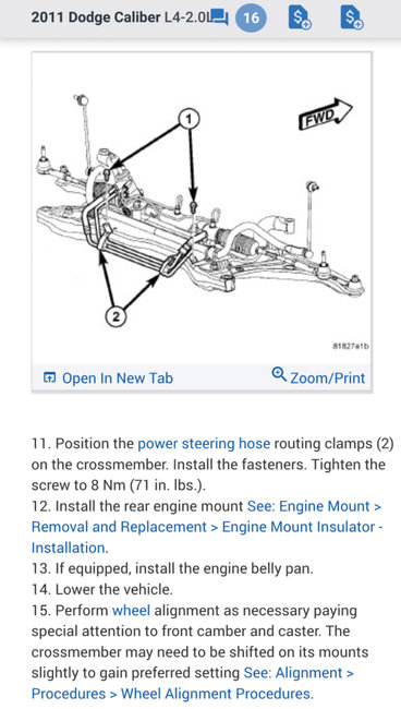

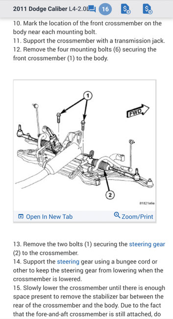

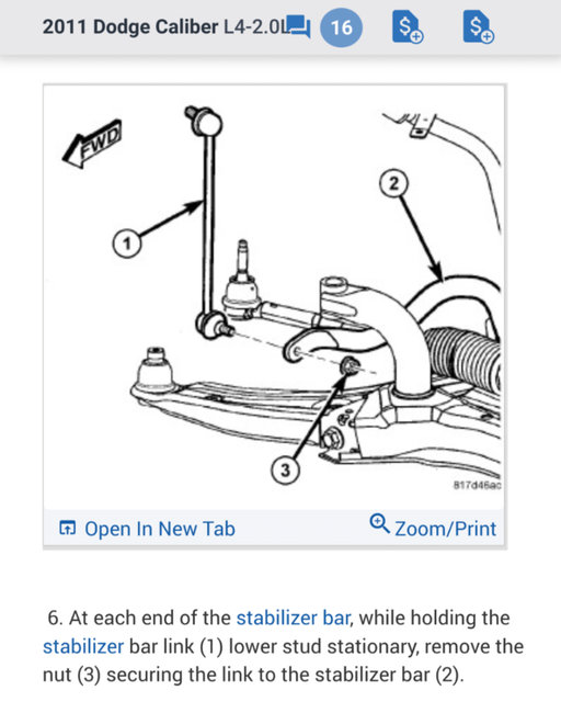

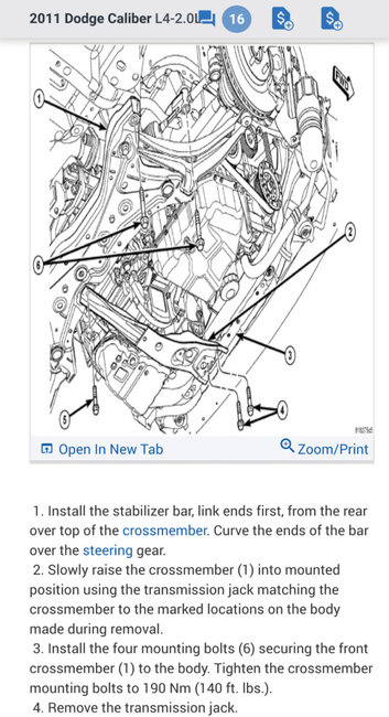

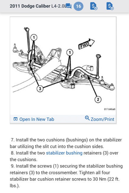

Hello. The best I could do was to find the instructions on replacing the stabilizer bar, which includes steps removing and reinstalling the bushings. It's a fairly straightforward job to do, so I suspect that you can do it.
Good luck and let us know how it goes.

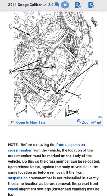

From what i'm seeing, figure it, this whole removal step of cross member isn't needed, can can easily access the four bolts themselves (bushing bolt}?
May 22, 2021 at 8:40 AM
HARRY P
  • 2,292 POSTS
Yeah, I think you're right. I don't see why that cross member has to go anywhere for just the bushings.

Hey guys, all's well and good. Got the mount changed with the normal busted knuckles. Wanted to change the sway bar bushings but can't even get good access to the bolts. My local mechanic will have to do it, the subframe needs to be loosened to do it. As always, thanks for being there.
