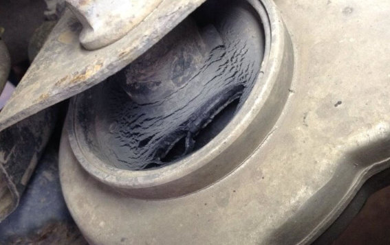

Yep. That is a bushing that is worn out. That deep thumping is the play between the different components and it sounds like a dampened or dead thump. Not a metal on metal because there is still rubber in between the two pieces of metal. Given enough time it will be more of a metallic snapping.
Problem is, there is no real way to tell you which bushing. Could be a mount or a suspension component or one in the steering system. Basically just climb under there and any bushing that looks cracked or worn needs to be replaced.
I attached a picture of a cracked bushing. Just do a google search for more examples. Again, anything questionable should be replaced.
