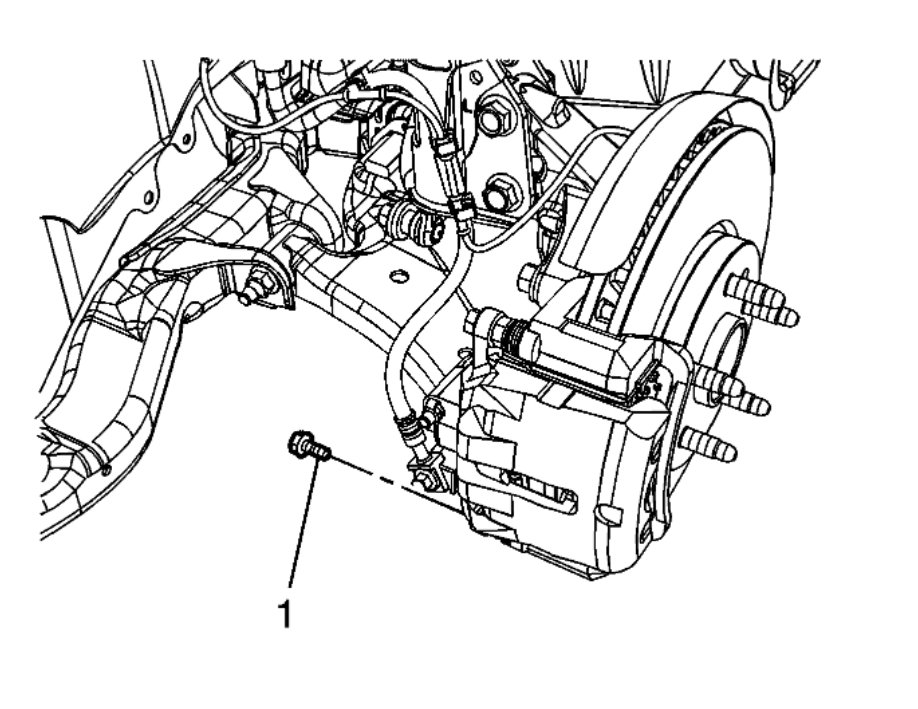

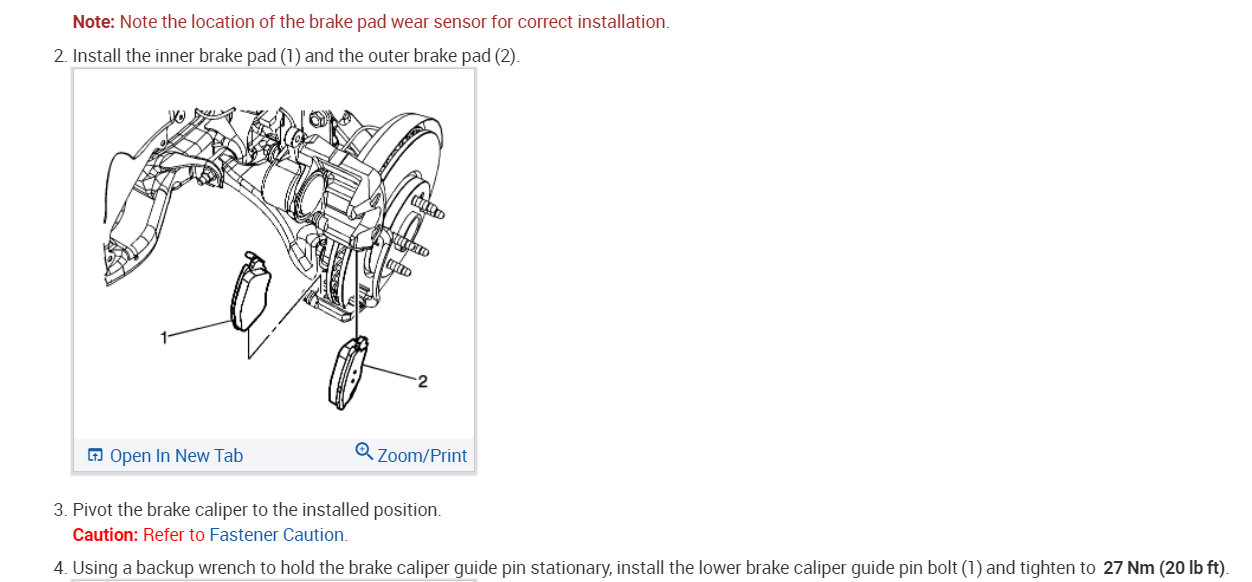

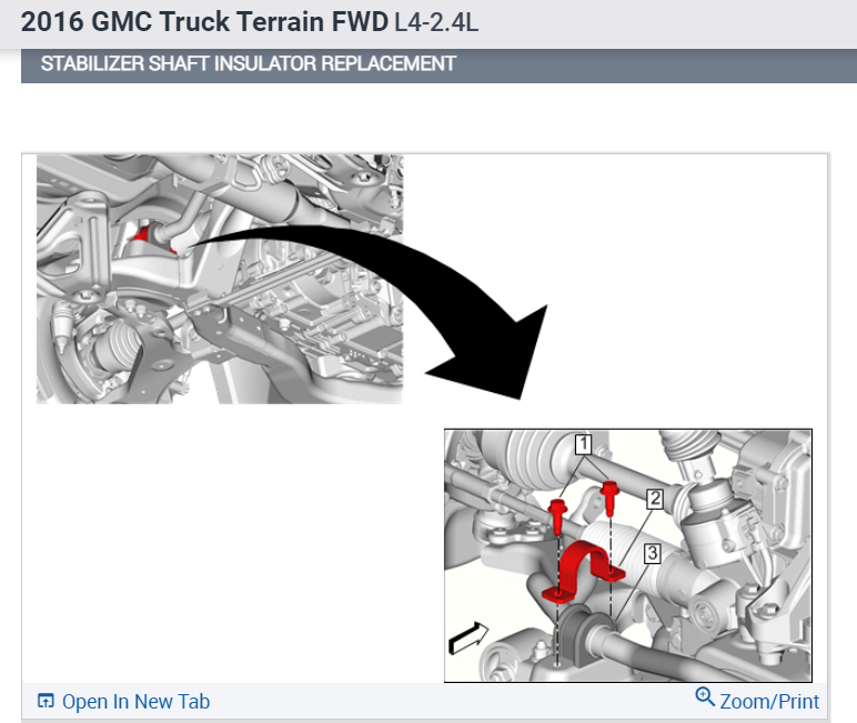

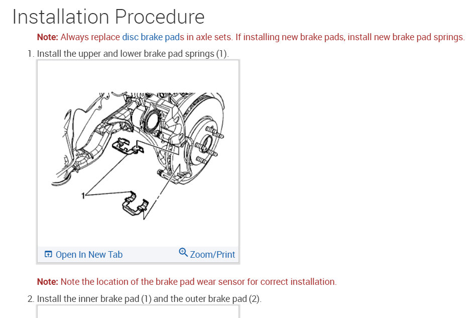

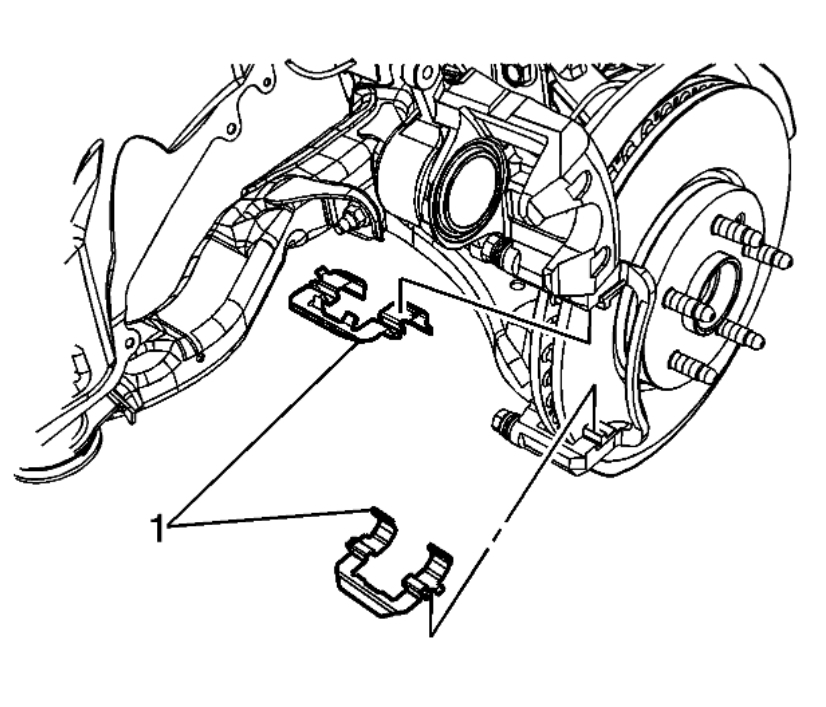

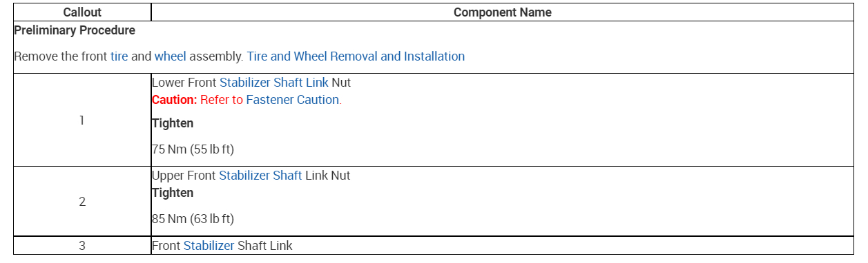

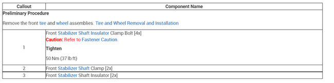

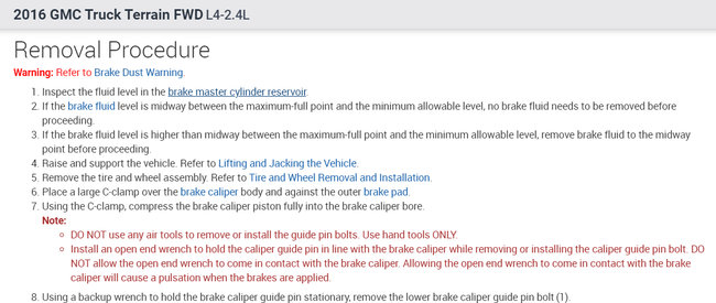

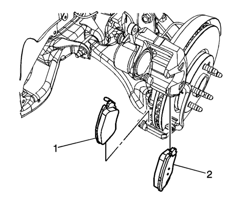

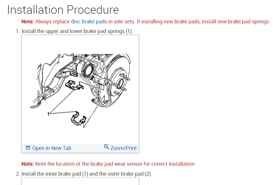

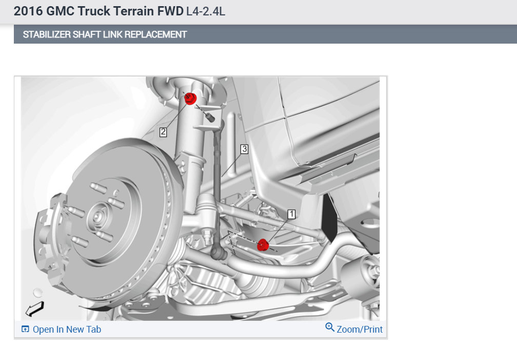

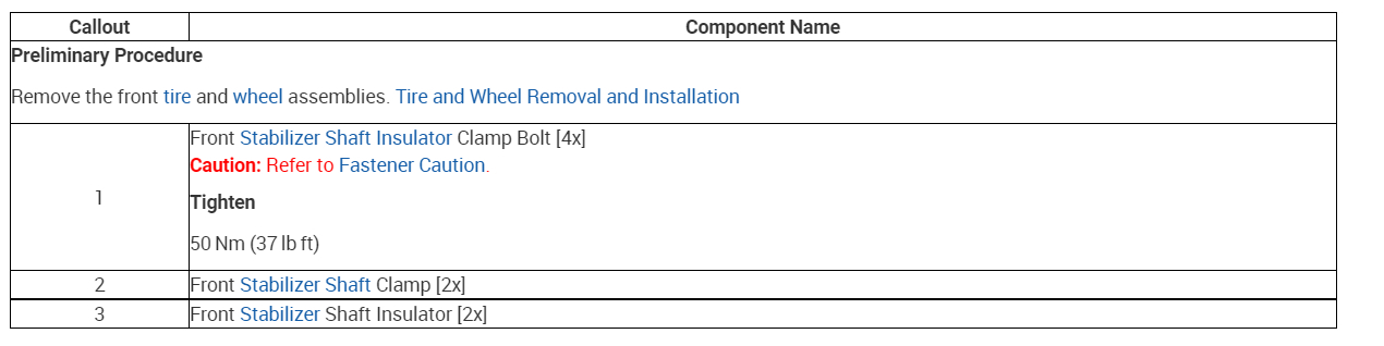

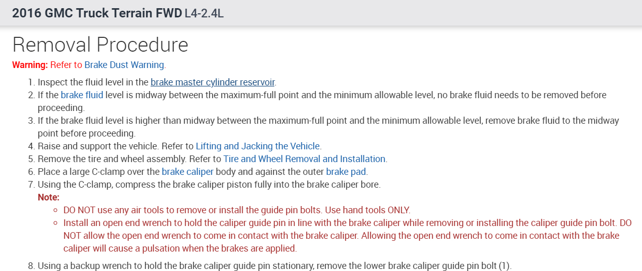

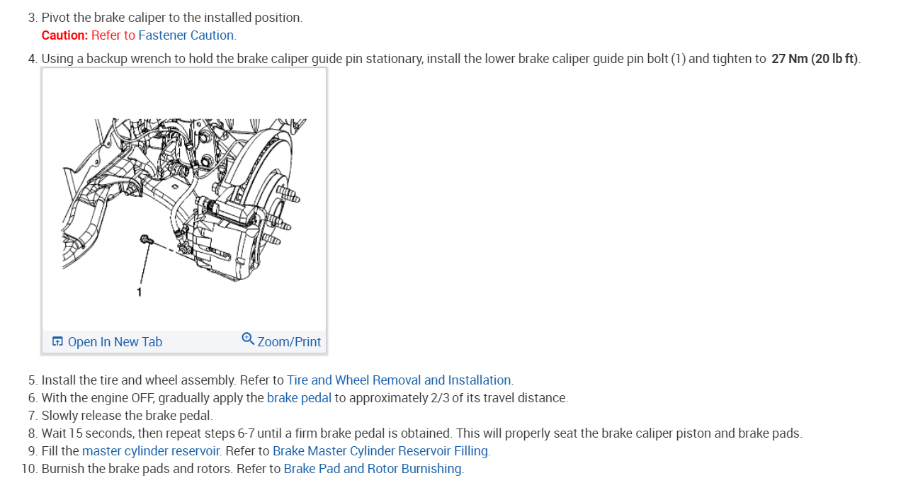

You could have a loose front brake caliper that is causing the issue but to be sure you can upload a video of the noise with your response. You can use your phone and upload it directly, that way we can know for sure what's going on. Also, a sway bar link or fame mount can cause this noise as well. Here is how to do the front brakes which includes the caliper, and the sway bar mounts and links in the diagrams below. Check out the diagrams (below). Let us know what happens and please upload pictures or videos of the problem.
