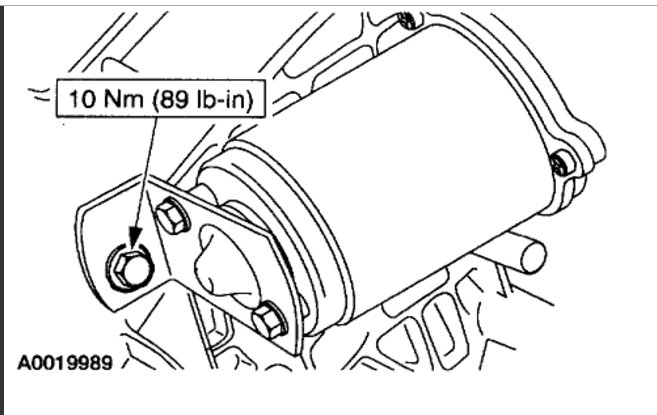

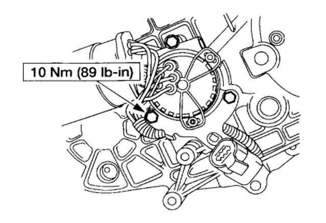

It sounds like you have a transfer case mode actuator that is out. Here is a guide that will help you remove and replace it.
You may need to jack the car up first.
Please let us know what happens, we are interested to see what it is.
