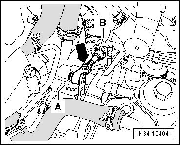

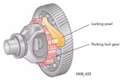

That description sounds like the pawl in the DSG is worn and skipping teeth on the locking gear or the cable that goes to the shift lever is stretched and not pulling the slide fully into engagement. It is a fully mechanical system inside the transmission.
The cable can be adjusted if it is the issue. However if the cable isn't the problem then the gearbox would need to be removed to access that part.
Adjusting
Loosen the adjusting bolt on the yoke.
Put the shift lever in Park.

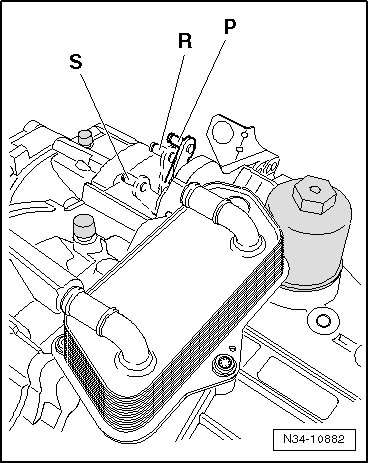

Move the selector lever on the transmission into the "P" position.
See image 3
The lever on the transmission must be pushed all the way to the rear.
- Pull the lever forward.
- Push the lever to the rear
Park is the second detent position.

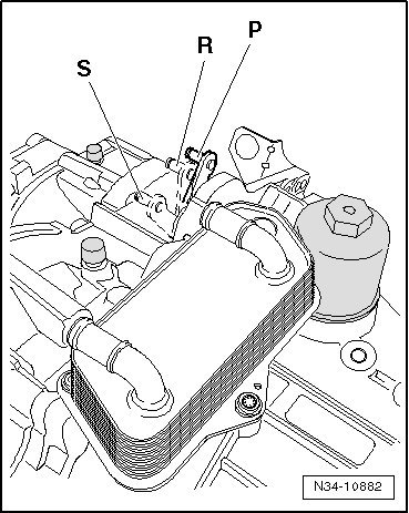

Make sure the transmission is actually in the "park" position.
See image 4
- Lightly tap the button in the handle forward and backward and make sure to keep the handle in the position "P" position.
This locates the cable core in its optimal position.
- Tighten the adjustment bolt marked with the arrow in image 4 to 13 Nm.
