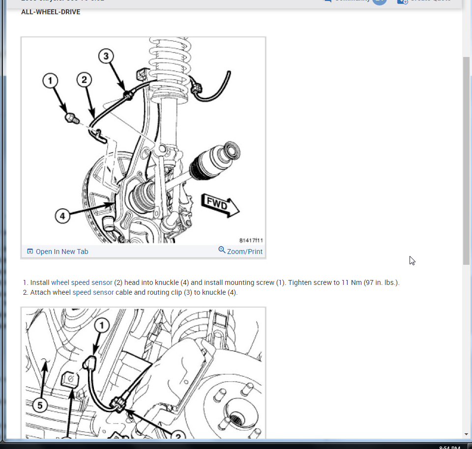

I checked all the brakes and the only thing I found wrong was a wheel sensor wiring broken so I need to replace it, right front please?

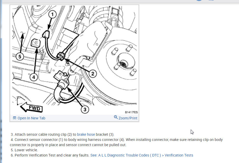

This guide will help with the replacement:
https://www.2carpros.com/articles/how-to-replace-an-abs-wheel-speed-sensor
Below is the process from the manual that will give the detail that you need to replace this.
Please let us know if you have other questions. Thanks
