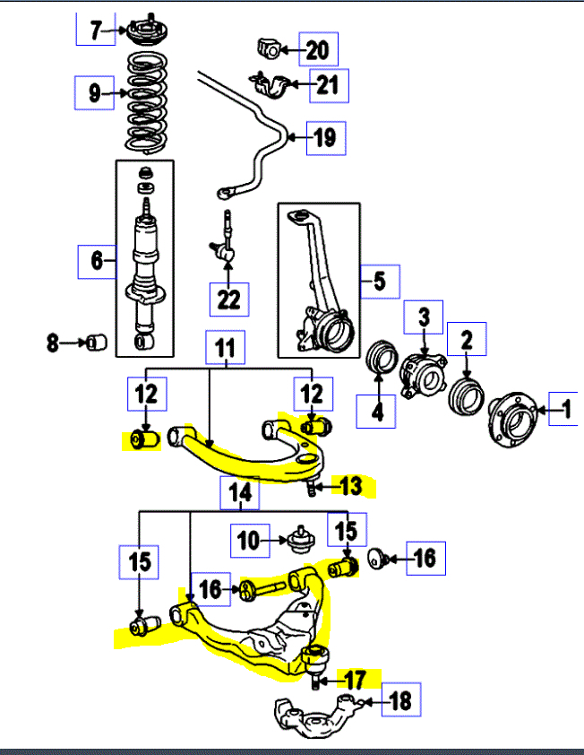

Just to start my truck has a three in lift/level with 33's.
I have a clunk type noise as I reverse and steer. In the last year I have replaced both CV axles, UCAs, outer tie rods, sway bars, stabilizer bushings, rear Leafs, LCAs, and both front struts. I actually had to replace the Passenger side CV again about a month ago. After all this front end work you would think I would finally have a smooth ride but that's not the case. Besides the noticeable clunk as I turn, reverse, and park the truck.... There is vibration and overall shimmy at higher speeds. As well as excessive tire wear on two (right side tires). I have checked and found quite a bit of play in my center support (carrier) bearing and will be tearing down and replacing that as well as all 3 u joints this week. I'm at a loss as to what else to replace or check on this truck. I bought it with 90,000 miles on it and has never seemed to have a smooth feel when driven.
