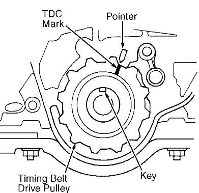

After replacing cylinder head gasket and resetting TDC at tension pulley for timing belt heard clucking sound because car would not idle when starting it

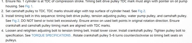

you have to set cam as well as tdc you may have bent valves now. instructions are for a 1.6L Check out the images (below). Let us know if you need anything else.
