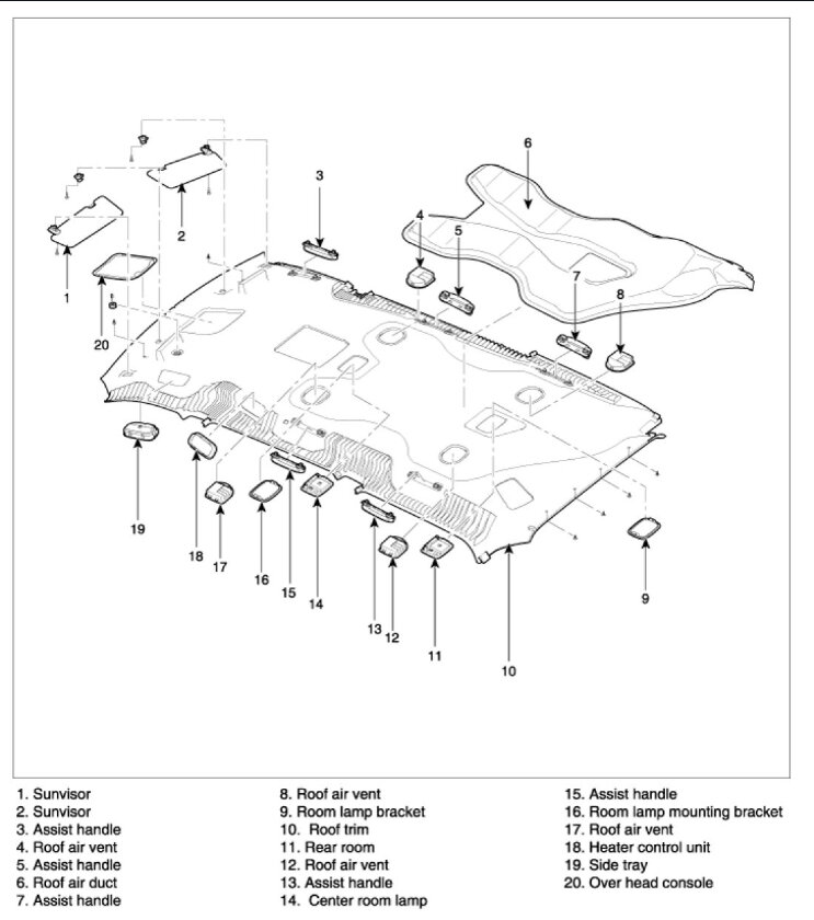

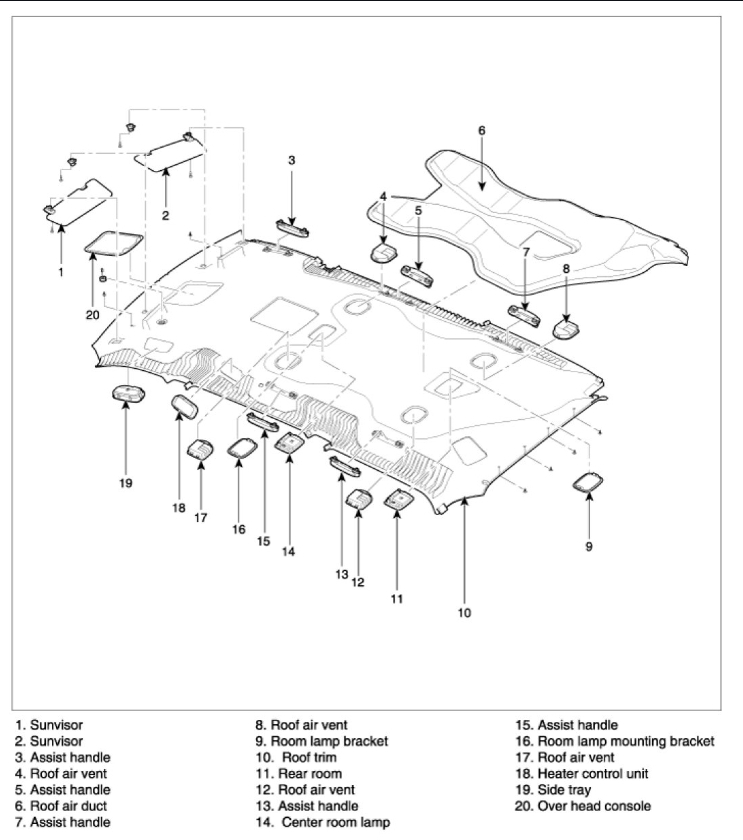

I have never heard of anything to pour down the sunroof drains to help unclog them, but I would be careful because it can cause damage to the paint etc. I would remove the headliner to access the drains. The removal will only take about an hour so you can clean the drains, but before you do open the sunroof completely to use compressed air to try to blow any dirt or debris from the drain openings. Check out the images (below). Let us know what happens and please upload pictures or videos of the problem so we can see what's going on.
