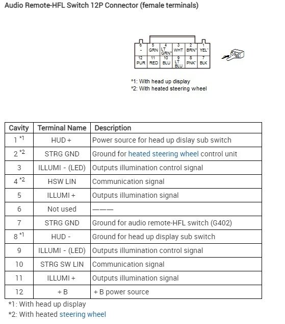

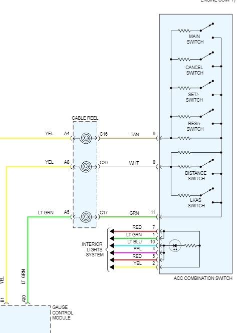

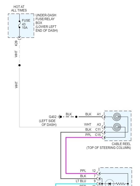

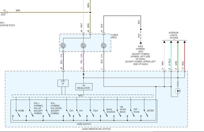

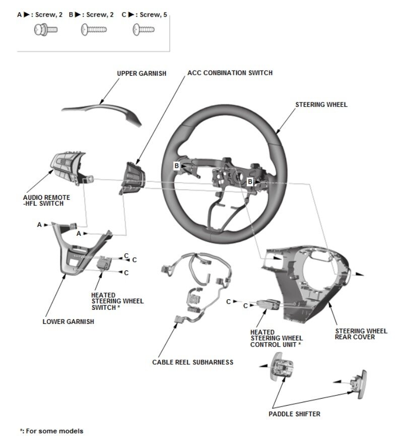

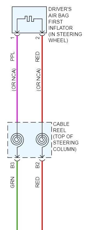

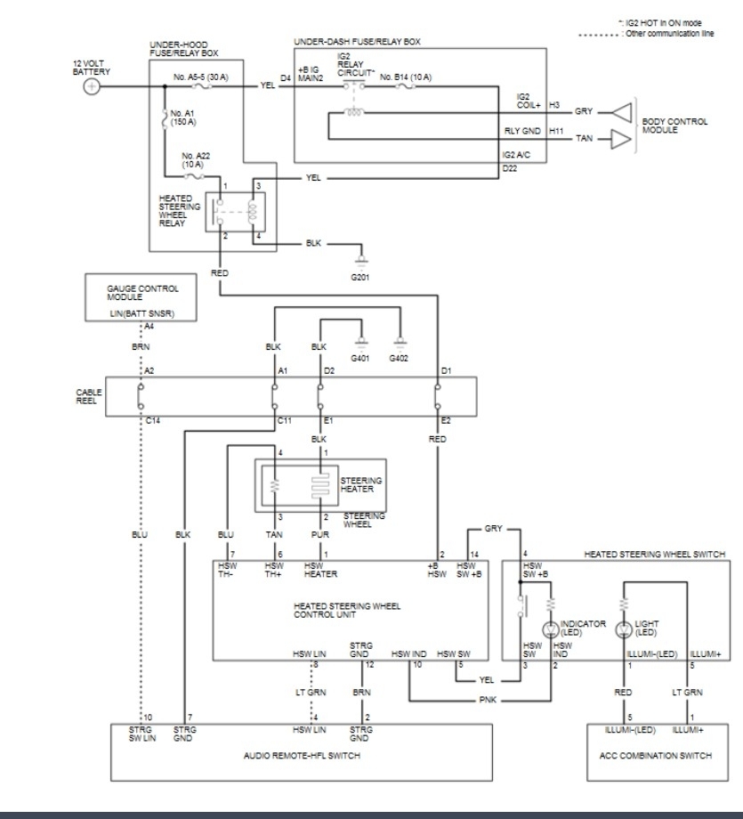

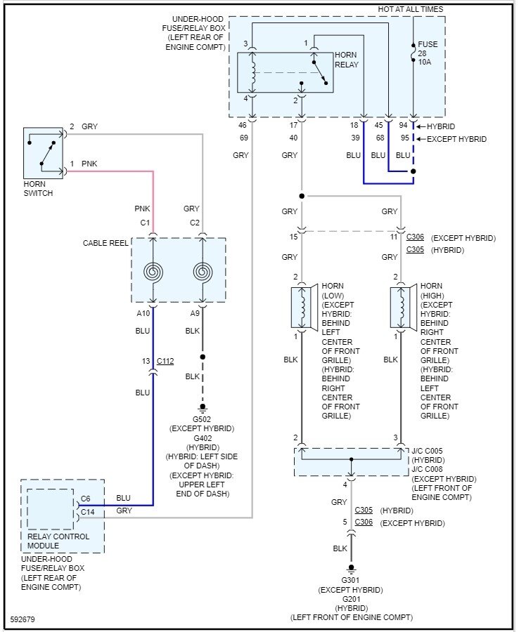

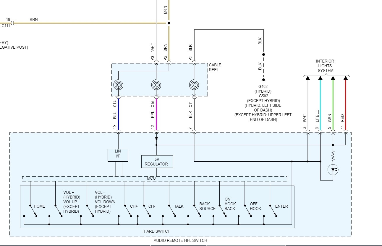

It appears they don't use a single diagram for this as each system has its own with overlap for other systems. Attached are the ones they show for the various systems. Be very careful with that wiring though as the air bag wiring is there along with powers and grounds that could cause it to detonate if they are bridged. If you are thinking of using the audio or shift controls for other items, they are not really usable as they are all run into a module in the steering wheel and converted to digital signals with the audio, shifting and more all on the LIN network and it's easy to cause issues on that network.

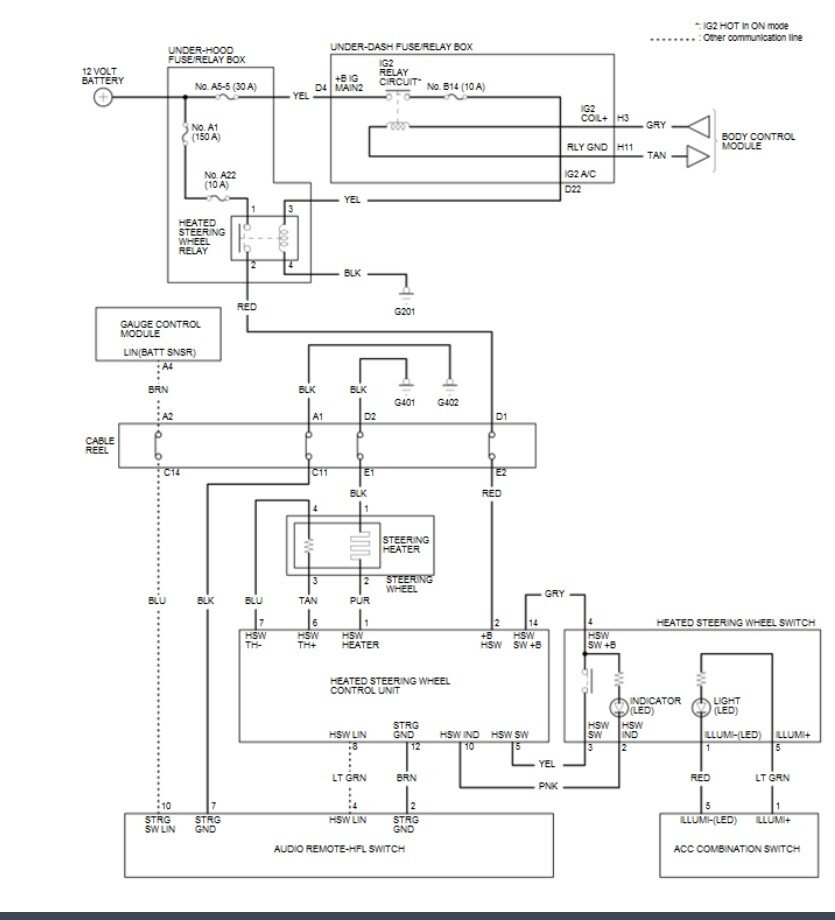

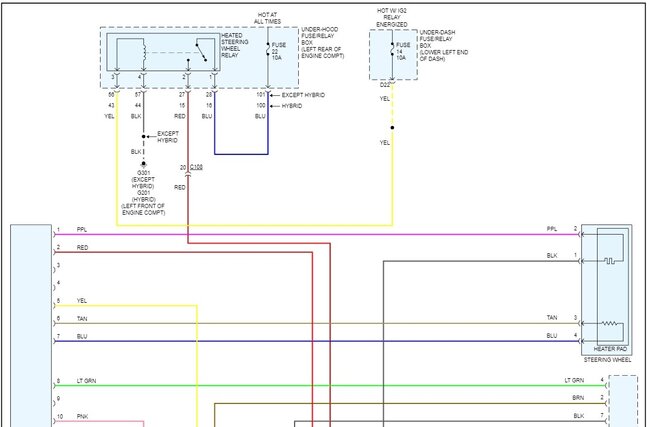

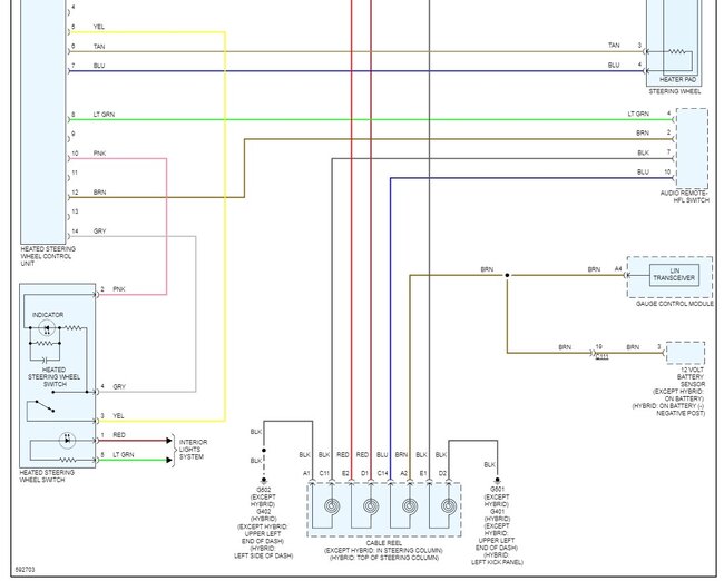

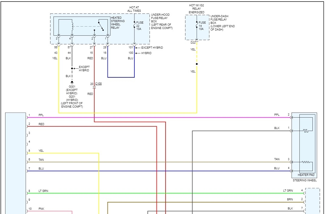

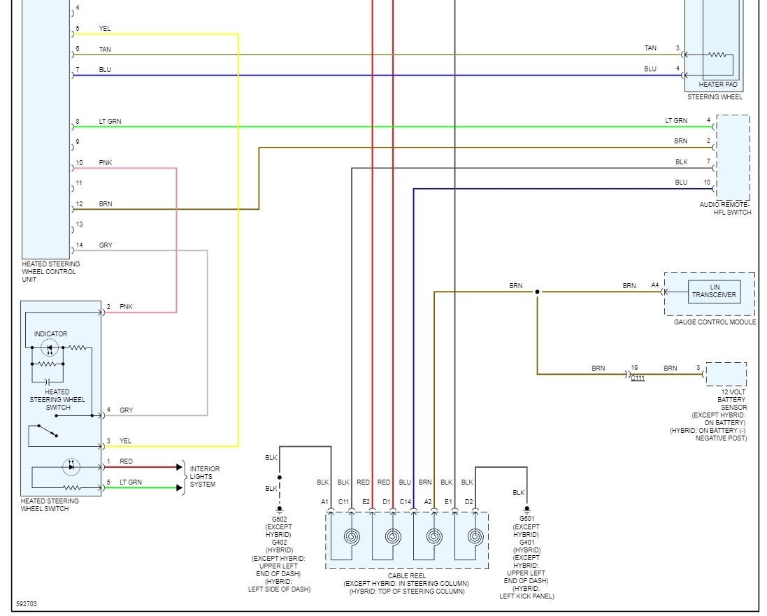

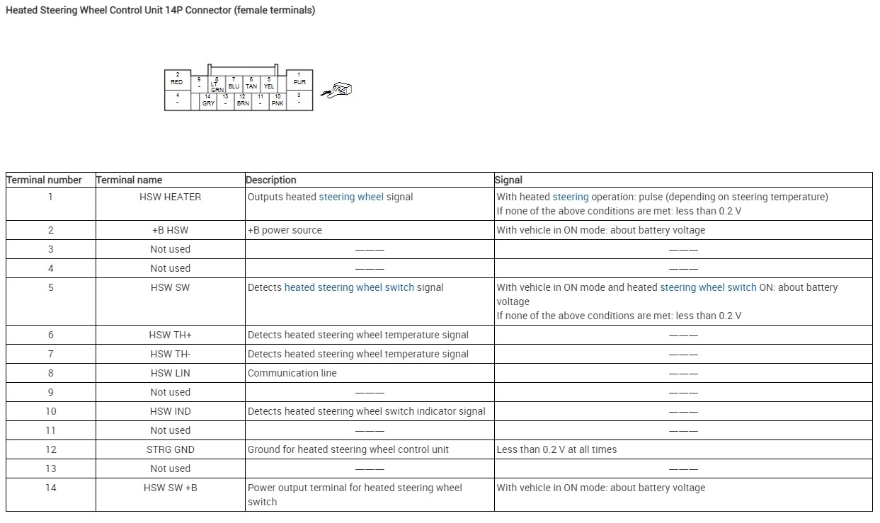

Okay, they did offer a heated steering wheel as an option. These are the wiring for that option. Perhaps that will help.

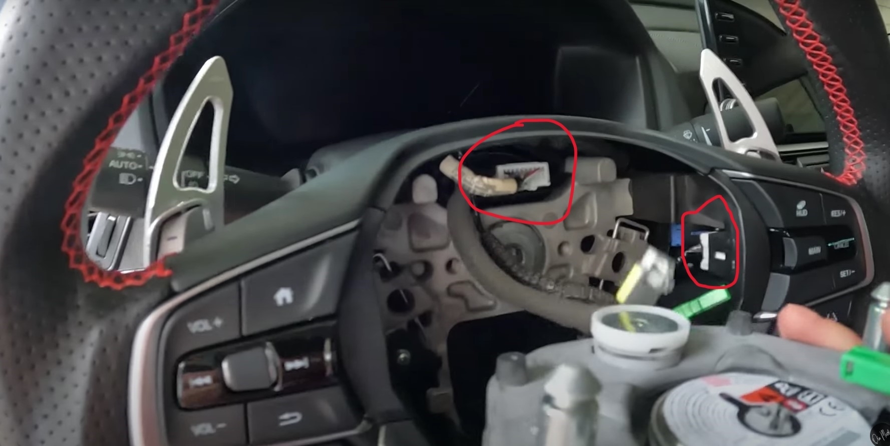

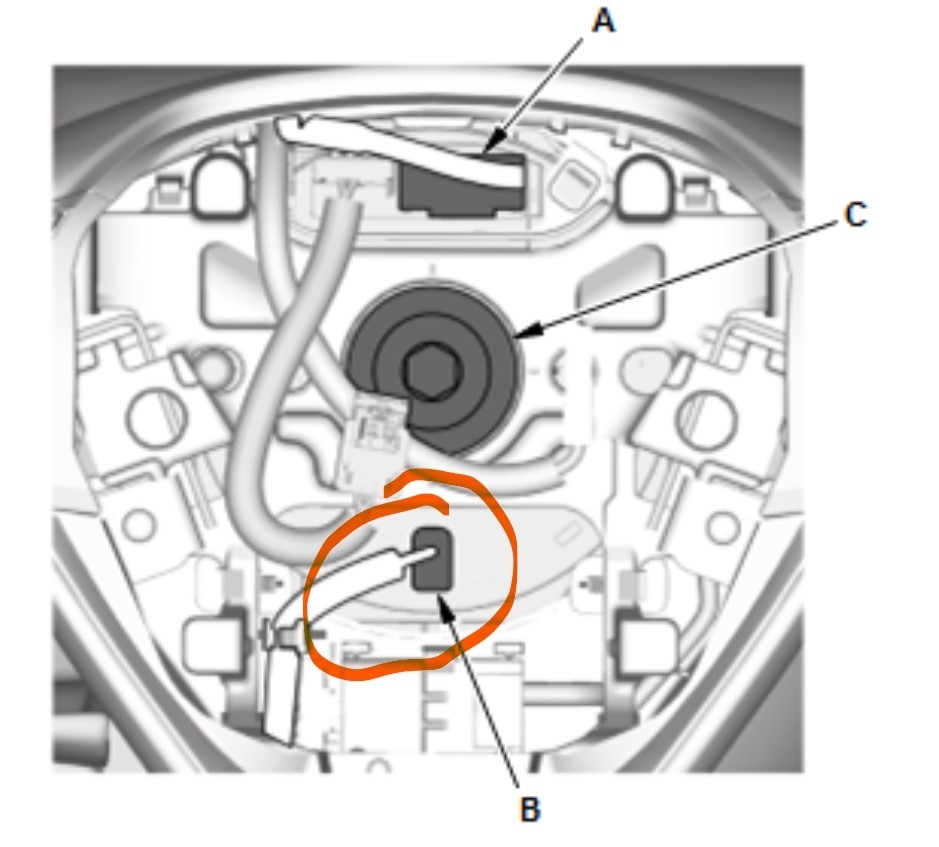

My 2018 model did not come with a heated steering wheel, that option is sold separately by replacing the whole wheel. My question is, can I tap into a constant 12v supply to power a 3-amp heating element in the regular wheel model. Here is a picture of my wheel, I circled the possible locations in red, can you clarify which of your diagram corresponds to the connectors that I circled.

There is a different harness in the wheel when it has the heated wheel, and it uses a different connector that goes to the wheel heater control module. They don't show them very well, but the wiring diagram shows that they are feeding the heater assembly with a 10-amp fuse through the heated wheel relay. That power goes through the red wire that is labelled as E2 and D1 in the colored diagram. It looks like the ground is through E1 and D2.

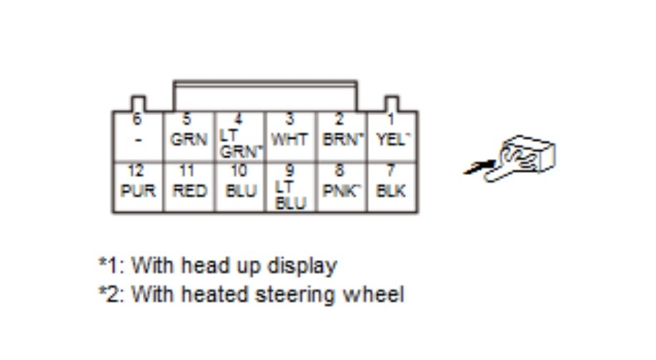

The heater relay may not be in place, however most companies run wires for options even if they don't install them. They just leave other bits out. In your case you don't have the heater or the relay, but the red power wire may still be installed. You just plug in the relay and now you would have power and ground up through the clock spring so that you could power the heaters you want to add. You need to get power through the clock spring, or you cannot connect the heater and the other power sources are not ones you want to use as they cannot carry the extra load. To get to the wiring you need to pull the steering wheel trim pad and get to the back of the connector you took a picture of. That power would be at pin 2 in the 14-pin connector. See the above post with the heated wheel circuit.

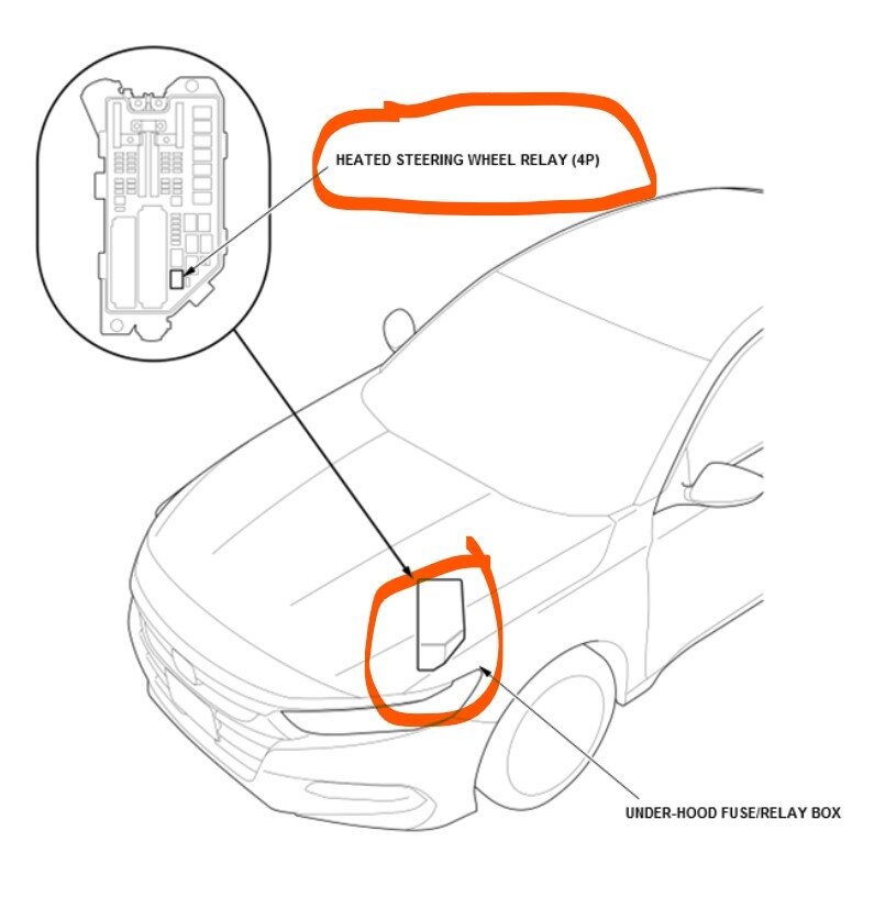

If you add the relay and test with a test light attached to ground to probe that wire, it should show power when the key is turned on. Then you could connect the red heater wire there and the black through the switch to the brown ground wire at pin 12 in that same connector. The relay is in the under-hood fuse box on the left of the engine bay.
With it plugged in, you should also feel it click on when you have someone turn the key on.
Then unplug the white connector you took a picture of, then see if you have the switched power at pin 2. Then you may need to add the contact into the white connector to get that power. Not a hard thing but you need the connector.
