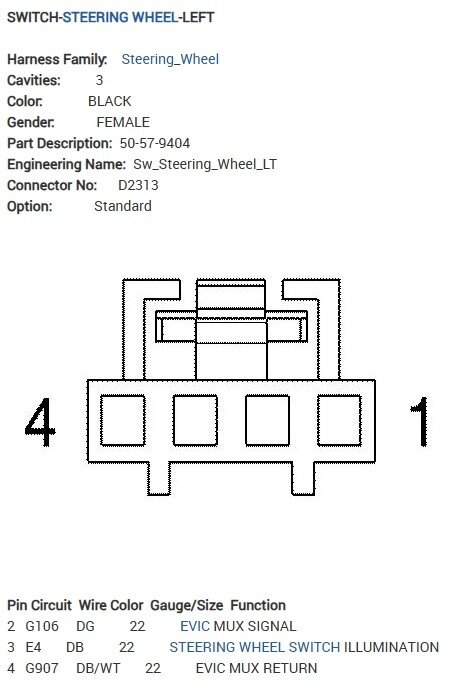

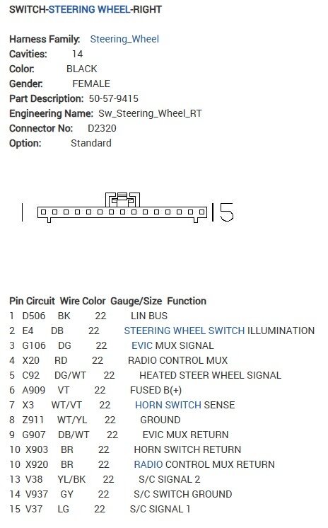

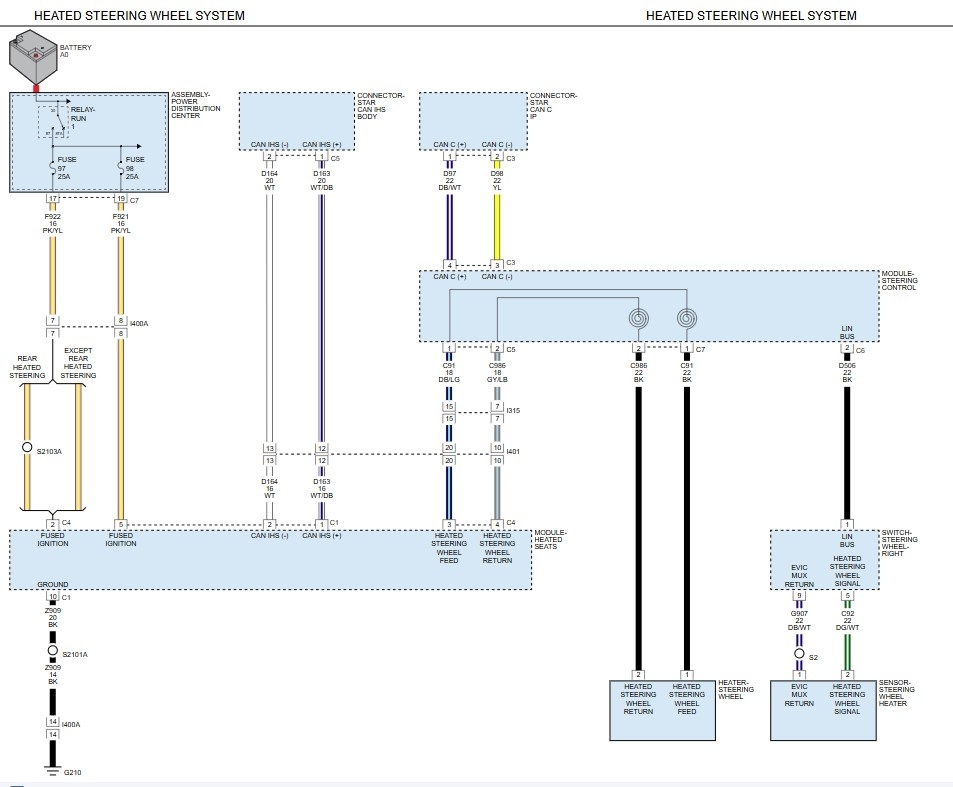

2 plugs wire colors are in what positions
Aug 29, 2025 at 5:01 PM
STEVE W.
  • 15,113 POSTS
There are multiple systems that go through there and more than 2 connections depending on which side of the clock spring you are working with. The attached are the connections for the steering wheel switches, the steering wheel heaters and an image of the connection locations.
