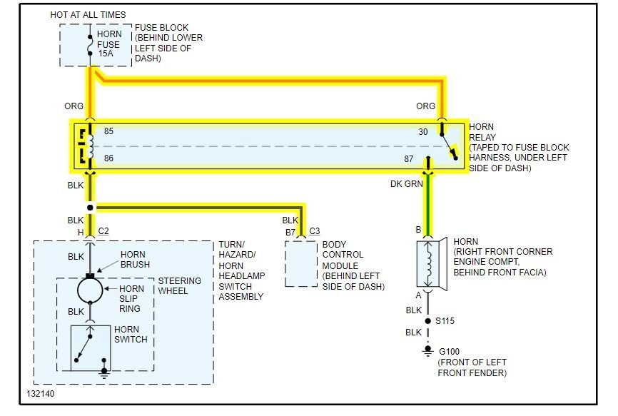

Horn started blowing on a really cold morning and will not stop. took out fuse and few days later replaced fuse and horn still blowing. When it happened i turned (locked) steering wheel and it would go off for a second. please help need inspection sticker.
Feb 18, 2021 at 1:16 PM (Merged)
Okay, I attached a wiring diagram for you to view.
You need to go to the relay and test for power. It sounds like the relay itself may be stuck closed.

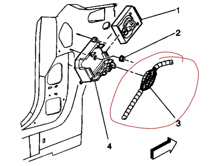

REMOVAL PROCEDURE
1. Release BCM wire harness retainer from the BCM bracket.

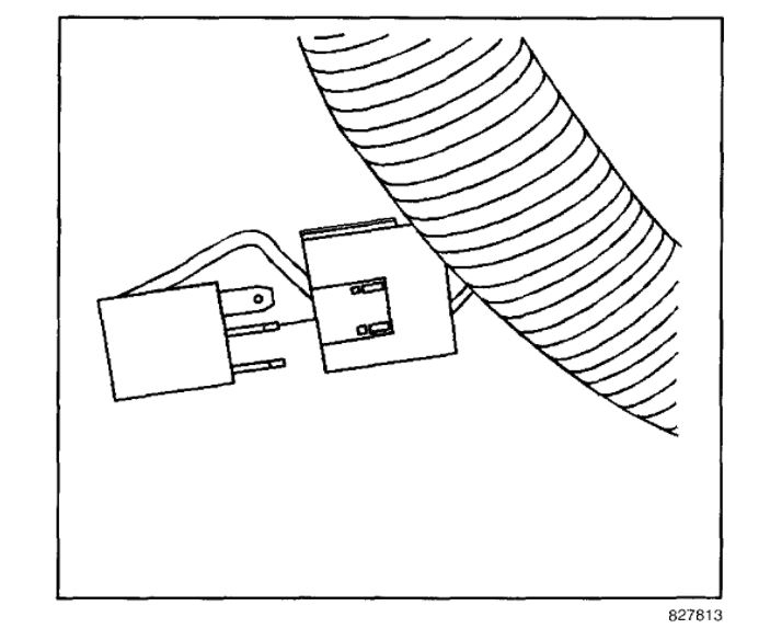

2. Remove the Horn Relay from relay socket on the back of the BCM wire harness.
INSTALLATION PROCEDURE
1. Install Horn Relay in to the relay socket on the back of the BCM wire harness.
2. Secure the BCM wire harness retainer to the BCM bracket.
BCM
REMOVAL PROCEDURE
CAUTION: Refer to Battery Disconnect Caution in Service Precautions.
1. Disconnect the negative battery cable.
2. Release the BCM wire harness retainer (3) from the BCM Bracket (4).
3. Remove the BCM (1) from the BCM bracket (4).

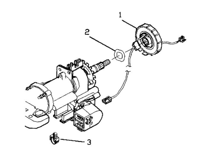

Okay, another possibility is the clock spring under the steering wheel.
https://www.2carpros.com/articles/symptoms-of-a-bad-airbag-clock-spring
https://www.2carpros.com/articles/steering-wheel-clock-spring-removal
I attached the procedure for removing the steering wheel and the clock spring.
https://www.2carpros.com/articles/steering-wheel-removal
REMOVAL PROCEDURE
TOOLS REQUIRED
J 23653-D Lock Plate Compressor
1. Disable the SIR. Refer to Disabling the SIR System.
2. Remove the steering wheel.
3. Remove the upper and lower shrouds.
4. Remove the wiring harness straps from the steering column wiring harness.
5. Remove all retaining rings.
6. Remove the inflatable restraint steering wheel module coil (1) from the steering shaft.
1. Install the inflatable restraint steering wheel module coil (1) to the steering shaft.
2. Install all retaining rings.
3. Install the wiring harness straps to the steering column wiring harness.
4. Install the upper and lower shrouds.
5. Install the steering wheel.
6. Enable the SIR. Refer to Enabling the SIR System.

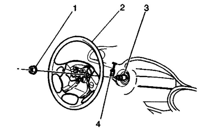

4. Remove the steering wheel nut (1).

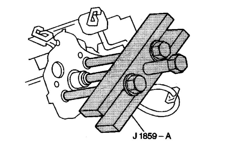

5. Remove the steering wheel using the J 1859-A.
6. Remove the steering wheel (2) from the steering column (3).
