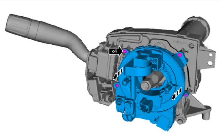

I am not sure what is going on here, Does the steering wheel have shift controls? The only thing going through the clock spring and airbag and any controls the steering wheel has. Do you plan to remove controls to try and make the paddle shifter work? They don't show the clock spring pin out by itself. They only show systems. To be clear this is the part you are talking about correct? Check out the images (below).
