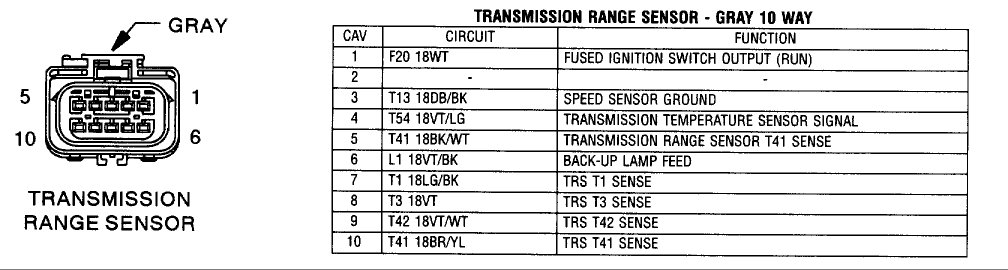

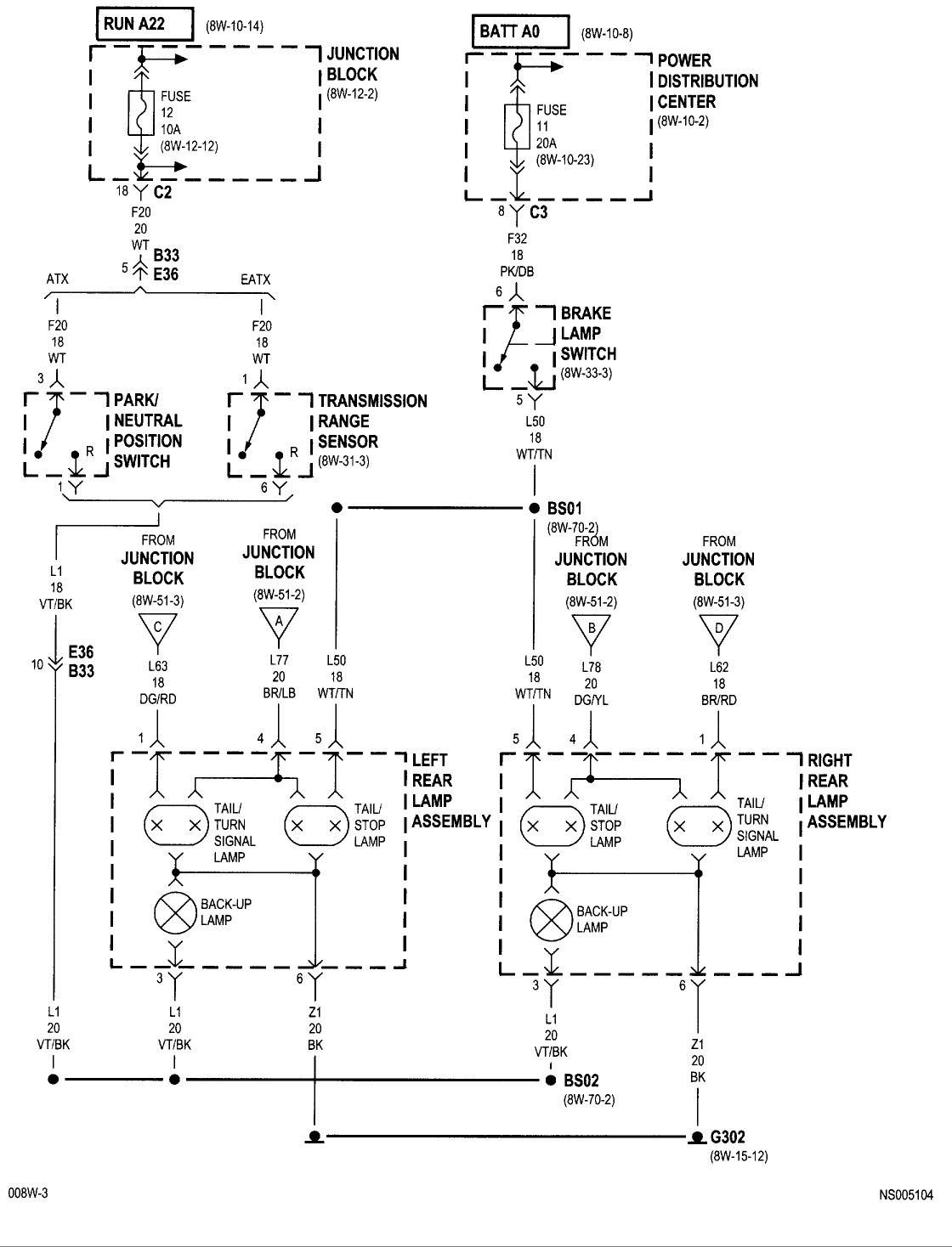

Check fuse #12 for power. Attached wiring diagram to reverse lights. Back probe pin #1 white whire and verify you have battery voltage with key on engine off. If fuse is good and no power at white wire then you have an open circuit on the wire. If ok block wheels and set parking brake. Put in reverse and back probe pin #6 Violet with black stripe wire. There should be battery voltage. If no voltage the transmission position switch is faulty. If you have battery voltage then at reverse light bulb socket verify you have battery voltage. If no voltage trace wire for an open circuit.
As for the noise at steering wheel. Double check your steering column covers are installed properly. If not then that will cause an issue. Also verify wiper switch and turn signal switch were installed properly as well if you had to remove those.
