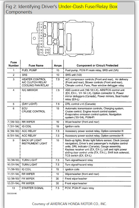

Hi, I change my clock light bulb in my van, after I change still no light comes on. What do I do to get if fixed? Help me please and thank you.
Sep 20, 2018 at 3:37 PM
CERTIFIED EXPERT
53,854 POSTS

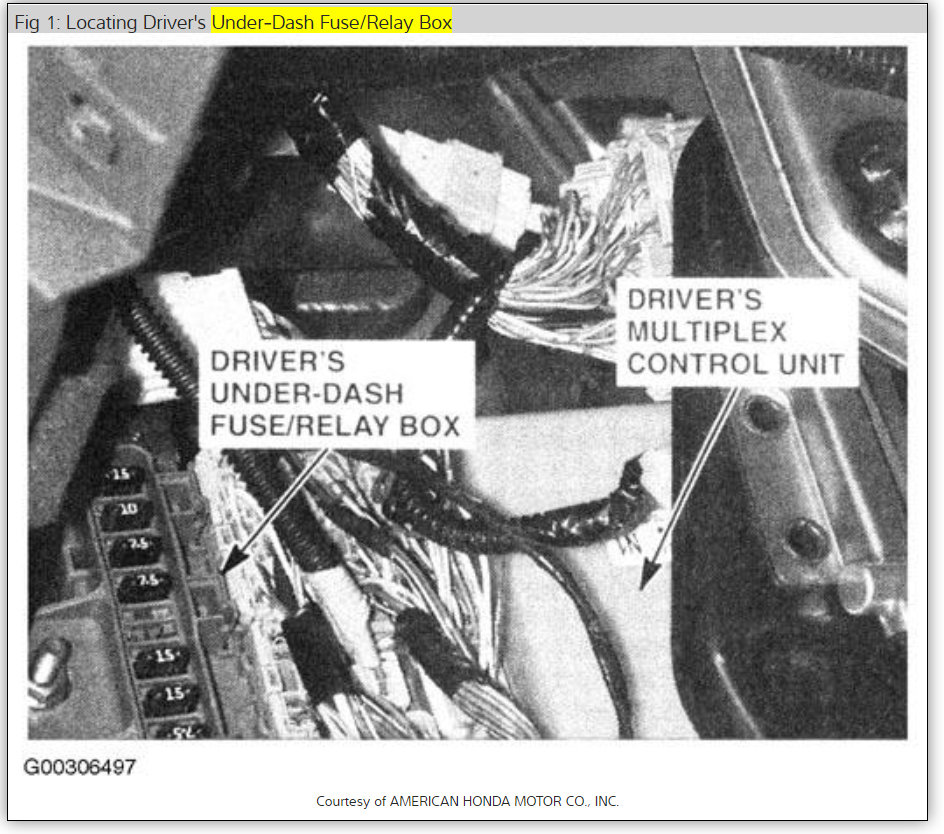

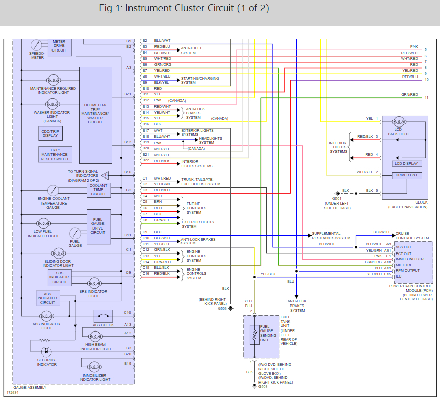

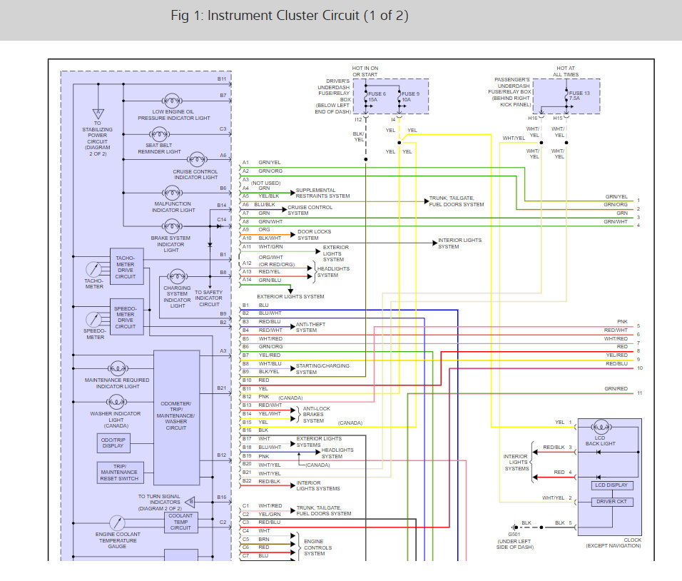

There is a fuse #9 that needs to be checked. Here is a guide to help you check the fuse and the locations of the fuse and wiring diagram for the clock so you can see who it works:
