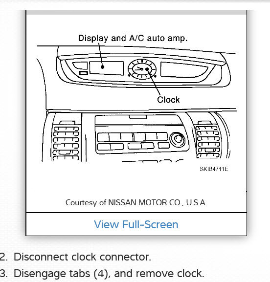

how to remove the dash trim panels to remove the clock

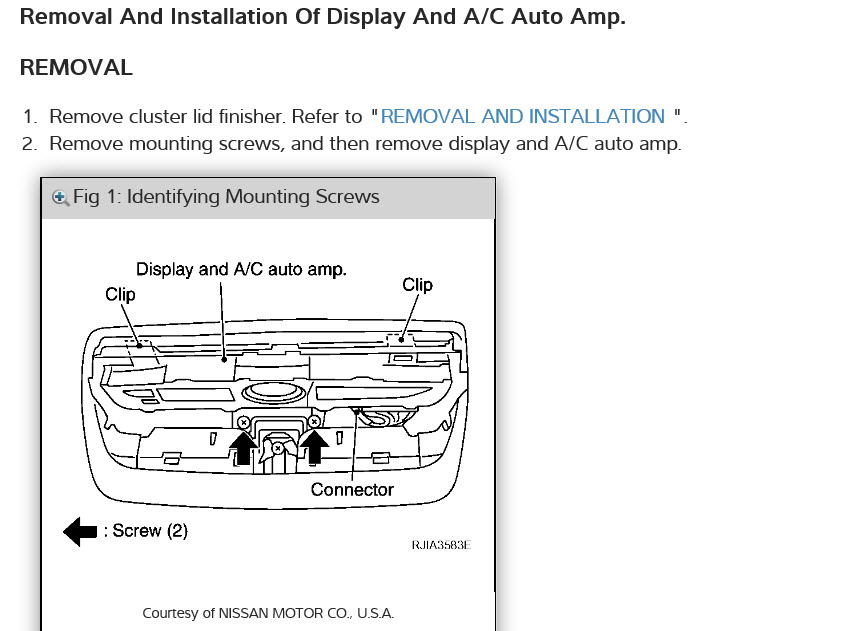

see pics I think ihave everything listed if not it's gonna be a lot more that I can't paste here
