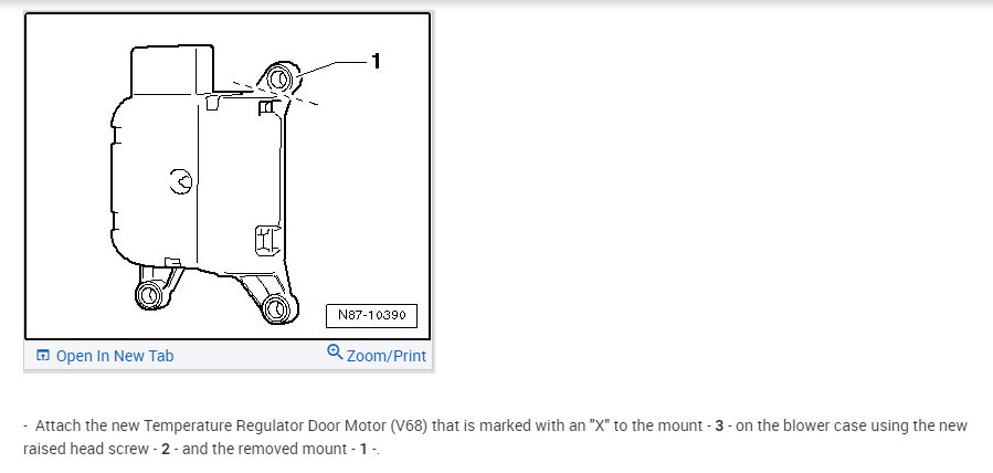

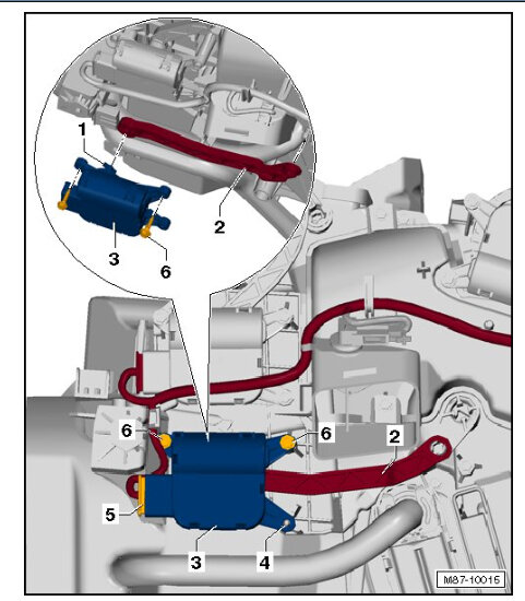

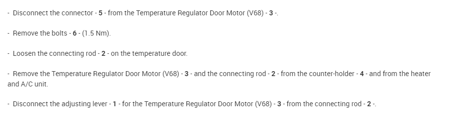

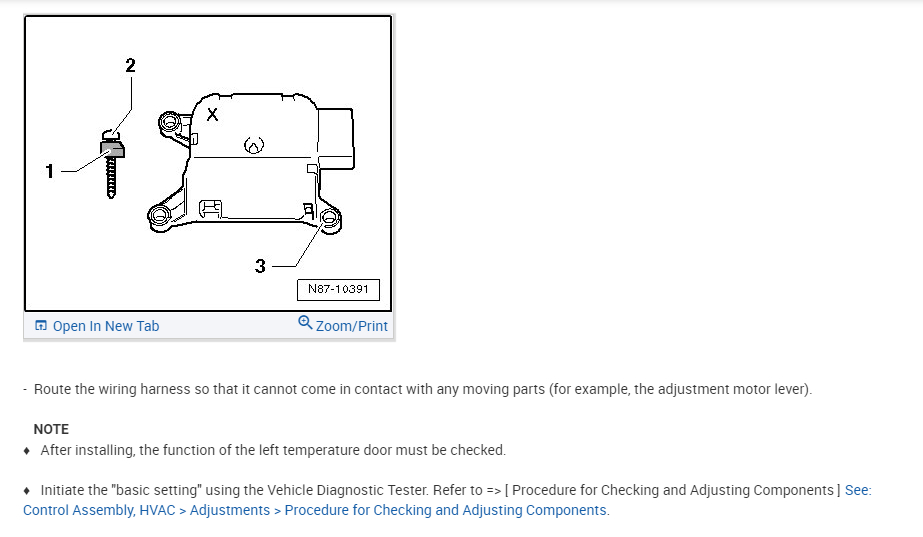

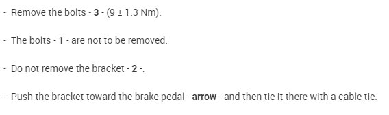

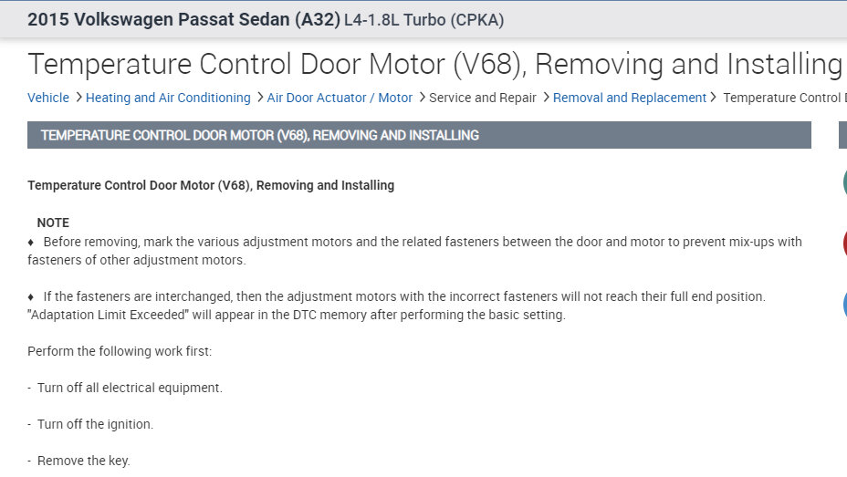

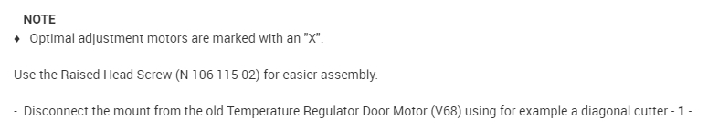

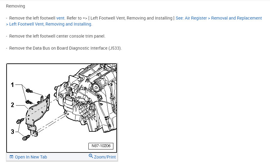

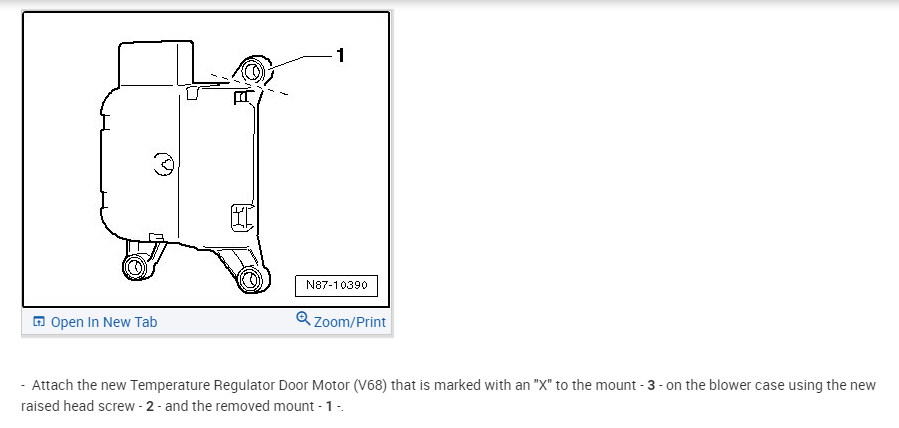

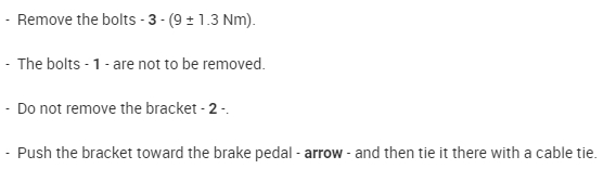

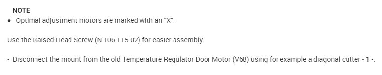

When you turn the A/C on, do you notice if the A/C compressor is actuating? If it is, then my first suspect would be a blend air door issue, especially if the air is always hot.
If the compressor does turn on, then the blend door is the first suspect. If you look below, I attached the directions for the removal and replacement of the actuator. Before purchasing one, remove the old one and see if it responds when you change the temp.
joe
see pics below.
