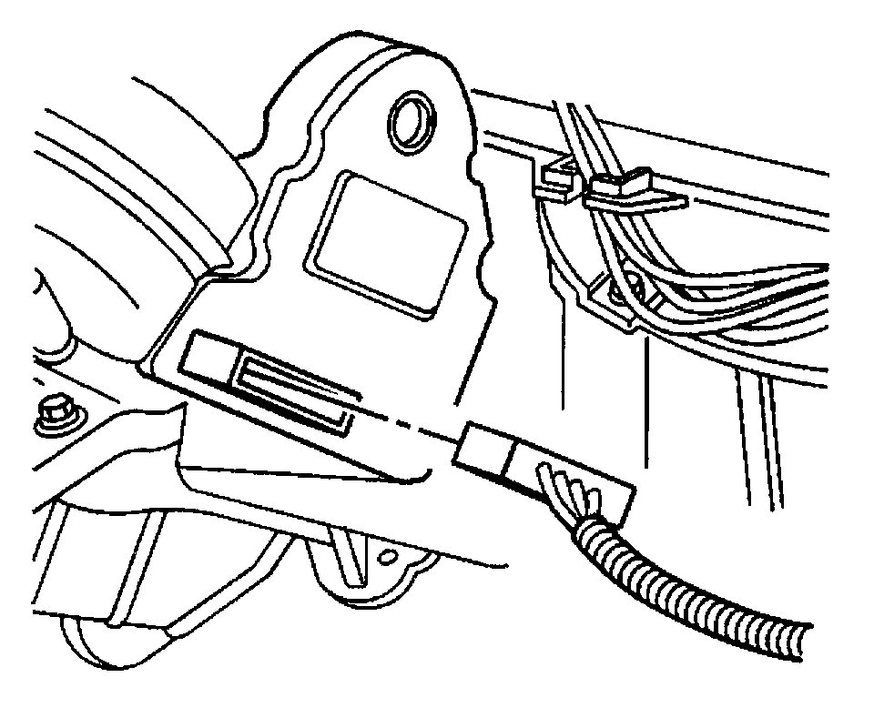

pic 1
1. Remove the right side instrument panel insulator.
2. Remove the instrument panel compartment.
3. Disconnect the electrical connector from the RH temperature valve electric actuator.

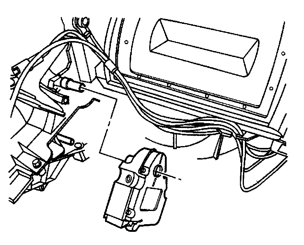

pic 2
4. Remove the screws retaining the RH temperature valve electric actuator.
5. Remove the electric actuator.
